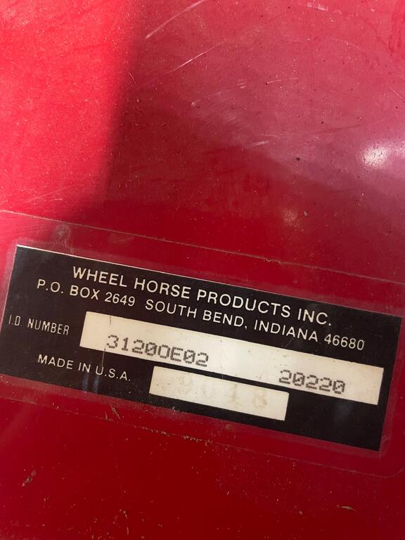

Handy Don 17,450 #26 Posted May 24, 2024 (edited) 27 minutes ago, Mister_520H said: So mine is either an 88 or an 89. Would I be able to search specifically based on the serial number? The model number is the key. It’s on a sticker on the fender to the left of the seat. Yes, good plan to use any usable parts from your tractor and only replace the broken/damaged bits. There are four connections to the hydraulic control valve: in from the pump and out to the filter at the rear (either or both can be metal or hose), and the out and back for the cylinder (always hoses). Pictures of the oily things? @Ed Kennell makes an excellent point--you seem to have the benefit of the swept axle added to an earlier model. It’d be nice if you can get a picture of the underside that shows the steering shaft connection from the front tie rods back to the bottom of the fan gear, please. Just to sate our incessant interest in pictures! Edited May 24, 2024 by Handy Don Share this post Link to post Share on other sites

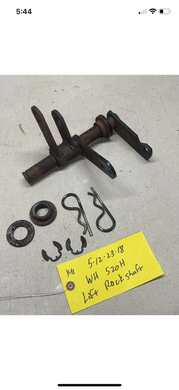

Bill D 3,137 #27 Posted May 24, 2024 5 hours ago, Mister_520H said: Okay so that wasn’t too bad. Get the lift shaft removed from the main shaft was a bit of a puzzler for a few minutes but after thinking it over, I was able to tap it off with a long punch. So in looking at some photos of others online, mine appears different on that it does two internal arms whereas the photos I’ve found online show three. Any explanation for this difference? First photo shows mine, second from eBay. What are the other arms for? What did you use for penetrating oil? That shaft is near impossible to get apart. Share this post Link to post Share on other sites
Mister_520H 58 #28 Posted May 24, 2024 Hey Bill, It sounds like maybe I just got lucky. I didn’t use any penetrating oil. Being my first go round I didn’t know enough to think this was going to be a pain in the butt. Once I pivoted the shaft forward to allow my long punch to impact the remaining arm it just took 10-12 taps to fully reveal the key and then it just slid off. I initially tried to just pull it off with my bare hands. Haha. It sounds like sometimes they get rusty but thankfully mine was not. Perhaps the benefit of a minor leak in the hydro lines. Share this post Link to post Share on other sites

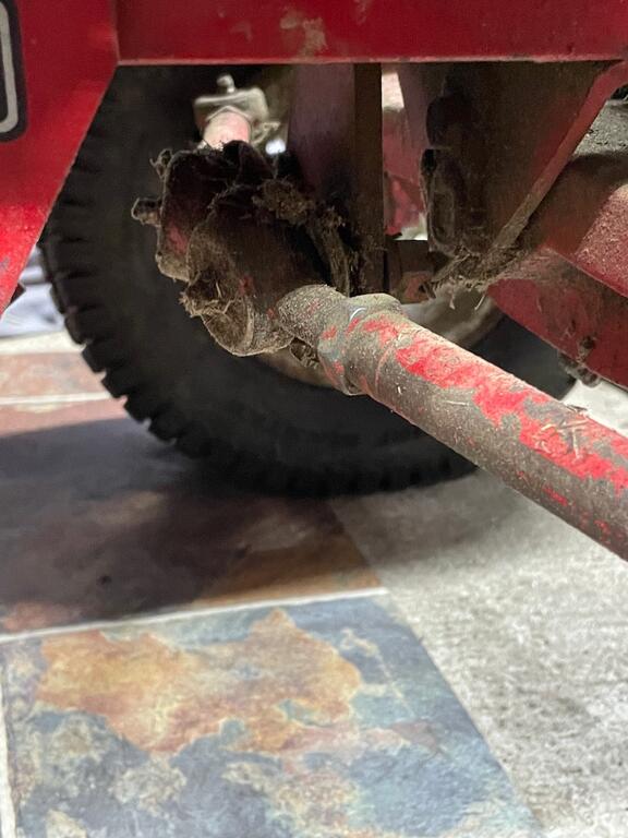

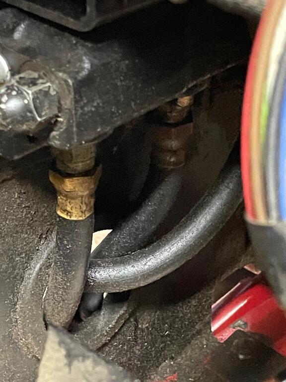

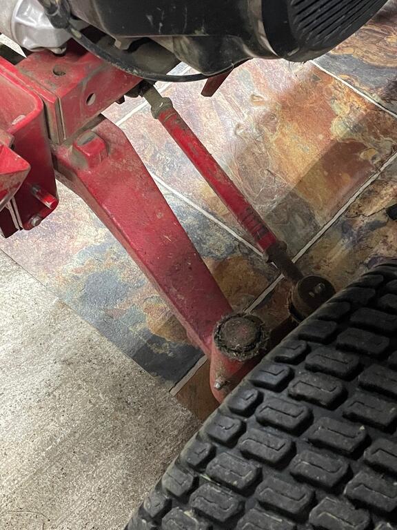

Mister_520H 58 #29 Posted May 24, 2024 Handy Don, Here’s a few photos though I’m not sure I’ve captured the angle you’re looking for. 1. Model # 2. Front tie rods from right side 3. Rear swept axle 4. Source of oil leak Share this post Link to post Share on other sites

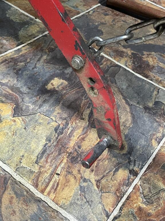

Mister_520H 58 #30 Posted May 24, 2024 16 hours ago, gwest_ca said: The lift page in the illustrated parts lists for you tractor shows what holes are used for the various attachments https://www.partstree.com/models/41-20oe01-520-h-toro-garden-tractor-1990/hydrostatic-lift-linkage-19/ After going over this thoroughly I see I had made an error in my previous installation. I see that by installing the trunnion in the 1st position (furthest from shaft) on the arm I unintentionally placed the maximum leverage against the arm weld. So that explains the failure. 1 hour ago, Ed Kennell said: 88 model # 31-200E01 89 is 31-200E02 Both had straight front axles and the front tires would not clear the 60" deck. The PO must have switched to the forward swept axle to be able to run the 60". So according to my serial number, my tractor is in fact a 1989. 2 Share this post Link to post Share on other sites
Ed Kennell 47,237 #31 Posted May 24, 2024 7 hours ago, Mister_520H said: Here’s a few photos though I’m not sure I’ve captured the angle you’re looking for. I think Don was asking if your tractor also had the reduction steering system installed along with the forward swept axle. A picture of the steering box at the junction of the horizontal and vertical steering shafts would show that. '89s did not come with the forward axle or the reduction steering. 2 Share this post Link to post Share on other sites

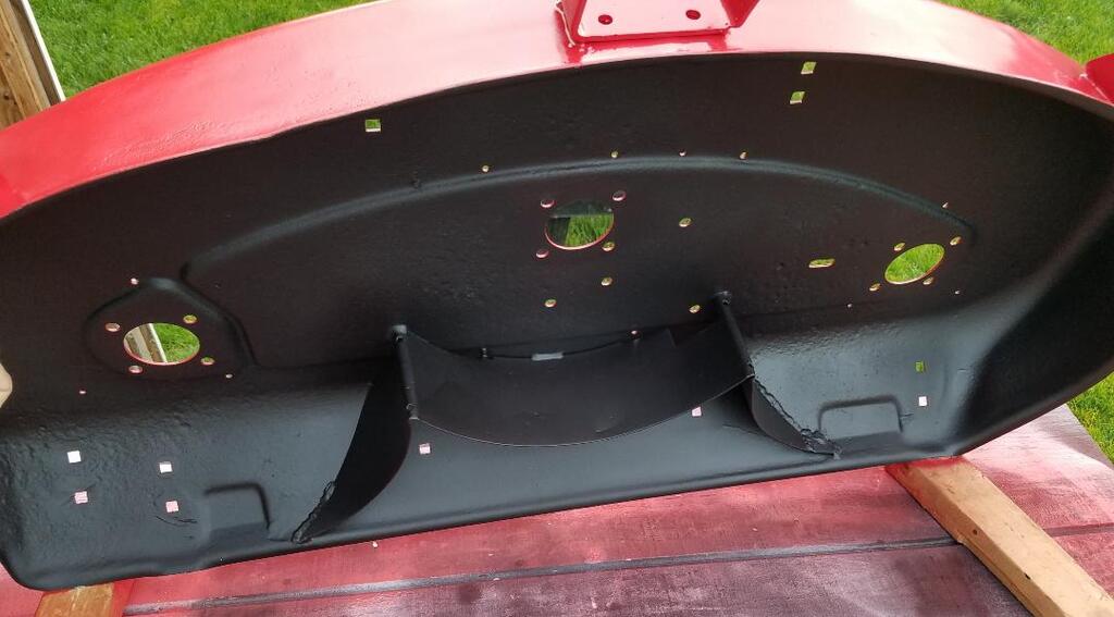

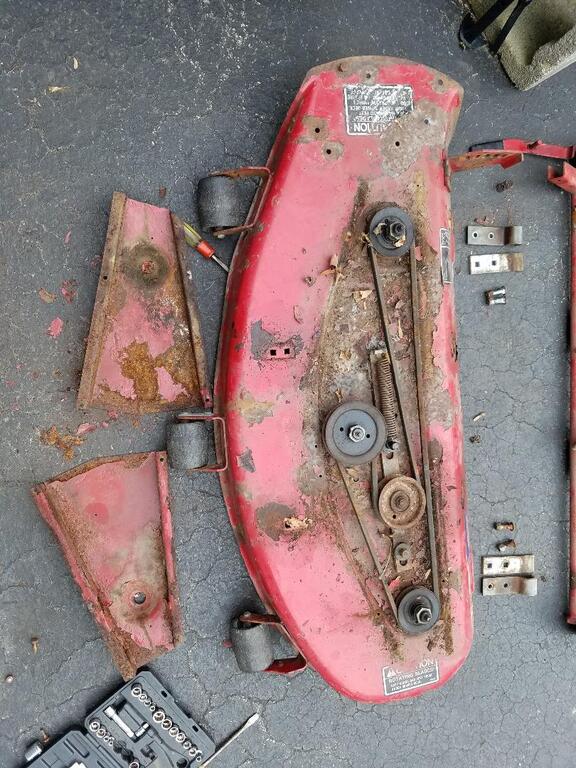

Mister_520H 58 #32 Posted May 24, 2024 17 hours ago, mrc said: looks like you are running the 60 inch deck. which is quite heavy compared to any other wh deck. those 60 inchers have been known to wear out the mid tach-a-matic and/or crack the frame near where the mid tach-a-matic is. might want to look that over as well. the rear deck wheels are 6 inch. i installed 8 inch rear deck wheels and get a much higher cut, 4 inches. regards mike Hey Mike, 8” rear wheels sounds like an intelligent solution. Did you just source a standard set at Tractor Supply or do they need to be specific to the deck? Thanks! Share this post Link to post Share on other sites
peter lena 10,046 #33 Posted May 24, 2024 @Mister_520H nice write up ! good insight into your situation , have always cut at highest setting , first thing I thinks about is DECK DISCHARGE , the more thats get out , the less trapped buildup , also like larger rear deck wheels . also that lift lever should have a detailed lubricant , like red aerosol / paste grease , verify as you go , that would also be a severe drag / brake movement point ,like lucas green x hd green chassis grease , on movement hi stress areas , incredible difference on deck spindles / mule drive / related . might get some vinyl caps for your front axel top area , helps retain lubrication . sheds debris . you might also make up a solid lift / drag point , with heavy lift straps , shackles / open hooks , hand ratchet chain lift , make the deck much easier to move around , would also plan on a regular , break the grunge cycle , underside look see , might even get the underside , some , SUN TIME HOT ? lubrication soak down , kills / stops rust / grunge . enhance every movement area , lube , washer up sloppy points , you can do that , pete Share this post Link to post Share on other sites
Mister_520H 58 #34 Posted May 24, 2024 2 hours ago, Ed Kennell said: I think Don was asking if your tractor also had the reduction steering system installed along with the forward swept axle. A picture of the steering box at the junction of the horizontal and vertical steering shafts would show that. '89s did not come with the forward axle or the reduction steering. Ah okay. Will follow up shortly with additional photos. Got some garage time here today to continue cleaning and assessing any additional issues. Would like to resolve the hydro leaks before the new lift arm assembly arrives. 28 minutes ago, peter lena said: @Mister_520H nice write up ! good insight into your situation , have always cut at highest setting , first thing I thinks about is DECK DISCHARGE , the more thats get out , the less trapped buildup , also like larger rear deck wheels . also that lift lever should have a detailed lubricant , like red aerosol / paste grease , verify as you go , that would also be a severe drag / brake movement point ,like lucas green x hd green chassis grease , on movement hi stress areas , incredible difference on deck spindles / mule drive / related . might get some vinyl caps for your front axel top area , helps retain lubrication . sheds debris . you might also make up a solid lift / drag point , with heavy lift straps , shackles / open hooks , hand ratchet chain lift , make the deck much easier to move around , would also plan on a regular , break the grunge cycle , underside look see , might even get the underside , some , SUN TIME HOT ? lubrication soak down , kills / stops rust / grunge . enhance every movement area , lube , washer up sloppy points , you can do that , pete I have (2) 60” decks and am currently running a later model with the anti scalp rollers. The tractor came to me with the older style sans rollers and due to my uneven terrain, the deck would frequently scalp and chew up the turf. My lawn is far from better homes and gardens but it bugged me all the same so when I saw the newer version of the 60” available locally, I grabbed it. First thing I did was scrub the underbelly clean with a wire brush and give it a fresh coat of farm implement red paint. It looked brand new but the paint didn’t last much more than a season. Next time (probably this fall) I’ll do it again and this time use a primer first. Rookie mistake? As for discharge, neither of my decks have ever had the chute and seem to discharge well. But the exit on my newer deck is somewhat reduced as the front and rear edges are bent inward from years of impacts and I’d guess this reduces discharge flow. I’ll correct this next time I get the deck flipped, perhaps today. I do keep the spindles packed with grease, a red variety from tractor supply and also keep all the zircs fed on a regular basis. I like the idea of some caps as they do collect debris quickly. Share this post Link to post Share on other sites

Handy Don 17,450 #37 Posted May 24, 2024 (edited) 11 hours ago, Mister_520H said: This image doesn’t reveal any significant leakage that I can spot. My experience with those 35yo swivel-end hose connections is mixed--some have held up while others weep a bit at the swivel. While you have it open, if you are of a mind to replace one or more hoses, I’d check with Wheel Horse Parts and More and K&B. Both of them are supporter member/vendors. And yes, I’m curious about the reduction steering. A quick check is the number of turns of the steering wheel lock-to-lock. One full turn = standard steering; two full turns = reduction. Edited May 24, 2024 by Handy Don 1 Share this post Link to post Share on other sites

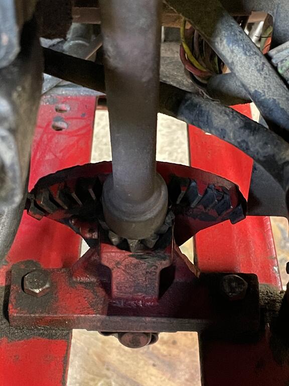

Mister_520H 58 #38 Posted May 24, 2024 Here’s the steering photo. So is this original or updated to the reducer? Share this post Link to post Share on other sites

Handy Don 17,450 #41 Posted May 24, 2024 Standard steering. Neglecting that zerk on the steering block is a big cause of steering looseness, so a good plan to get after it. BTW, there are shims on the longitudinal steering shaft that can be moved to either side of the steering block to adjust the engagement of the gears. Share this post Link to post Share on other sites
Handy Don 17,450 #42 Posted May 24, 2024 1 minute ago, Mister_520H said: So if that lift shaft is usually impossible to remove, how are you guys getting the assembly out of the tractor? Now I’m curious. Seems like you’d have to tear that whole section down otherwise. Fun! Generally, that gets left in even in significant renovations! I got one out of a ruined tractor by cutting the sides of the tunnel. Then used a press to get the shaft out of the arm sleeve after soaking it in penetrant for more than a month. Share this post Link to post Share on other sites
Mister_520H 58 #43 Posted May 24, 2024 5 minutes ago, Handy Don said: Generally, that gets left in even in significant renovations! I got one out of a ruined tractor by cutting the sides of the tunnel. Then used a press to get the shaft out of the arm sleeve after soaking it in penetrant for more than a month. Wow! Well I’m feeling extra fortunate in light of that information. Looking forward to installing the lift arm and will follow the advice of sandwiching the chain with a clevis as this sounds significantly stronger than using a single mounting point. My only question is regarding the holes. In the photos the opposing hole looks of a large diameter so it may require a sleeve to reduce to match the diameter of the smaller hole. 10 minutes ago, Handy Don said: Standard steering. Neglecting that zerk on the steering block is a big cause of steering looseness, so a good plan to get after it. BTW, there are shims on the longitudinal steering shaft that can be moved to either side of the steering block to adjust the engagement of the gears. Steering feels pretty solid to me but now I’m curious if I should hunt for a reducer. Significant improvement? Photo below shows my rear deck attachment lift arm and I’m curious about the chain attachment. Photos from the pdf above look to show only 2 holes but mine clearly has three with the chain attached at the uppermost hole. Was one hole added or was this an earlier design? Share this post Link to post Share on other sites
Handy Don 17,450 #44 Posted May 24, 2024 50 minutes ago, Mister_520H said: hunt for a reducer. Significant improvement? The reduction was one of the last big improvements on the 520 models--it started on the commercial (520-HC) units and then became standard. It basically improves the leverage with more turning of the steering wheel to get the same turn on the front wheels. I think the biggest benefit is when the front is heavy--i.e. a lifted front-end loader or two-stage snowblower. We have this on the camp tractor and my small-statured DIL and granddaughter like it a lot because of the lessened effort to steer and they don’t care about the loss of “nimbleness." 58 minutes ago, Mister_520H said: My only question is regarding the holes. In the photos the opposing hole looks of a large diameter so it may require a sleeve to reduce to match the diameter of the smaller hole. I’ve held only one of these and the holes were the same size and aligned on the two parallel arms. Let us know! The “one side” attachment of the chain is ok because it’s bolted snug. 1 hour ago, Mister_520H said: A couple of things jump out here. First, yes, there is an extra hole and the chain is attached to it! The effect is to somewhat increase the range of the lift (both higher and lower!) and somewhat reduce the lift weight capacity. Definitely a planned PO mod. Second, the pin at the end of that lever is showing significant wear. Do you have the capability of doing a weld build up and then grinding it round again? Share this post Link to post Share on other sites

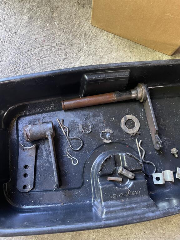

Brockport Bill 2,470 #45 Posted May 24, 2024 1 hour ago, Mister_520H said: Ah okay. Will follow up shortly with additional photos. Got some garage time here today to continue cleaning and assessing any additional issues. Would like to resolve the hydro leaks before the new lift arm assembly arrives. I have (2) 60” decks and am currently running a later model with the anti scalp rollers. The tractor came to me with the older style sans rollers and due to my uneven terrain, the deck would frequently scalp and chew up the turf. My lawn is far from better homes and gardens but it bugged me all the same so when I saw the newer version of the 60” available locally, I grabbed it. First thing I did was scrub the underbelly clean with a wire brush and give it a fresh coat of farm implement red paint. It looked brand new but the paint didn’t last much more than a season. Next time (probably this fall) I’ll do it again and this time use a primer first. Rookie mistake? As for discharge, neither of my decks have ever had the chute and seem to discharge well. But the exit on my newer deck is somewhat reduced as the front and rear edges are bent inward from years of impacts and I’d guess this reduces discharge flow. I’ll correct this next time I get the deck flipped, perhaps today. I do keep the spindles packed with grease, a red variety from tractor supply and also keep all the zircs fed on a regular basis. I like the idea of some caps as they do collect debris quickly. re: you using wire wheel and painting underneath deck??????????? I have rehabbed a handful of decks over past couple of years that were in bad condition ... some of which were seriously rusted and corrosion pitted underneath -- so rather than all the labor of hand tools or wire brushes, grinders etc, I took a few decks to professional sand blaster - terrific job and removes every spec of corrosion, especially deep into the pitting which is so hard to remove manually -- and for the cost it certainly offset the messy labor. Then i would use multi coat primer and top coat -- of course there are different strategies and opinions what works best including some using pick up truck bed sealer etc -- so that's a matter of preference - - my only suggestion is whatever your strategy is to seal the deck is to first consider the sand blasting for getting it clean. Good luck 1 Share this post Link to post Share on other sites
Handy Don 17,450 #46 Posted May 24, 2024 8 minutes ago, Handy Don said: I’ve held only one of these and the holes were the same size and aligned on the two parallel arms. Let us know! I went and dug up more images of this part and I can see that the holes are different sizes. I’m thinking now that the one I worked on must have had the spacer you mentioned or else a shouldered clevis pin. Share this post Link to post Share on other sites

Handy Don 17,450 #48 Posted May 25, 2024 21 minutes ago, Mister_520H said: turn it back down to size due to the shape of the lift arm. If your skills are up to it, you could remove that pin and replace it with a new piece of rod. Probably less work than my original suggestion! WH tended to weld these types of things on only the “back” side of the bar so with care, you could get that piece off and put in a new one! Share this post Link to post Share on other sites
