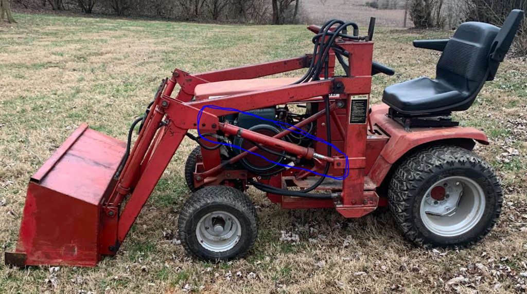

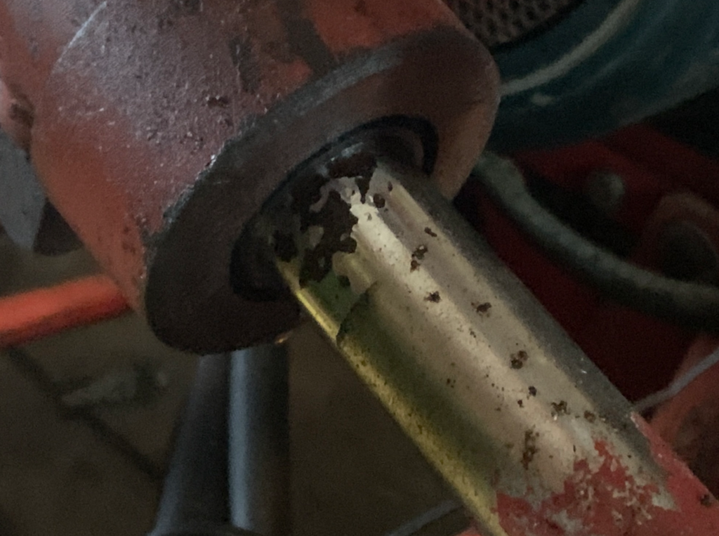

wh5208speed 645 #1 Posted May 14, 2024 Picked up this nice Ark loader in January for my C-161 in January. It had sat in a garage unused for a long period and the little bit of the cylinders that was exposed & pitted pretty bad. Was surprised that it didn't leak when it was installed, but eventually it messed up the O-ring and it's developed a pretty serious oil leak on the left side. The other side has the same pitting....so it will be a matter of time until it needs addressed as well. Would it make more sense to have a hydraulic shop replace the rods or would it be more economical to replace the whole cylinder? Does anyone know of a place to buy replacement cylinders? 1 Share this post Link to post Share on other sites
WHX?? 50,730 #2 Posted May 14, 2024 I would replace the whole cylinder. By the time your done with parts and labor it makes better sense. Northern tool and Surplus Center have fine choices for replacements. 4 Share this post Link to post Share on other sites

953 nut 57,904 #5 Posted May 14, 2024 With the rust spots on that shaft it will need to be replaced or polished and plated. Buy a new pair and call it a day. 1 Share this post Link to post Share on other sites
