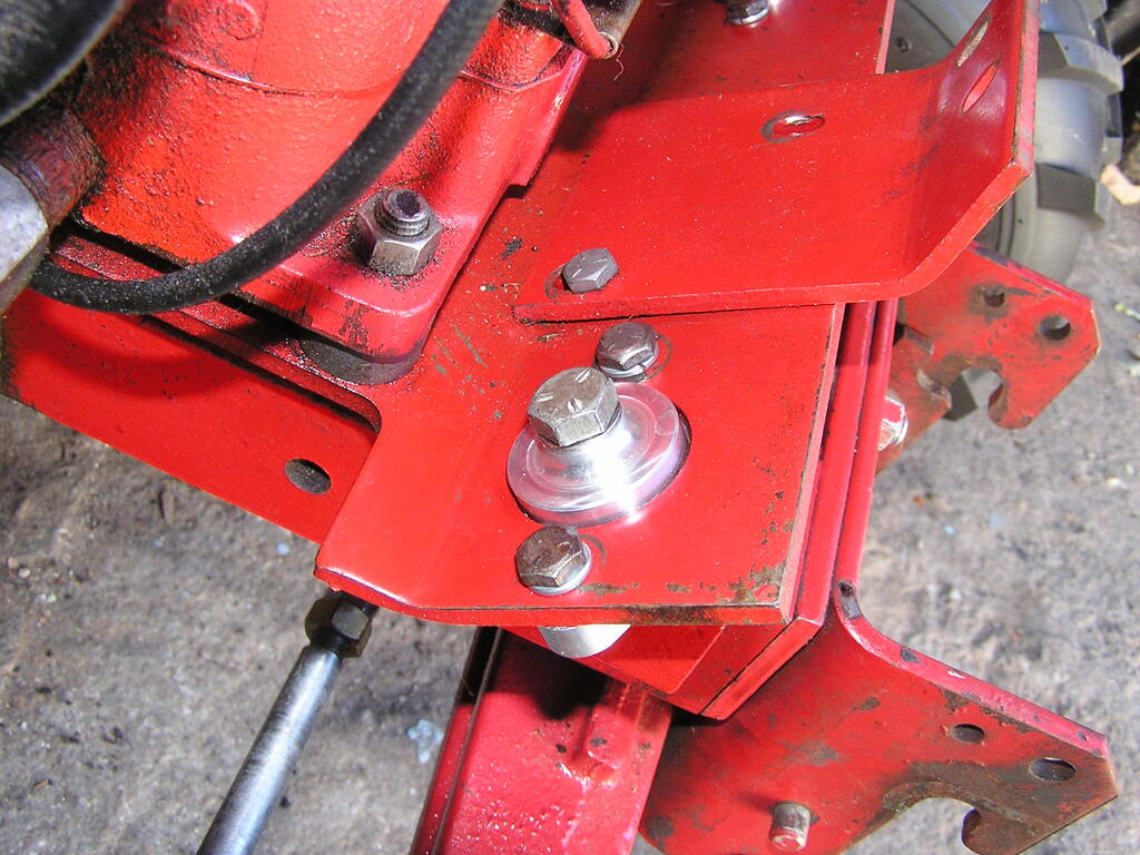

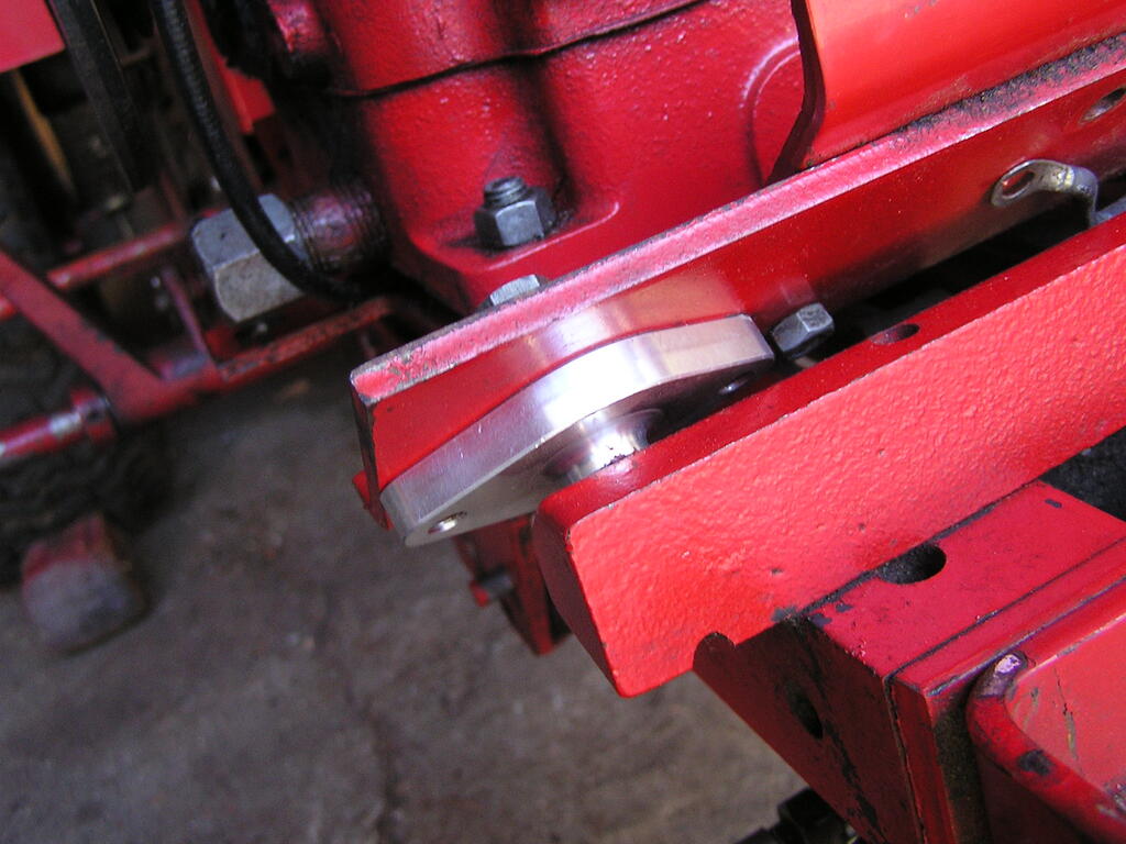

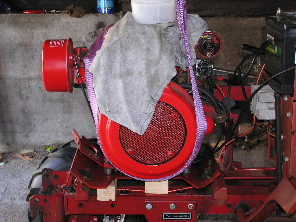

ri702bill 8,316 #4 Posted May 13 (edited) And they work just fine.... loosen the rear triangular block on the frame to allow installation... Edited May 13 by ri702bill 4 Share this post Link to post Share on other sites

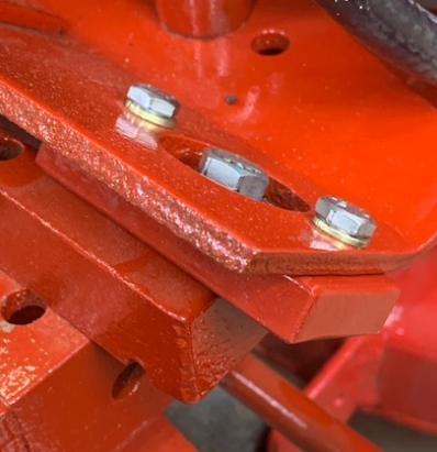

JoeM 7,873 #8 Posted May 13 A budget friendly set can be made from 1/2 bar stock. 2 2 Share this post Link to post Share on other sites

ri702bill 8,316 #11 Posted May 13 John - my C81 is 45 years old, the rubber isloator portion of all 4 mounts was badly deteriorated, That allowed a lot of engine shake and the engine would visibly shift with the PTO engaged. Not anymore... 2 Share this post Link to post Share on other sites
Retired Wrencher 5,450 #12 Posted May 13 5 hours ago, JoeM said: A budget friendly set can be made from 1/2 bar stock. Joe I like that set up big washer in the center 3/8” bolt tap it in to the plate. I have some flat rubber 1/4” think might help with vibration? Share this post Link to post Share on other sites
ri702bill 8,316 #13 Posted May 13 Hmmm... the idea is to go Solid - no rubber. (It works....) 1 Share this post Link to post Share on other sites
ebinmaine 67,421 #14 Posted May 13 4 hours ago, Retired Wrencher said: Joe I like that set up big washer in the center 3/8” bolt tap it in to the plate. I have some flat rubber 1/4” think might help with vibration? Go steel Gary. All solid. Keep the rubber right out. You'll be happy you did. 🙂 7 hours ago, Fordiesel69 said: hops around like a pregnant rabbit. Seems to me that's a fair amount of hops!! 1 2 Share this post Link to post Share on other sites
