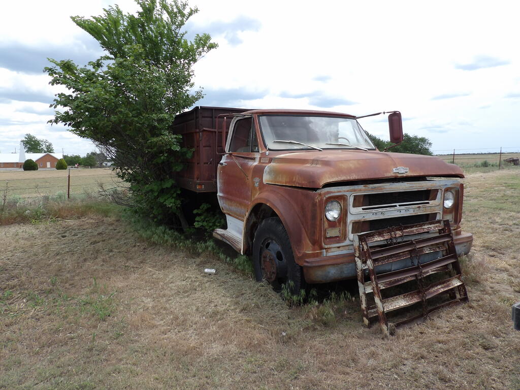

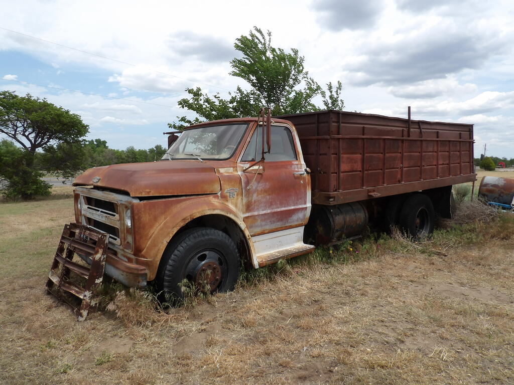

Last week at work I was talking with our part time secretary and she asked me if I would help her this weekend with moving an old truck out of her yard. The old truck she is wanting out of there just so happens to belong to my grandfather (he and her father in law have been farming partners for years). So I told her I would talk to him and see what he wanted to do with it. Talked to him after work and he told me to take it and do with it whatever I wanted to. The truck in question is a 1971 Chevy C50 grain truck. It was last tagged in 1996, and it's been at least 15 years since the truck has ran and was parked.
Spent the better part of the day yesterday trying to get it to run, with no luck. I can get it to turn over about a half revolution and stop, pulled the starter and turned it backwards about a half revolution and it stops again. My first thought was a stuck valve, so I pulled the valve covers and all the valves move as they should. But just to eliminate the possibility I completely backed off every rocker arm and turned the engine over with the same results, my next thought is probably some rust in a cylinder not allowing the rings to move past it. The spark plug that came out of the number 6 cylinder did have some rust on the end of it. I've got the cylinders full of Marvel Mystery Oil now letting them soak so we will see what happens in a few days.
Now for the question of what do we do with it. We don't really have a use for a grain truck around our place, but we do have a lot of downed trees and brush that needs cleaned up around the farm, thought about removing the end gate and using it for hauling brush and trash to the burn pit, provided we can get it running. The truck is sitting on 9.00-20 tires (which are almost impossible to find) on the old split rims that no one in the area will touch anymore, and both outside duals need replaced. That got me to doing some research into converting it over to modern 22.5s, those wheels are right around $350 a piece, so I'm looking at $2100 just in new wheels and then anywhere from $3-500 a piece for new 22.5 tires. In the process of researching this I ended up on YouTube and went down that famous rabbit hole that we should never go down. I saw a few projects where people had swapped the C50 cab onto a C30 chassis. That got me to thinking I have an old 79 K20 sitting in the pasture with a blown engine, how cool would it be to graft the 71 C50 cab onto the K20 4x4 chassis, custom built flatbed, and drop a big block and 5 speed in.
Please someone tell me I've lost the few marbles I had left :laughing-rolling:
Here is the truck

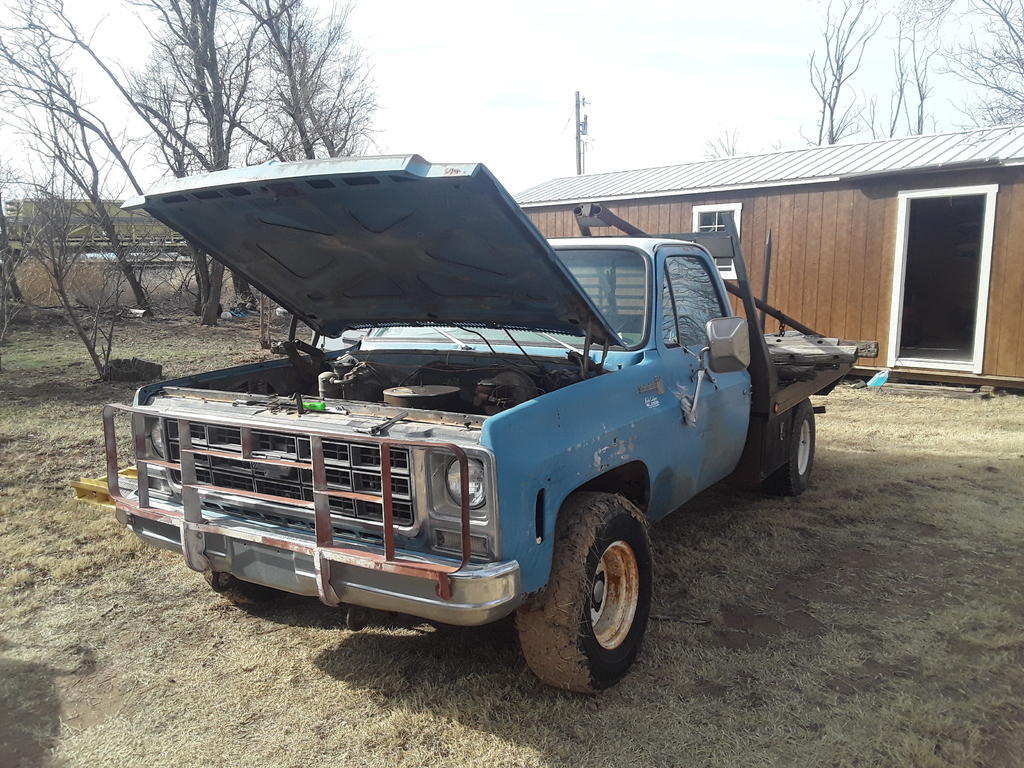

And here is the old junker that would donate her frame to this crazy idea I have brewing in my head

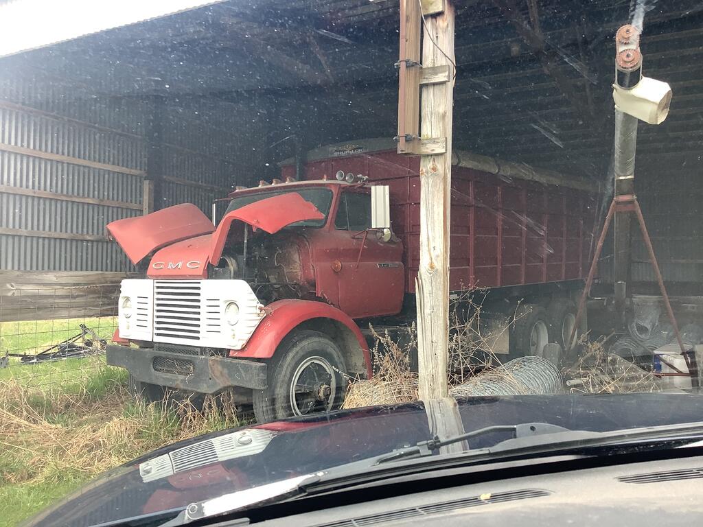

Very similar, I have/had (I haven’t checked on it in a while) open offer to come take this ‘64 GMC 6000.  It’s got a 671 Detroit Diesel and twin stick transmission with the hi/low rear end if I recall.  The grain box is a dumper and when my buddy bought the farm 3 or 4 years back he drove it to it’s current resting place.
  • Heart 1
That 79 cab looks like it would bring good money.
