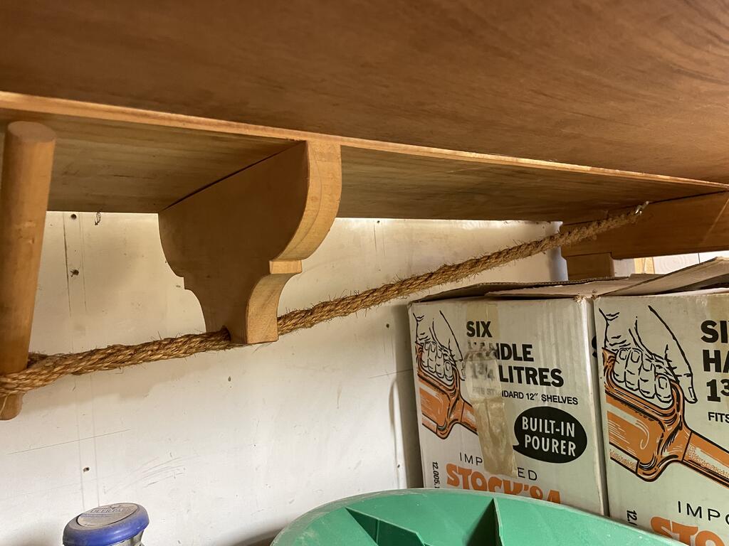

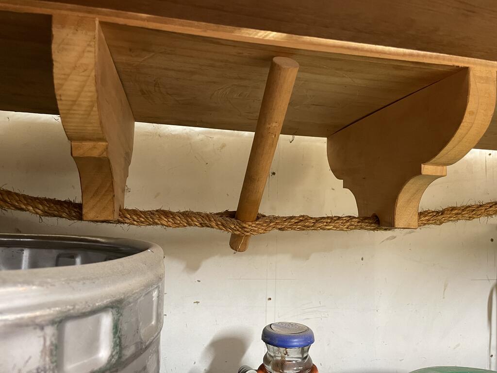

ebinmaine 70,741 #23 Posted May 13, 2024 3 hours ago, formariz said: There are many things one can do to make it work even with a 3/4” shelf some of which were already mentioned. Laugh if you want but the photos below is what I always resort to, and in over 40 years I have never had a single failure. I have literally built bridges in this manner I like that idea quite a lot. My latest intention was to build the shelves then add a piece of vertical small chain or cable to the midspan of the shelves which would be attached at the ceiling rafters. The only (but serious) disadvantage to using the rope/wire under suspension is a lack of space between shelves. I'll have to ponder and measure some more. Share this post Link to post Share on other sites
formariz 11,994 #24 Posted May 13, 2024 5 minutes ago, ebinmaine said: The only (but serious) disadvantage to using the rope/wire under suspension is a lack of space between shelves. I'll have to ponder and measure some more. True if in fact there are other shelves underneath. For that instead of the shown method, same can be accomplished with 1/4” threaded rod and a turnbuckle in center. (By the way I used that system to straighten large massive pocket doors that were twisted and were only visible on one side. Rods were mounted diagonally along twisted corners. Some of them were 10’ tall by 6’ wide.) That way it stays close to the underside of shelf and has same effect. You only lose the wow factor from the visitors. With the rod from ceiling it should go through all shelves using nuts under each shelf so you can individually adjust the crown on each one without affecting the others. 1 1 Share this post Link to post Share on other sites
ebinmaine 70,741 #25 Posted May 13, 2024 50 minutes ago, formariz said: same can be accomplished with 1/4” threaded rod and a turnbuckle in center How do you attach at the ends? Share this post Link to post Share on other sites
