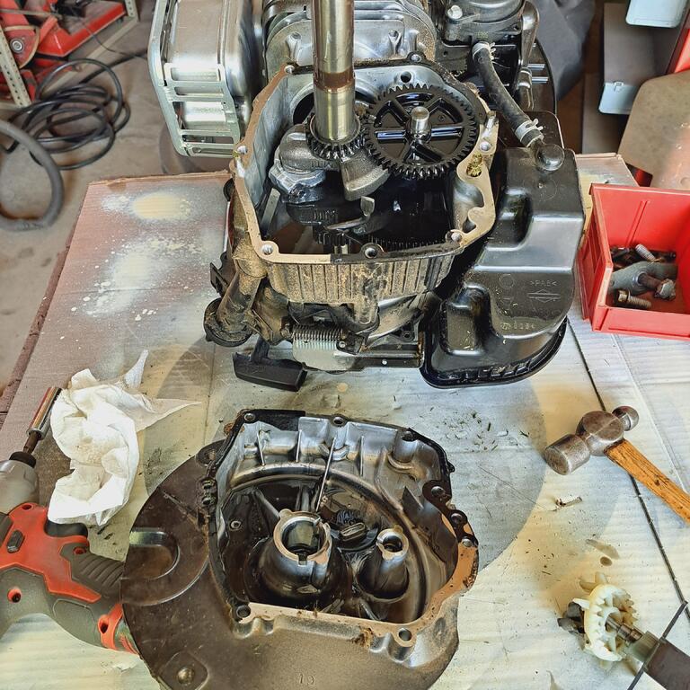

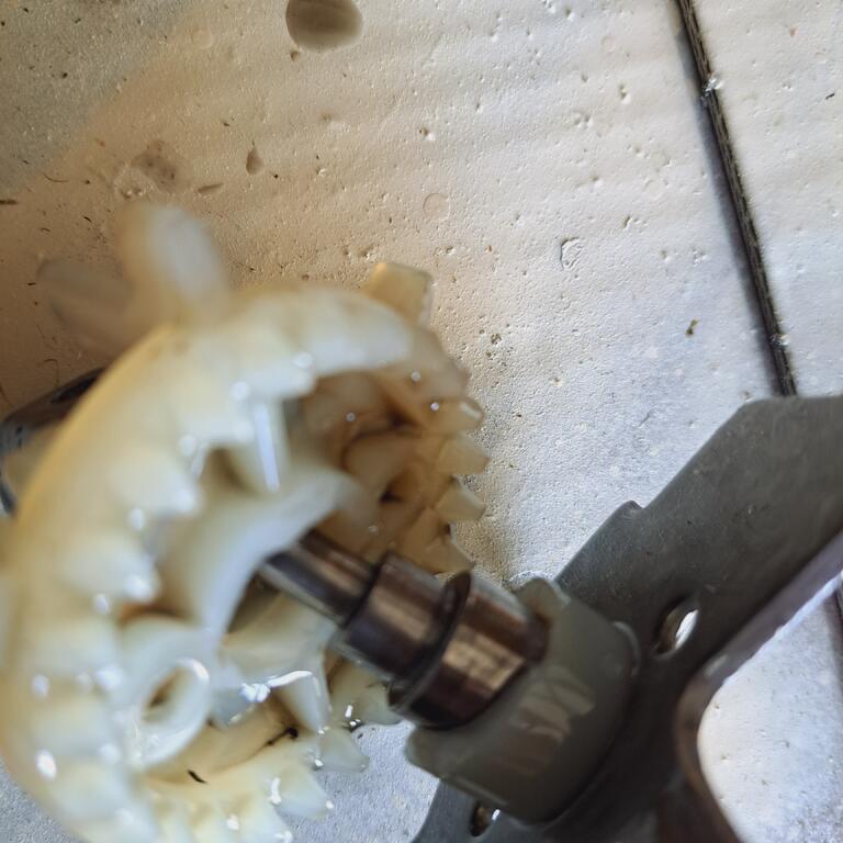

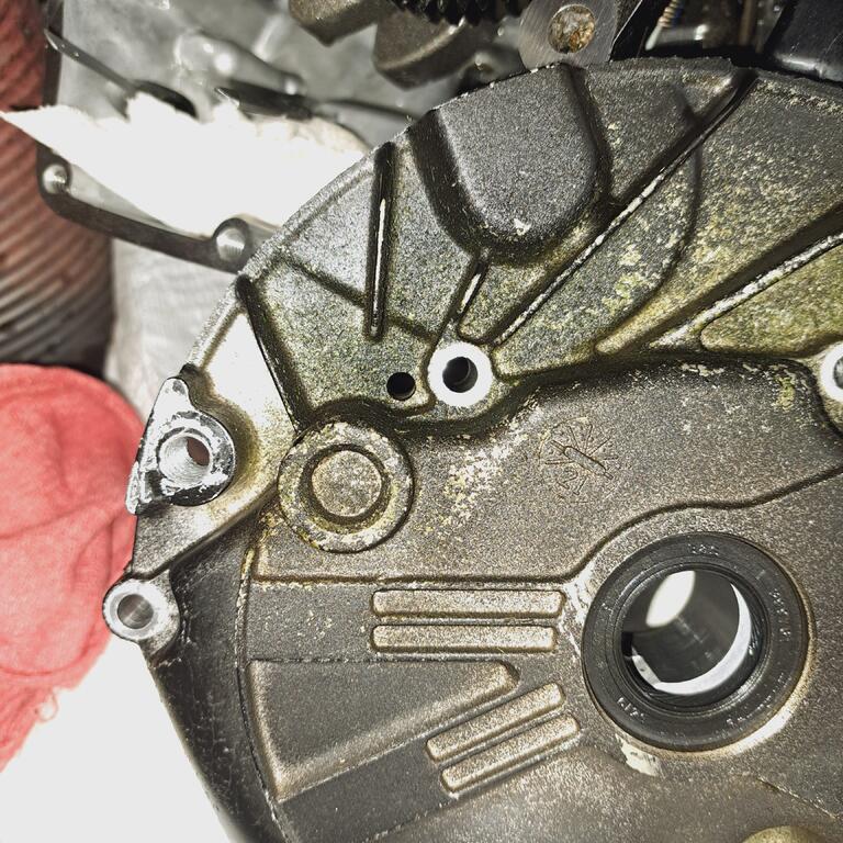

WHX?? 50,688 #1 Posted May 12, 2024 (edited) Maybe we should call it Big Scrap Plastic.. So a customer brings in a 3 year old Troy Built labeled push mower. Motor over revs so I give the guy an estimate on repairs. He was surprised I knew what was wrong with it without looking. I school him about plastic cams. So I get it off and open ... yep plastic guv gear go figure. Question is should a guy put a drain plug in it and skool the customer on oil changes? Looks like a boss for it. I know if it were mine I would. Edited May 12, 2024 by WHX?? 1 Share this post Link to post Share on other sites

Handy Don 13,340 #3 Posted May 12, 2024 (edited) The vertical B&S engines I’ve had (3 or 4?) all wanted you to first drain the gas and then turn the mower on its side to drain the oil through the filler tube. To empty it from the bottom would be easier, but requires an Allen wrench. Does your install and skoolin’ include a complimentary wrench and how to use it properly? Edited May 12, 2024 by Handy Don 1 Share this post Link to post Share on other sites

ri702bill 8,952 #6 Posted May 12, 2024 9 hours ago, WHX?? said: So I get it off and open ... yep plastic guv gear go figure. Yup, another "cost reduced" product feature. Back in my Actuator days, I was surprised about the preferred "mix" of gear-on-gear choices. Steel on steel was NOT a good idea, but steel on brass, plactic, or powdered metal was, Life cycle testing prooved this to be true. Plastic on plastic not good either.... Share this post Link to post Share on other sites

WHX?? 50,688 #9 Posted May 12, 2024 30 minutes ago, squonk said: Taryl calls them Watched his u tube on replacing the gov and his brand of humor is starting to grow on me. 11 hours ago, Handy Don said: but requires an Allen wrench. Thinkin a regular NPT pipe plug Don and offer it to the customer as a $$ option? Might be BSing the customer on it making it last longer tho. On the other hand is it just me or does a motor seem to purr nicer with fresh oil? Share this post Link to post Share on other sites

squonk 42,503 #13 Posted May 12, 2024 I think the replacement cams are steel. Go figure Share this post Link to post Share on other sites
bds1984 1,466 #14 Posted May 13, 2024 19 hours ago, squonk said: I think the replacement cams are steel. Go figure They are. I've replaced many over the years. Kawasaki went through this issue too in many of the nicer John Deere 300-up series. It is all about planned obsolescence and trying to wring out every last fraction of a cent. Many people wont want to repair it so they get rid of it and replace. In a way, we all here benefit from it because we'll repair and keep, or repair and sell, but either way, what a waste of resources. Share this post Link to post Share on other sites
