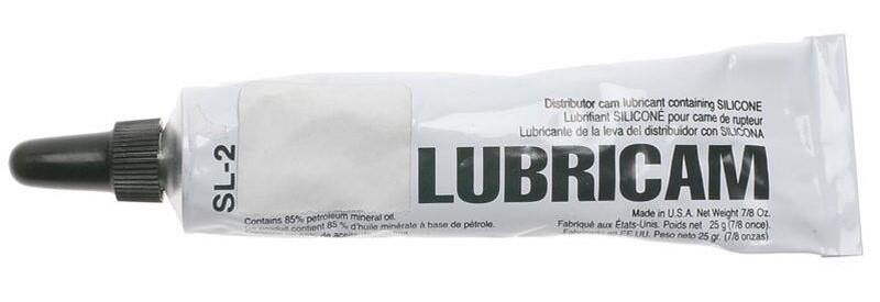

:text-yeahthat: Sandpaper can leave stones embedded in the points faces and prevent contact.   A fine points file is better, but if you use an abrasive, cleaning with a card is important.  Also, electrical contact cleaner is also a good thing.  If you have a rubbing block on the points, be sure to lubricate where it rides with the proper grease, a tube of this will last you several lifetimes:
