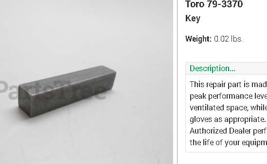

KW88 39 #5 Posted May 9, 2024 20 minutes ago, JoeM said: Toro 520xi and 522xi use the size axles with the only difference is the key way being straight and not woodruff key. Uses the same hub. Maybe you can find a pair of those xi axles used??? Toro XI part number 79-3340 Would you happen to know the part # for that key ? Share this post Link to post Share on other sites
JoeM 10,184 #6 Posted May 9, 2024 5 hours ago, KW88 said: Would you happen to know the part # for that key ? Standard Square Key stock, 1/4x1/4" 2 inches long, hardware store stuff. xi part number is 1 Share this post Link to post Share on other sites
