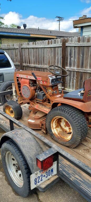

jamesfranklincollins7@gma 2 #1 Posted May 8, 2024 Hello I'm new to the forum. I just purchased a Horse with no name 14hp. 8 speed. It's pretty rough but in Texas you take what you can get. I have been rebuilding things since my retirement 14 yrs. ago. I'm a retired Tool and Die Maker. Anyway I got this tractor home and was turning the engine over with a breakover bar on the flywheel. It turned really easy with no resistance so I took the plug out and no compression. Next I removed the head and discovered the exhaust valve stuck closed with the intake open. I almost didn't get the exhaust valve out but with the help of a pickle bar and some shims it finally came out. Then i discovered an odd thing both valves are the same size. On a Briggs engine the intake is bigger than the exhaust so I'm assuming a kohler is the same. Am I right or wrong. The seat seems to be the same thing an intake. What's going on here. Share this post Link to post Share on other sites
Fordiesel69 268 #2 Posted May 8, 2024 So you have the better 14HP. The K321 and M14 during a certain year did indeed get an upgraded EX valve and you can indeed hear the difference in the muffler. Your 14HP will sound just like a 16HP K341 to the lay ear. I would suggest a full valve job, probably worth machining the valves you have instead of the cheap amazon / ebay china valves. Share this post Link to post Share on other sites

953 nut 58,133 #4 Posted May 8, 2024 Size may be the same but exhaust valves should be heat-treated. intake part # 230582, Exhaust part # 237672 https://isavetractors.com/exhaust-valve-for-kohler-k321-k341-k532-k582-engine/ Share this post Link to post Share on other sites

kpinnc 13,846 #9 Posted May 8, 2024 4 hours ago, jamesfranklincollins7@gma said: On starting a thread on my rebuild where would you do this. In the "Restorations" section. Or ask one of the mods to move this there and keep this as the "before" of your resto. Clearly your tractor has some rust, but otherwise looks to be all there and unmolested. Looks like a solid project machine! Share this post Link to post Share on other sites
