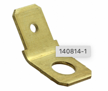

DPrice 24 #4 Posted May 10, 2024 Really hoping to just see how they hooked the charge wire into the positive cable and type and color of connectors used. Sorry for posting so many things it's my first restoration and I want to try to make it right. Share this post Link to post Share on other sites
Handy Don 15,176 #5 Posted May 10, 2024 1 minute ago, DPrice said: Really hoping to just see how they hooked the charge wire into the positive cable and type and color of connectors used. Sorry for posting so many things it's my first restoration and I want to try to make it right. In the days of clamp-to-post (automotive style) batteries, the clamp would sometimes have a Packard 56 style tab for making additional wiring connections to the battery. I haven’t seen one of these in decades. Newer batteries for garden tractors use lug-bolt-style connectors so the wiring terminations all have holes that accommodate the bolt. You could use something like this, I suppose. ! Share this post Link to post Share on other sites
