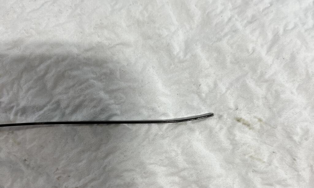

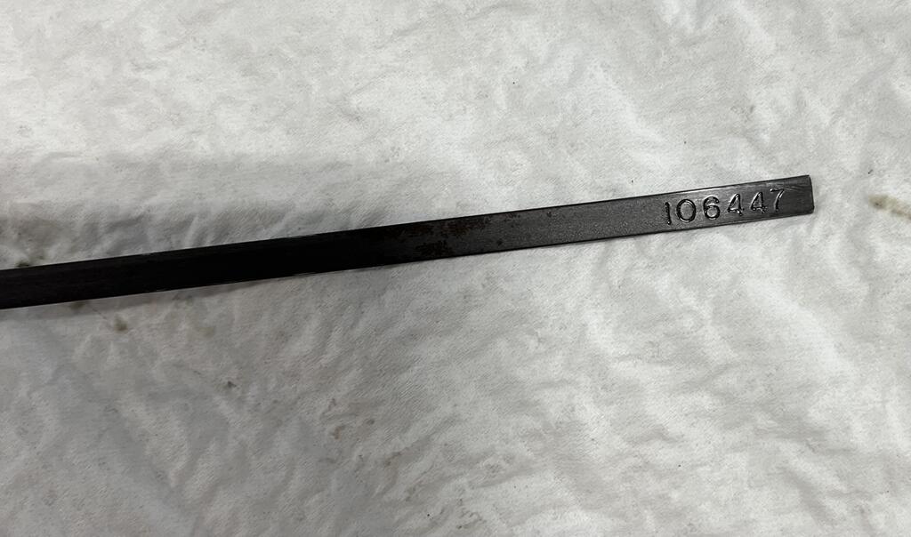

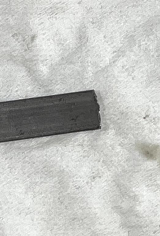

87 416-8 horse 420 #15 Posted May 9 Tomorrow I’m going to call a couple places to get my seals. I do have a question about the dip stick. It has no cross hatch and it appears to be broken but I don’t know for sure. The OP could have put a different dip stick it too. 1 Share this post Link to post Share on other sites
Ed Kennell 37,398 #16 Posted May 9 2 hours ago, 87 416-8 horse said: I do have a question about the dip stick. It has no cross hatch and it appears to be broken You may have found what is causing the seals to leak. I remember a problem with the dipsticks rubbing on a gear, breaking off and getting ground up in the transmission. I'm not sure if this is the transmission. Maybe others with better memories will chime in. @daveoman1966 1 Share this post Link to post Share on other sites

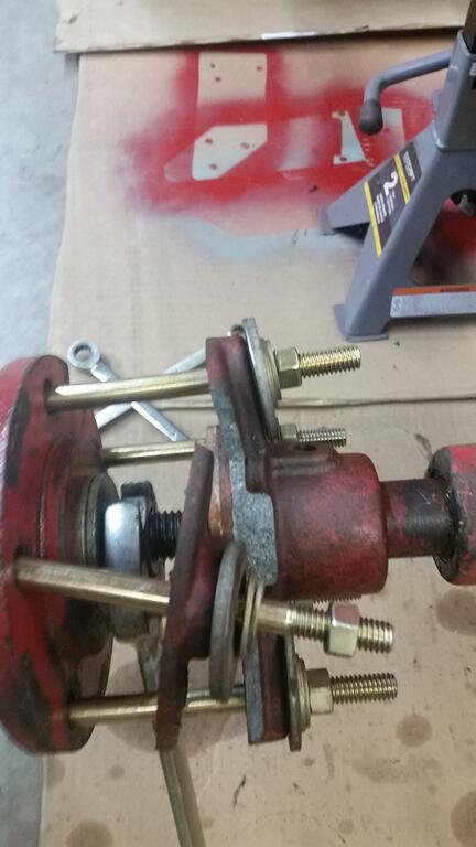

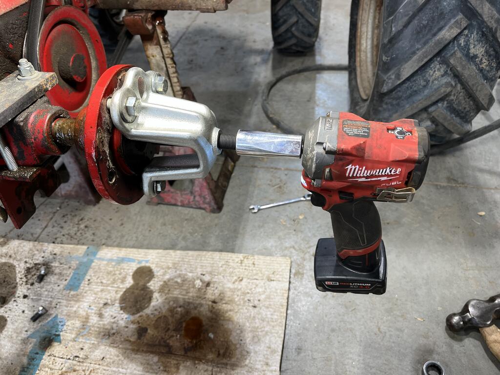

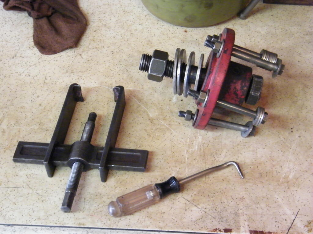

87 416-8 horse 420 #17 Posted May 11 (edited) The hubs put up a fight but I got them off. I used some longer bolts and a axel puller to get them off. Cleaned up the axel shafts with some emery cloth and installed the new seals. I also found the rest of the dip stick in the bottom. I’ll get a picture when I head back out to the shop. Now it doesn’t leave a mark when it’s parked! Edited May 11 by 87 416-8 horse 4 Share this post Link to post Share on other sites
Ed Kennell 37,398 #18 Posted May 11 1 hour ago, 87 416-8 horse said: I also found the rest of the dip stick in the bottom. That's some good news. If you get a new one, leave it on the shelf and just use it when you check the oil. 1 Share this post Link to post Share on other sites

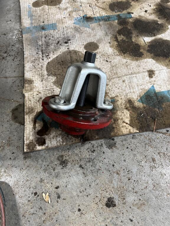

peter lena 8,451 #19 Posted May 11 @ 87 416-8 horse , check out harbor freight for a PACKING PULLER , screw into a small side seal hole and pull out the seal ! packed hundreds of tank drive packing boxes , with fresh packing , using those packing pullers . prefer the bearing puller style of puller , eliminates the flange cracking , you are pulling in its strongest point , not the weakest . pete 1 Share this post Link to post Share on other sites

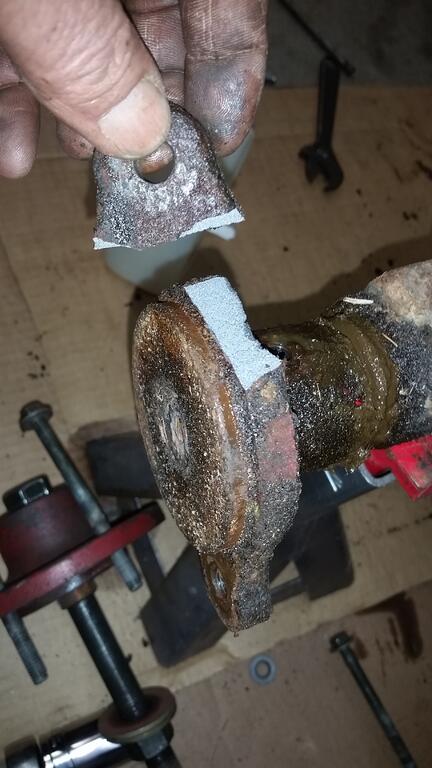

Handy Don 11,852 #20 Posted May 12 9 hours ago, 87 416-8 horse said: Glad this worked for you, but frankly you lucked out. More than a few folks have broken the hub when pulling on them at the flange. Lots of threads of woe if you care to search for them. 3 1 Share this post Link to post Share on other sites
WHX?? 47,970 #21 Posted May 12 Say what Don? Looks like he's got the heavy hubs. Be hard pressed to bust one of them. Like the puller tho. 2 1 Share this post Link to post Share on other sites
kpinnc 11,464 #22 Posted May 12 (edited) On 5/5/2024 at 12:46 PM, rmaynard said: Yes, I said let them leak. The leaking oil should work its magic and wander down the axles and into the wheel hubs, making them easier to remove, which is the most difficult part of replacing the seals. Drip pans are cheap. New hubs are not. Change the seals in 3 months. Just keep an eye on the oil level in the tranny. Edit- nevermind you already pulled them successfully. I hadn't got far enough into the thread before replying... Edited May 12 by kpinnc 3 Share this post Link to post Share on other sites
Handy Don 11,852 #23 Posted May 12 1 hour ago, WHX?? said: Say what Don? Looks like he's got the heavy hubs Never had a set of those. Didn’t realize there were significant differences. 2 Share this post Link to post Share on other sites
peter lena 8,451 #24 Posted May 12 @WHX?? https://www.amazon.com/Performance-Tool-W84550-Bearing-Splitter/dp/B004X9J4AQ/ref=asc_df_B004X9J4AQ/?tac&hvdvcmdl=&hvlocint=&hvlocphy=9003311&hvtargid=pla-762201453508&mcid=7c756cef70113cbb8454e5d68a8a2713&gad_source=1&gclid=EAIaIQobChMIxfLr6YuIhgMVwU1HAR2nWQ4m this the type of puller you want , goes directly at the strongest hold / slide point , also lubricate every possible movement area , like a breaker bar , with a 6 pt. socket , solid no movement . with side extension stop to floor , will make for solid smooth slide , also like kroil penetrant , pete 2 Share this post Link to post Share on other sites
WHX?? 47,970 #25 Posted May 12 Thank you Pete that is what I reach for these days. 2 Share this post Link to post Share on other sites
