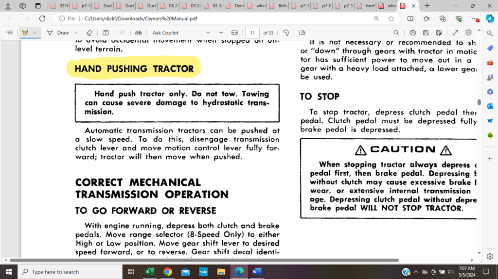

gwest_ca-(File Mod) 12,483 #7 Posted May 5, 2024 Pushing instructions are on page 7 of the operator manual. Tried to copy and paste but can't make it work. 1 Share this post Link to post Share on other sites
953 nut 69,147 #8 Posted May 5, 2024 9 hours ago, gwest_ca said: Pushing instructions are on page 7 of the operator manual. Tried to copy and paste but can't make it work. Are you sure this is for the Eaton 700 transaxle? 1 Share this post Link to post Share on other sites
Ed Kennell 47,266 #9 Posted May 5, 2024 12 hours ago, D_Mac said: There is no dump valve like on my 1075 and 875 ? Correct, the Sundstrands have a "dump" valve and the Eatons do not. With the dump valve open, the Sundstrands can be safely towed. The Eatons can not be safely towed. The Eaton 1100 can be pushed by hand. Some of the Eaton 700s may be slowly pushed by hand by jiggling the motion control lever. Some Eaton 700s will not move at all. You have an Eaton 700. Best to pick it up to move it. 2 1 1 Share this post Link to post Share on other sites
