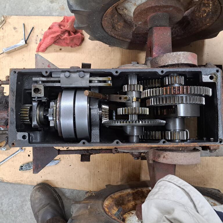

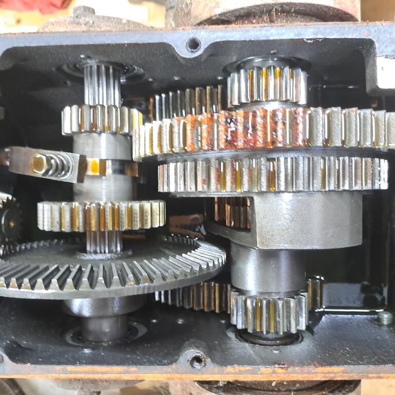

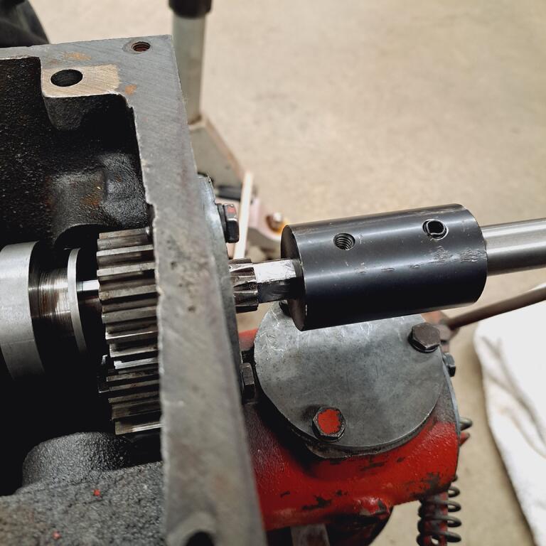

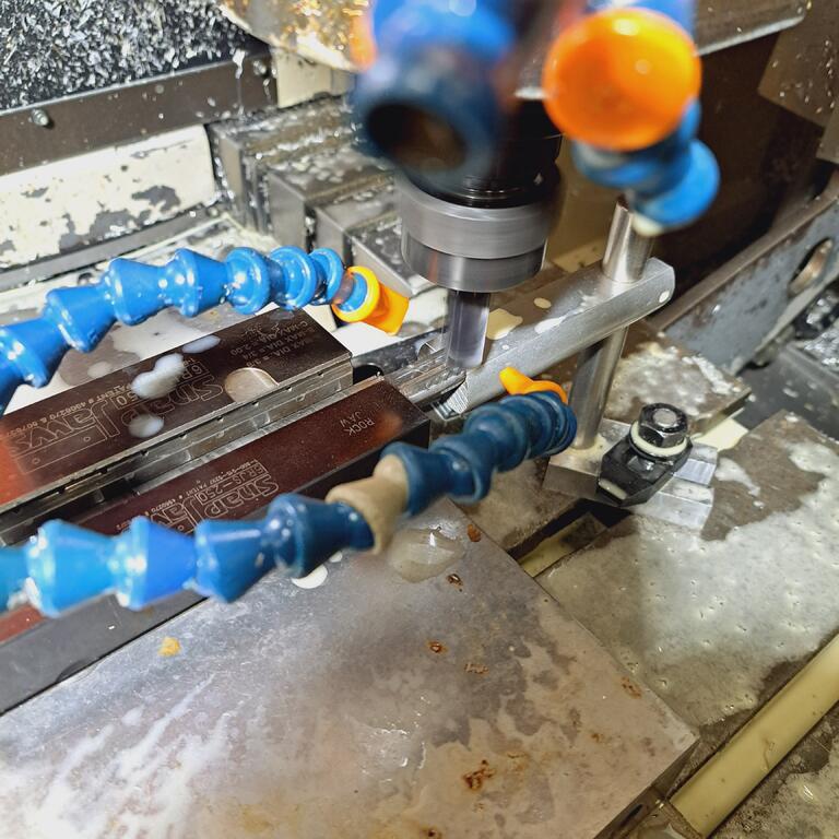

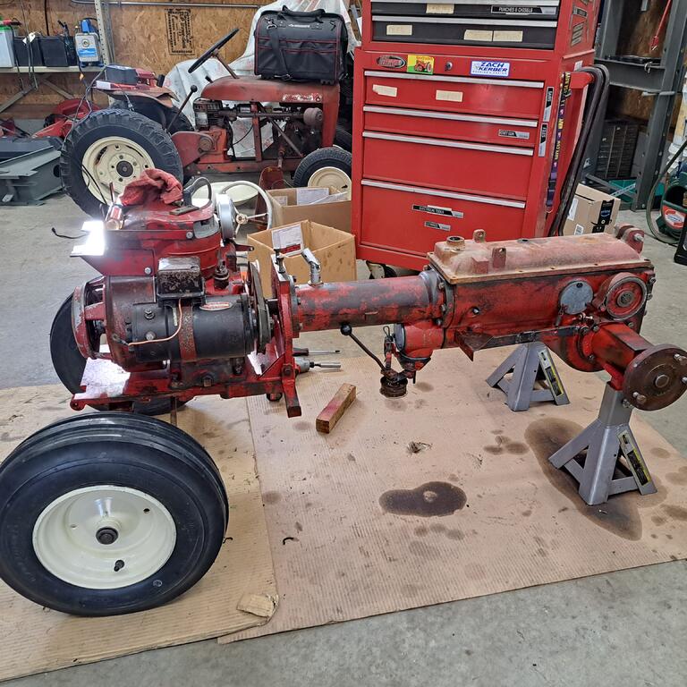

WHX?? 49,919 #9 Posted April 29, 2024 (edited) 1 hour ago, Achto said: Not sure I like the way the front 2 tractors are loaded. Me neither ... double tie downs fer sure... Finally a tractor I know nothing about!!!! Parts??? ... Gotta make them. This one had a messed up splined input shaft but got some creative machining done by a bro of Dan and mine. The transmission is a mind blowing work of art... and a bastage to work on. Planetaries, shift bands for clutch brakes. Sliding shift rails. Lions n tigers n bears oh my... and no service manuals. Mechanical resto but had to build a battery box and used a tray! Jim @oliver2-44 has a fondness. Yep look up Amigo hoarder in the dictionary and there is Mr Gollnicks picture. Beef I have with him he seems unwilling to share info. There is no Amigo forum save his crummy FB page where it's " I'd tell ya but then I'd have to kill ya" mentality. Guess I'm just spoiled with the best red tractor forum on the planet! 161 motor smokes lik a bandito but bore measures & starts good so a re-ring and other love next year. This will be at every show this season so many will get some seat time. It is a blast to drive. Edited April 29, 2024 by WHX?? More pics 4 3 1 Share this post Link to post Share on other sites
