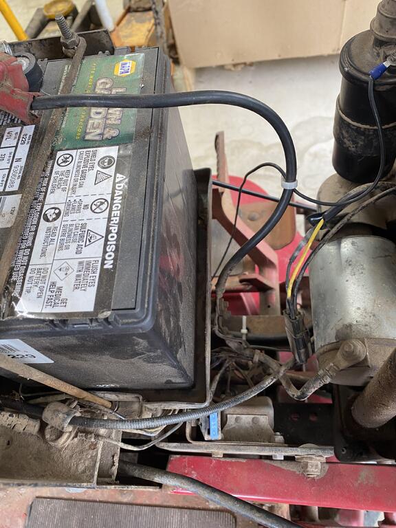

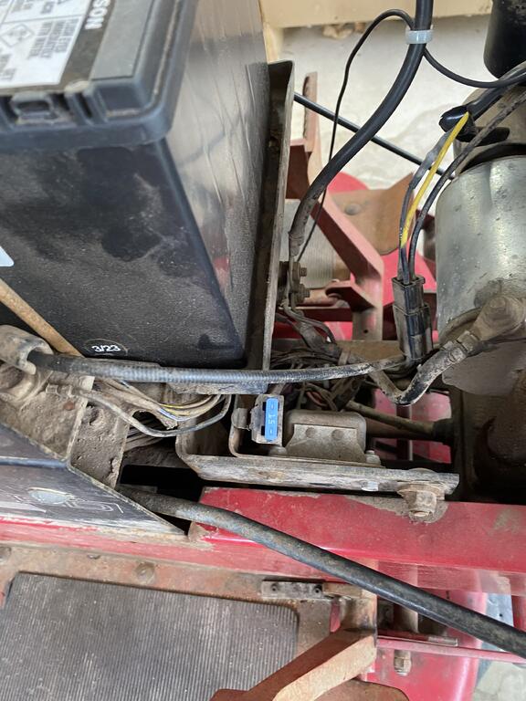

John Rizzardi 70 #1 Posted April 25, 2024 Is there more than the 15 amp fuse i’ve found on my 414-8 tractor, replaced fuse after it blew out (right front side by battery, while doing some testing last night with meter, last night tractor started after replacing the blown 15 amp fuse with the safety switch removed, this morning with safety switch under seat removed (unplugged) the tractor would not start, it needs good (working) switch to start tractor if i’m correct, just want to make sure its not another fuse blown (the one i replaced last night is still ok (has continuity) Share this post Link to post Share on other sites

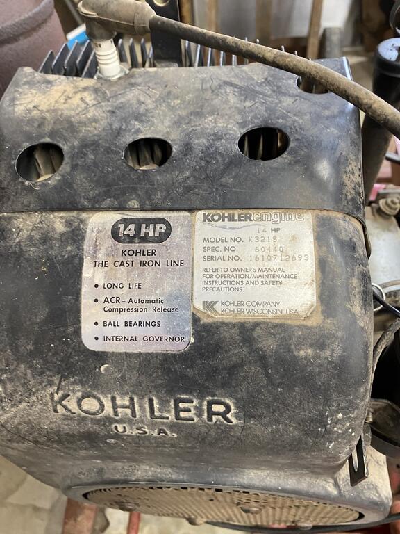

gwest_ca-(File Mod) 11,845 #4 Posted April 25, 2024 What is the model number of your tractor? 31-14K801 - 1986 31-14K802 - 1987 31-14K803 - 1988 31-14K804 - 1989 What is on the engine decal? Engine model? Engine specification number? Engine serial number? Share this post Link to post Share on other sites
John Rizzardi 70 #5 Posted April 25, 2024 this pic tells me all i know about tractor motor gwest_ca Share this post Link to post Share on other sites
gwest_ca-(File Mod) 11,845 #6 Posted April 25, 2024 The engine was made in 1986 and the 60440 spec number was used only in 1986 by Wheel Horse. So the tractor is a model 31-14K801 Click on the pictures in each link for more. More on the model https://www.wheelhorseforum.com/search/?&q=31-14k801&type=downloads_file&page=2&search_and_or=or&sortby=relevancy 1 Share this post Link to post Share on other sites

John Rizzardi 70 #9 Posted April 25, 2024 Last night with my buddy checking circuit with meter on wires for safety switch, he blew the 15 amp fuse on circuit when he grounded the circuit thru meter, tractor would start with switch unplugged, but when PTO was engaged, engine shut off, replaced fuse and tractor turned over and ran and PTO engagement shut off motor, this morning i put switch back in circuit and engine tried to turn over (second or two) and then stopped, now with switch unplugged (and removed) tractor will not turn over, last night it did fire up with switch removed, then blew fuse, replaced fuse and it ran, today with switch reinstalled nothing, 15 amp fuse was fine did not blow again, however, with switch removed from circuit, it should not start i believe, not sure why it turned over last night with switch removed from circuit, however today it would not fire up with switch removed, hopefully when new switch shows up at shop, i’ll pick it up and install it and no reason why tractor should not start and when PTO is engaged, motor will keep running, found 5 amp fuse for running hours and amp meters and it was fine, was looking to see if any other fuse might be bad, Elec diagram that i downloaded shows the two fuses that i found and both 15 amp and 5 amp were good this morning, so hopefully all i need to do is install switch when it arrives to get tractor running and PTO when engaged will not shut off motor, Long text in trying to explain whats been going on, thanks again for the help everyone🤗 Share this post Link to post Share on other sites

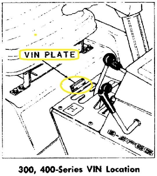

John Rizzardi 70 #10 Posted April 25, 2024 where i was told the placard was with model and serial numbers were(right side of tractor) has been somehow wiped off sticker where the numbers should be, not sure what year it is (can i find the numbers you posted anywhere else on tractor?$ Share this post Link to post Share on other sites

gwest_ca-(File Mod) 11,845 #12 Posted April 25, 2024 The original data decal was below the front of the seat in 1986 1 Share this post Link to post Share on other sites

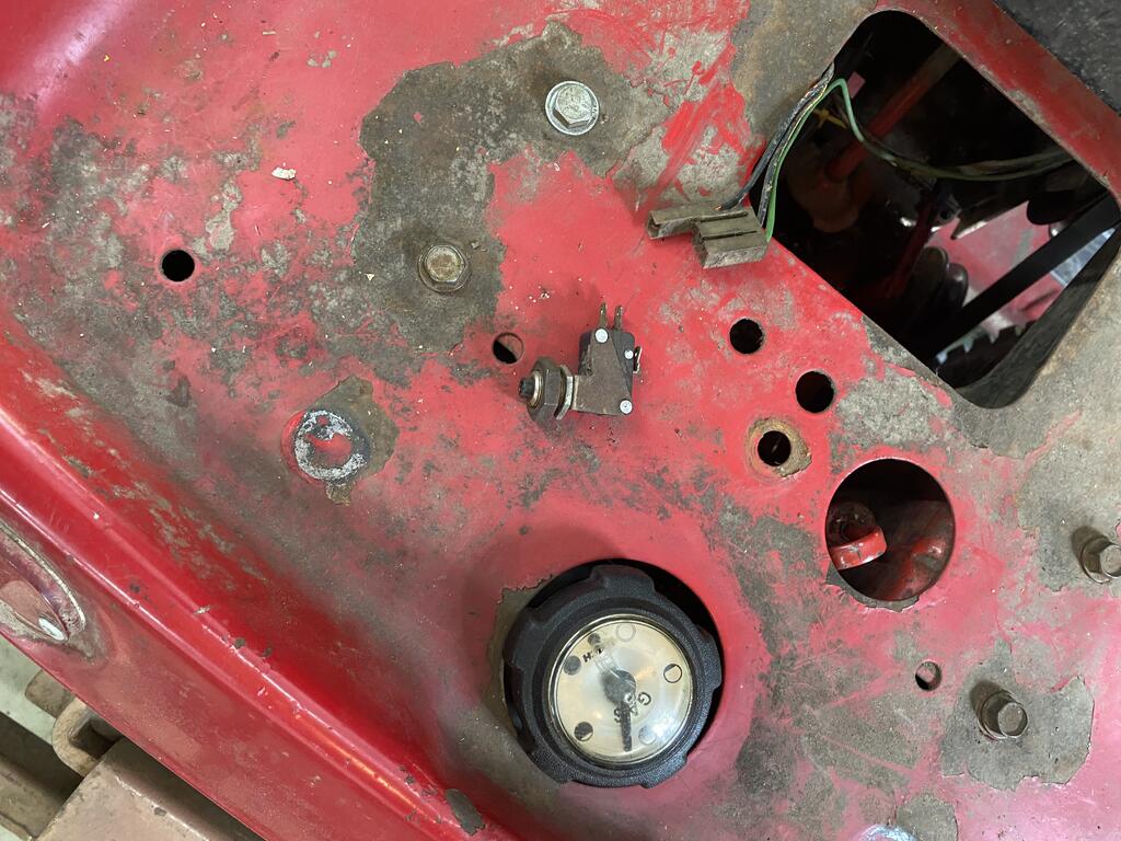

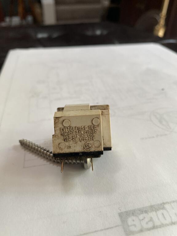

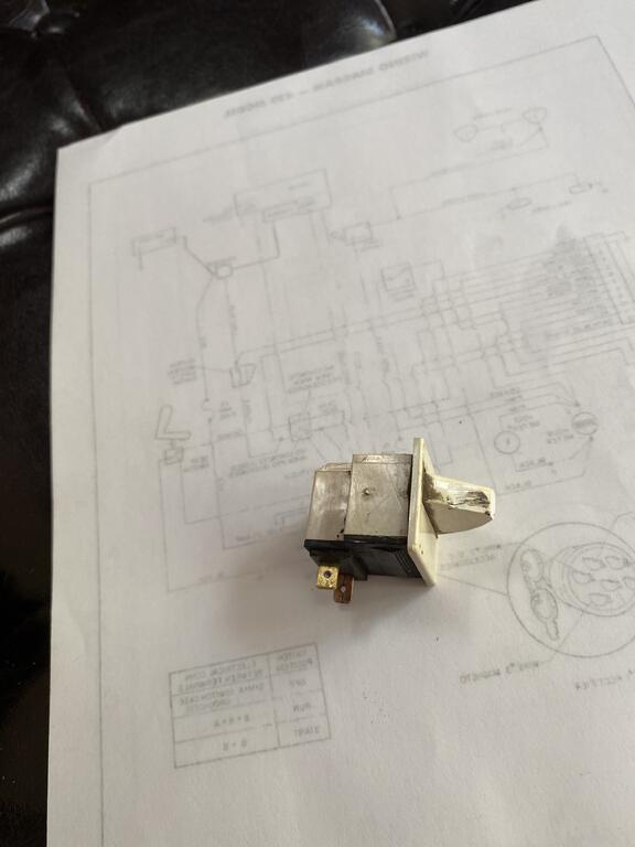

gwest_ca-(File Mod) 11,845 #15 Posted May 2, 2024 Item 8 is the clutch pedal switch. If you look down through the right side shifter slots you should see the switch on the right vertical panel. It is activated by the idler pulley hardware outside the vertical panel. Item 20 are two identical switches. One for the start circuit and one for ignition. You will need to compare the wire colors to know what switch is what. These are activated by the pto handle/lever at the right rear of the battery. https://www.partstree.com/models/31-14k801-414-8-toro-garden-tractor-1986/electrical-system-9/ Right and left are always from the operator in the seat position. Share this post Link to post Share on other sites
John Rizzardi 70 #16 Posted May 2, 2024 gwest_ca, Thank you again for your help, this is Item #8, Little sheared off at the very end and looks worn, As the pics i sent along with post show, on the piece is stamped “Little Fuse Inc” and states “5A at 125v and 2.5 A at 250v, this looks to be what needs to be replaced so far, have not yet removed the one that appears to be at spot where it engages the light on panel for parking break ( Item # 20), since the seat switch appears ok (original one and the one i just purchased) hopefully i’ve narrowed it down to Item #8 first and then Item(s) #20 thanks to your input, i’ll let you know how/which one is the one, since you cannot return elec pieces purchased, Item #8 appears to be my better chance. (Bent screw in 2nd pic was only there to make angle better for photo!😊 Share this post Link to post Share on other sites
