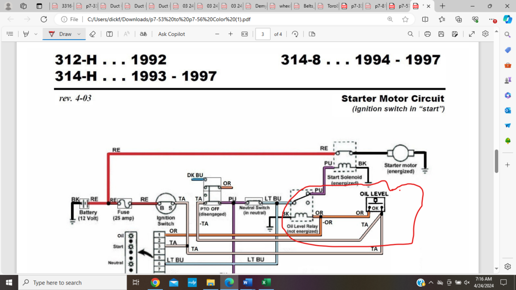

953 nut 57,832 #26 Posted April 24, 2024 9 hours ago, Blasterdad said: I'd try filling it with oil first. Low oil level will keep the oil level relay open preventing the solenoid from closing. 1 Share this post Link to post Share on other sites

953 nut 57,832 #30 Posted April 26, 2024 You are sitting in the seat with the clutch depressed and transmission in neutral, right? Time to do a little testing. With the key in the start position does the "Start Light" on the idiot light panel light up? If not you should clean up the terminals on the switch and try again. Connect one lead of a 12 volt test light or multimeter to your battery + terminal and the other lead to purple wire on the solenoid, turn the key to start and see if there is power. Move the lead to the light blue wire at the neutral or clutch switch, whichever it has, key to start and see if there is power. Move the lead to the purple wire going to the neutral or clutch switch, whichever it has, key to start and see if there is power. Share this post Link to post Share on other sites
Brian Taylor 4 #31 Posted April 26, 2024 I am sitting on the mower with the clutch depressed and the mower in neutral. I don't recall a "start light" when I turn the key to start, the only light I see is the PTO clutch light. I did connect the battery+ terminal to the purple wire terminal with the wire disconnected and that engaged the starter. The wire itself has 12.9 volts in the start position. I have not checked the Lt. blue wire, the light blue wire goes to a neutral switch and ultimately connects to the purple wire (not directly to the clutch switch) according to the above diagram. I'll see if I can find where the purple and lt blue wires connect to each other on the tractor. I am not sure where the neutral switch is on the tractor. If you have any comments before I can get to that I would appreciate that. Thanks for your help. Share this post Link to post Share on other sites
953 nut 57,832 #32 Posted April 26, 2024 4 minutes ago, Brian Taylor said: I did connect the battery+ terminal to the purple wire terminal with the wire disconnected and that engaged the starter. The wire itself has 12.9 volts in the start position If the starter operates when a 12 volt jumper is placed where the purple wire connects to the solenoid and the purpled wire itself has 12 volts when the key is in the start position then he starter should turn over from the key switch in the start position. Share this post Link to post Share on other sites
Brian Taylor 4 #33 Posted April 26, 2024 I wonder if the neutral switch could be the problem. It looks like the switch should be closed and energized in neutral when in the start position. I am not sure how to eliminate if the PTO switch is the culprit. Share this post Link to post Share on other sites
