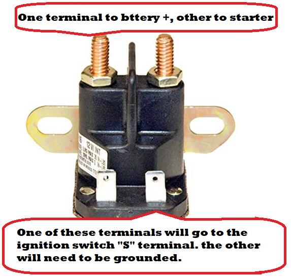

Blasterdad 2,782 #13 Posted April 23, 2024 Are you getting voltage to the little terminal on the solenoid in "start"? Share this post Link to post Share on other sites
Brian Taylor 4 #14 Posted April 23, 2024 There are two wires below the solenoid which should I check or just check across them?? Share this post Link to post Share on other sites
953 nut 56,742 #15 Posted April 23, 2024 1 minute ago, Brian Taylor said: There are two wires below the solenoid which should I check or just check across them?? One of the small wires goes to ground and the other one (probably blue) should read battery voltage when the key is in START. 1 Share this post Link to post Share on other sites
Blasterdad 2,782 #16 Posted April 23, 2024 5 minutes ago, Brian Taylor said: There are two wires below the solenoid which should I check or just check across them?? According to the wiring diagram it should be the purple wire. Share this post Link to post Share on other sites
Brian Taylor 4 #17 Posted April 23, 2024 12.9 volts to the left wire while disconnected 8.7 volts to the right wire while disconnected. Share this post Link to post Share on other sites
Brian Taylor 4 #18 Posted April 23, 2024 I was reading the wires not the terminals. The S wire read 12.9 volts while disconnected and the switch turned to start. Share this post Link to post Share on other sites
Blasterdad 2,782 #19 Posted April 23, 2024 According to the diagram it has a neutral 2 minutes ago, Brian Taylor said: 12.9 volts to the left wire while disconnected 8.7 volts to the right wire while disconnected. We need the color of the wire, not left or right. The purple wire should be getting 12 volts. The black wire should be a ground. According to the diagram your tractor has a neutral switch, oil switch, PTO switch, & seat switch. Did you check the oil? Try runninng a jumper wire from the positive terminal of the battery to the purple terminal of the solenoid with the tractor in neutral & the purple wire not hooked up to the solenoid. Share this post Link to post Share on other sites
953 nut 56,742 #20 Posted April 23, 2024 (edited) Be sure the transmission is out of gear. Take a small jumper wire from the battery "+" terminal and touch it to the solenoid small terminal.where the wire from the ignition switch "S" was connected @Blasterdad posted while I was typing. Edited April 23, 2024 by 953 nut Share this post Link to post Share on other sites

Brian Taylor 4 #24 Posted April 24, 2024 (edited) Transmission has been out of gear all long, I checked with the wire like you said and the solenoid engaged the starter. Edited April 24, 2024 by Brian Taylor Share this post Link to post Share on other sites
Blasterdad 2,782 #25 Posted April 24, 2024 1 hour ago, Brian Taylor said: Transmission has been out of gear all long, I checked with the wire like you said and the solenoid engaged the starter. Ok great, now we know one or more of you safety switches is interrupting the start circuit, I'd try filling it with oil first. That would explain the oil light flickering too. 1 Share this post Link to post Share on other sites
