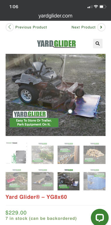

PWL216 893 #23 Posted April 24, 2024 I use the Yard Glider. Works great. 2 1 Share this post Link to post Share on other sites
953 nut 56,739 #24 Posted April 24, 2024 5 hours ago, PWL216 said: Yard Glider. Works great. That looks like it would do the trick. Seems most of the responses have missed the point that the snow blower is on the dirt in front of the tractor and needs to be moved. On 4/23/2024 at 5:59 PM, victorb said: Everything is outside right now. It is covered but it is just plain dirt floor. 2 Share this post Link to post Share on other sites
