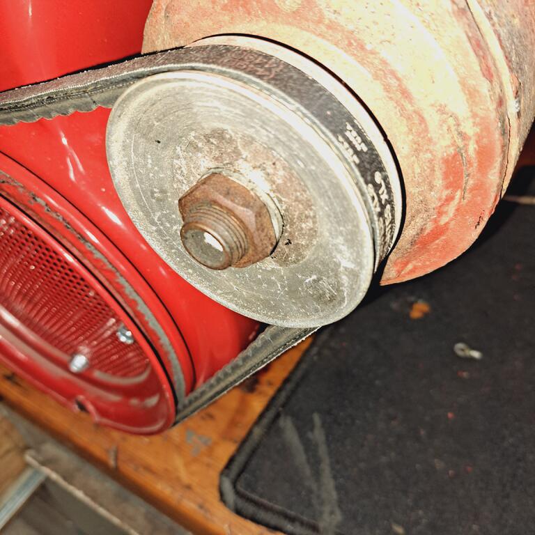

Racinbob 12,424 #1 Posted April 19, 2024 This looks kinda goofy to me. It's a starter/generator pulley on a K-181. Is this thing threaded? I haven't put any real effort in getting it off........yet 1 1 Share this post Link to post Share on other sites
WHX?? 53,318 #2 Posted April 19, 2024 (edited) 31 minutes ago, Racinbob said: This looks kinda goofy to me Got that right ! Looks like somebody welded it on. Pic is like your eyesight these days Bob ... real blurry... Should be threaded with a nut. Real goofy fine thread size too and It's not 5/8-18 or 5/8-24. Edited April 19, 2024 by WHX?? 2 Share this post Link to post Share on other sites
Ed Kennell 43,782 #3 Posted April 19, 2024 5 minutes ago, WHX?? said: Looks like somebody welded it on Plan B when you lose the rare nut. 1 Share this post Link to post Share on other sites
WHX?? 53,318 #4 Posted April 19, 2024 7 minutes ago, Ed Kennell said: lose the rare nut. Haven't turned to the arc side ... yet... 5 Share this post Link to post Share on other sites
Racinbob 12,424 #5 Posted April 19, 2024 22 minutes ago, WHX?? said: Got that right ! Looks like somebody welded it on. Pic is like your eyesight these days Bob ... real blurry... Hey! I paid thousands to make that blur go away. 18 minutes ago, Ed Kennell said: Plan B when you lose the rare nut. The nut was on it. I guess that means I'm not going to be replacing the bearing on that end. Share this post Link to post Share on other sites
Handy Don 15,171 #6 Posted April 19, 2024 7 minutes ago, Racinbob said: Hey! I paid thousands to make that blur go away. The nut was on it. I guess that means I'm not going to be replacing the bearing on that end. I'm not so sure the pulley is welded to the shaft (at least not by humans). Blurry makes it hard, but I suspect you are seeing the pulley body welded to the threaded hub. 3 Share this post Link to post Share on other sites
WHX?? 53,318 #7 Posted April 19, 2024 Don may be on to something there Bob. Share this post Link to post Share on other sites

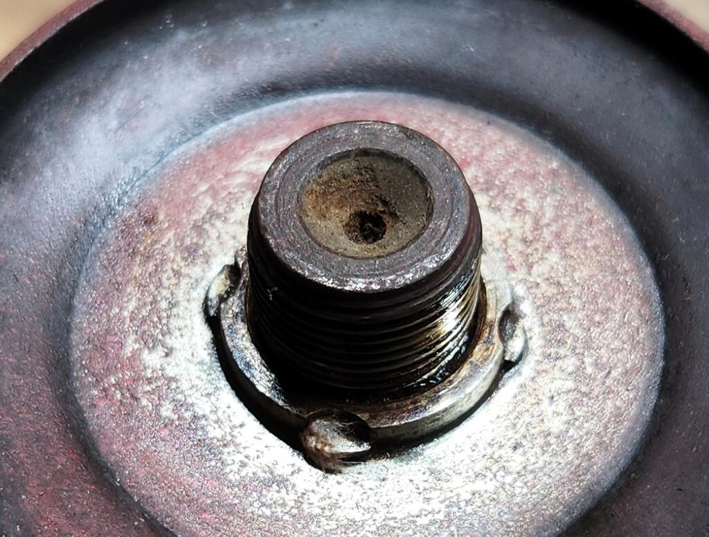

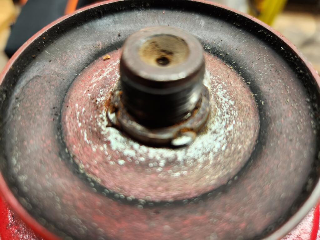

Racinbob 12,424 #8 Posted April 19, 2024 Here's a better picture guys. Definitely not welded I'd say. It kinda looks like a lock nut that a special socket would fit over? Share this post Link to post Share on other sites
WHX?? 53,318 #9 Posted April 19, 2024 (edited) OK yes much better. You should be able to see a keyway and the pulley should slide right off with some schlipenlube. Wedges behind it to get it started. It's not threaded. Keys can be a bugger to get out but expendable. Small woodruff. Edited April 19, 2024 by WHX?? Share this post Link to post Share on other sites
WHX?? 53,318 #10 Posted April 19, 2024 11 minutes ago, Racinbob said: kinda looks like a lock nut that a special socket would fit over? Just the bore staked to the pulley. 2 Share this post Link to post Share on other sites
Racinbob 12,424 #11 Posted April 19, 2024 (edited) 14 minutes ago, WHX?? said: OK yes much better. You should be able to see a keyway and the pulley should slide right off with some schlipenlube. Wedges behind it to get it started. It's not threaded. Keys can be a bugger to get out but expendable. Small woodruff. I don't see any signs of a keyway. I'll attack it again tomorrow. I've got it soaking right now. I really don't think I have to get the pulley off. It lost its oomph to get the engine cranking enough to start up. Battery, cables, connections all are excellent. I've got a kit coming for it. Edited April 19, 2024 by Racinbob Share this post Link to post Share on other sites
Handy Don 15,171 #12 Posted April 19, 2024 (edited) 1 hour ago, Racinbob said: Here's a better picture guys. Definitely not welded I'd say. It kinda looks like a lock nut that a special socket would fit over? As @WHX?? noted... 1 hour ago, WHX?? said: staked to the pulley. There are four shallow grooves cut longways in the side of the threaded hub. Here you see the ends of them. Once the hub is in the pulley body, a special fitting on a big press drives metal “stakes” into the grooves and against the body to wedge the two together tightly. The ends of the stakes get peened over a bit by the press fitting, as well. The outer nut and washer assure that the pulley can’t “spin off” of the shaft! Edited April 19, 2024 by Handy Don 2 Share this post Link to post Share on other sites
Racinbob 12,424 #13 Posted April 19, 2024 24 minutes ago, Handy Don said: As @WHX?? noted... There are four shallow grooves cut longways in the side of the threaded hub. Here you see the ends of them. Once the hub is in the pulley body, a special fitting on a big press drives metal “stakes” into the grooves and against the body to wedge the two together tightly. The ends of the stakes get peened over a bit by the press fitting, as well. The outer nut and washer assure that the pulley can’t “spin off” of the shaft! Interesting Don. It sounds like as long as the bearing is OK I shouldn't even try to get it off because it would damage the threads. Apparently they didn't do that on all of them. It's not mentioned on any of the videos I've watched or in any of their service bulletins. 1 Share this post Link to post Share on other sites

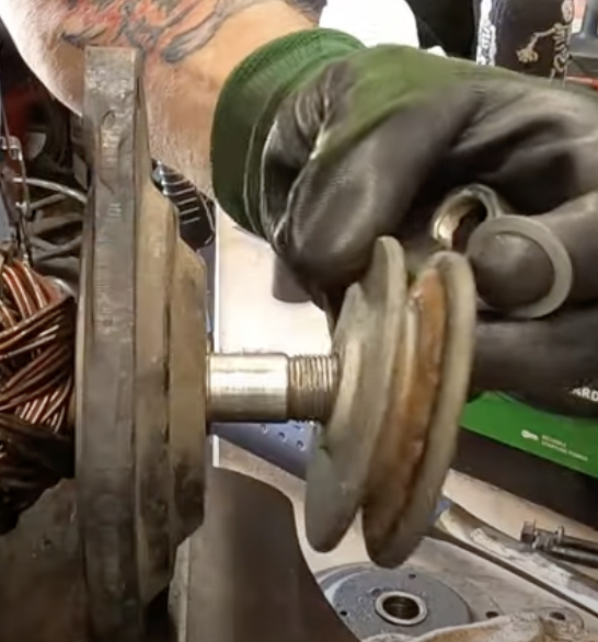

Handy Don 15,171 #14 Posted April 19, 2024 3 hours ago, Racinbob said: Interesting Don. It sounds like as long as the bearing is OK I shouldn't even try to get it off because it would damage the threads. Apparently they didn't do that on all of them. It's not mentioned on any of the videos I've watched or in any of their service bulletins. I agree that not fixing something that isn’t broken is a win all day long 😄 What isn’t totally clear from the pictures (and from my very limited S/G experience) is whether that hub is actually threaded. The pulleys on the two S/G’s I’ve had apart did NOT have threaded hubs--the bores were smooth with keys and the protruding side of the pulley's hub rested against a step in the shaft diameter. A bearing puller would likely get it off pretty easily. This captures from a video are illustrative. Share this post Link to post Share on other sites

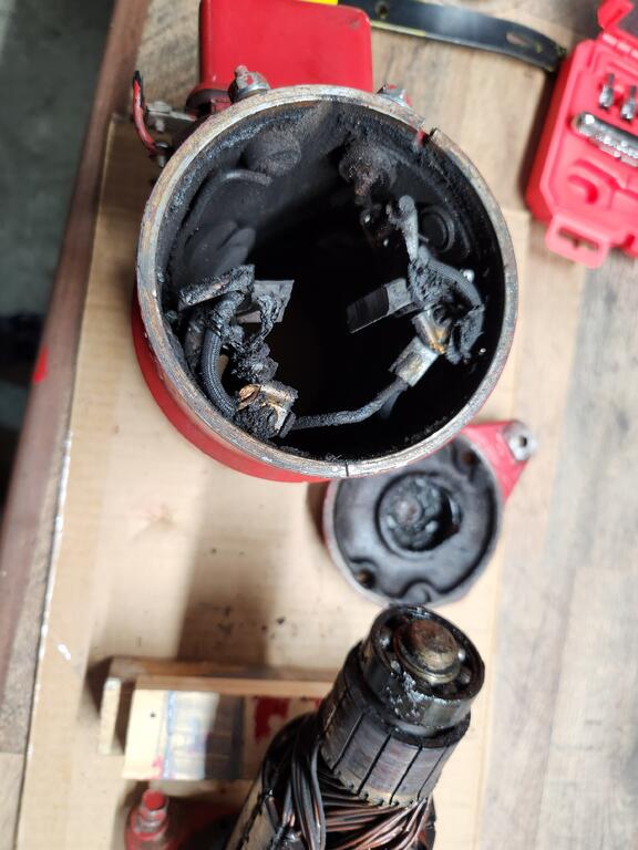

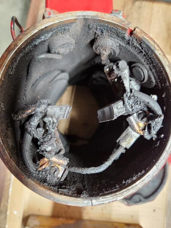

Racinbob 12,424 #16 Posted April 20, 2024 Now I've never claimed to be an expert on these here starter/gen do-dads but I'm thinking this thing need a good cleaning. Where the do I start? What evil chemical would you guys use? Maybe a potent mixture of Dawn in hot water? Brake, carb or electrical spray cleaner? The kit I have coming has two bearings, brushes, brush springs and the two studs sticking through the case. I'll decide when I get it cleaned up if I'm going to mess with soldering in the two new studs. There's no visible signs of any damage to the armature winding and no unmistakable electrical smell of overheating. I'll ring them out later. I'll replace that bearing and polish up the commutator. The pulley end bearing is still an unknown. It depends if I can get the pulley off. That bearing does have a cover so it shouldn't be as dirty and it feels good spinning it. The date code tells me this was made in December 1963. I'd say Delco-Remy builds tanks. 1 Share this post Link to post Share on other sites
