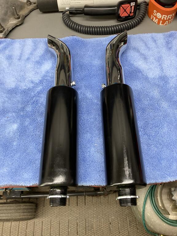

Blasterdad 3,039 #9 Posted April 21, 2024 These work good too. https://farmpartsstore.com/muffler-18543-o-b1sb2286/ 2 1 Share this post Link to post Share on other sites
ebinmaine 70,752 #10 Posted April 21, 2024 10 hours ago, Blasterdad said: These work good too. https://farmpartsstore.com/muffler-18543-o-b1sb2286/ On 4/19/2024 at 8:23 AM, ebinmaine said: Gravely Muffler That's the one I was trying to find. I've been liking these because they're compact and work well. I've done two tractors with them by turning the muffler out and forward. With correct piping one could also use these as a replacement for the stock underhood mufflers as well. 1 1 Share this post Link to post Share on other sites
