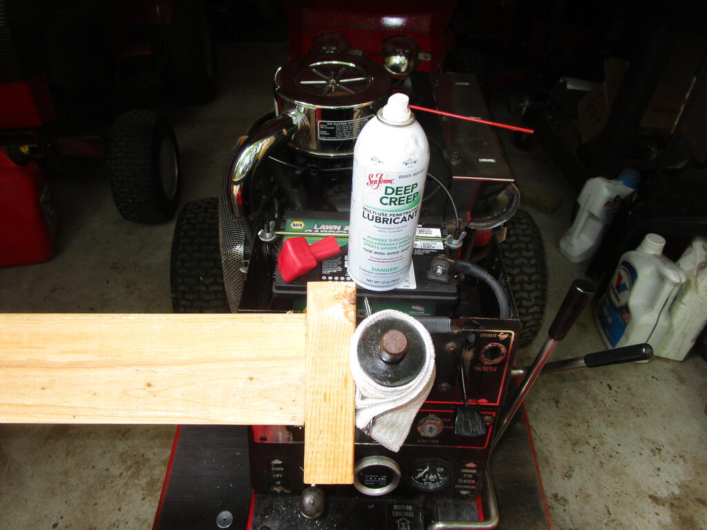

ri702bill 8,761 #3 Posted April 18, 2024 There has been MUCH discussion on this before - back up the shaft below the plastic hub with a 2x4 propped up to a wall stud. Use a ROLLPIN punch of the correct size, punch perhaps held in locking pliers and hit the punch with a 3 pound hammer. Even with the pin out, they can be stubborn. Fifty or more years or being rusted into place does not come loose in 2 minutes...... 6 Share this post Link to post Share on other sites

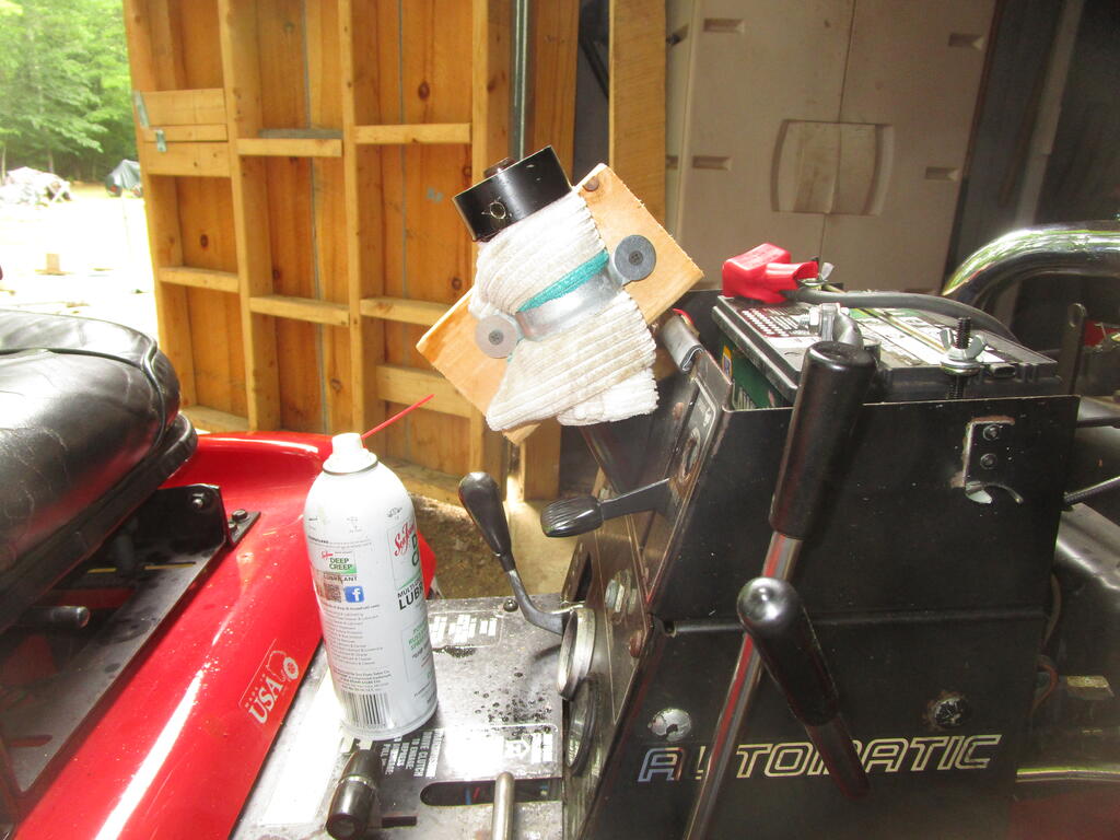

JCM 9,928 #5 Posted April 19, 2024 This is on a 420-LSE, a little different but similar. 10 Share this post Link to post Share on other sites

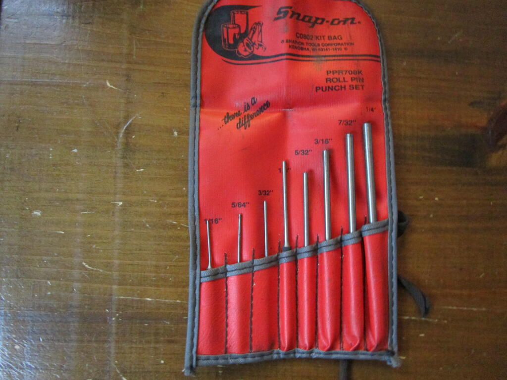

ri702bill 8,761 #8 Posted April 19, 2024 Also - invest in a good set of roll pin punches, like the ones pictured. Cheap offshore ones will lead to disappointment in results and money wasted. "Cheap things are not good, Good things are not cheap" Pick one....... 2 Share this post Link to post Share on other sites
peter lena 8,977 #9 Posted April 19, 2024 @Keaton agree with others on above methods , impact bounce , is not what you want , done that wall beam set up , myself , and a 3 lb hammer on a flat face drill punch . have also same size wire wire tube brush that hole related area , clean out the rusty crud , like never seize on new roll pin , related is that entire area , for function and issues , like PTO lever rod starting point , next to battery lower tray area , like a gold mine , for improvement , easy too ! snoop around , pete 2 Share this post Link to post Share on other sites
peter lena 8,977 #10 Posted April 19, 2024 @JCM how could I forget ? ,on that roll pin , get a penetrating oil on / in that roll seam , before use , that will enhance the spring / slide action on the pin , also establishing a lubricant / instead of rust in its function . have a good day . stay oily , pete 2 Share this post Link to post Share on other sites
Mike'sHorseBarn 3,055 #11 Posted April 19, 2024 2 hours ago, ri702bill said: Also - invest in a good set of roll pin punches, like the ones pictured. Cheap offshore ones will lead to disappointment in results and money wasted. "Cheap things are not good, Good things are not cheap" Pick one....... I bought that exact set of roll pin punches and paid good money for them, but it was worth every penny. The difference is night and day over flea market roll pin punches. 2 1 Share this post Link to post Share on other sites

Damien Walker 246 #13 Posted April 20, 2024 I agree with everything said here. You need a quality punch of exactly the right size and it is essential to brace the shaft to take the pounding. In my experience, the pins come out quite easily if properly braced and struck square on. Taking the column (and dash!) off the tractor is sometimes the only way. Good luck! 1 Share this post Link to post Share on other sites
Cody 277 #14 Posted April 21, 2024 I just went through this with a 653 I'm working on, soaked it for weeks with wd40 and pb blaster. No luck, couldn't get it to budge. I got reading on here about people having great success with crc's knocker loose so I got a can. I've never been more impressed with a penetranting oil! During this whole process I also bought a set of snap ons roll pin punches that go in the air hammer. What a difference! No more hitting your hands and that roll pin didn't stand a chance, it came right out. I would highly recommend those air hammer punches to anyone! 3 1 Share this post Link to post Share on other sites

peter lena 8,977 #16 Posted May 1, 2024 @Keaton unless you brace that steering column to a wall post , your punch impacts are bouncing , uselessly , having done wheels myself , unless you are solid impact stopping with a 3 lb hammer to punch , its useless . look at @JCM set up , thats what you want . another thing I do is to use a thin pencil type steel brush in the related holes , to clean out the grunge , like never sieze , on pin replacement , also soaking lubricant in that roll pin to reinstall , it will free up the grunge / rust and install easier , eliminate, the impact bounce , get results , pete 2 Share this post Link to post Share on other sites

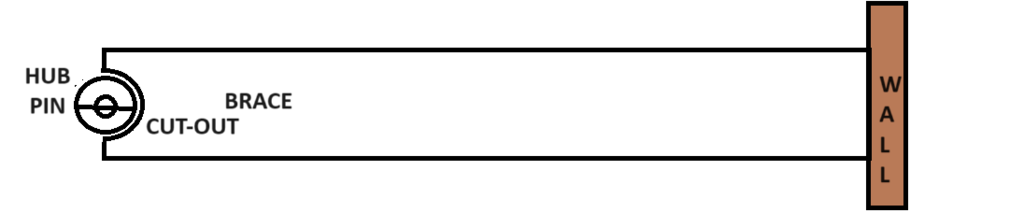

rmaynard 15,805 #17 Posted May 1, 2024 So, it looks to me like you have a steering wheel that the hub is encased in plastic. Also, according to the parts list for the 32R, the roll pin is 3/16". You will never get it out with a 1/4" punch. Your biggest problem with bracing is that you may break the plastic if you don't make a brace that conforms to the shape of the hub. The image is not in the correct perspective, but it shows a 2x4 cut with a hole saw the same diameter as your center hub. Drive the pin in the direction of the brace. The pin will go into the 2x4. 2 Share this post Link to post Share on other sites
