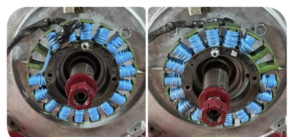

Bob Bauer 27 #1 Posted April 17, 2024 Hello , when I took off this stater the black two wires were pressed in between the two posts and then ran back through the plate like shown in picture one but seems like it would make more sense to just run it straight back through the plate like picture two rather then rap it around the post and then back. So question is does it matter. I see that two of the posts don’t have wires rapped around them and would be on opposite sides. This is on a D 160 Kohler 16 hp. Thanks Share this post Link to post Share on other sites
Achto 28,249 #2 Posted April 18, 2024 Being that it is an AC system, I do not believe that it would matter. 3 Share this post Link to post Share on other sites
gwest_ca-(File Mod) 11,187 #3 Posted April 18, 2024 Can the one on the left be turned around to match the right one? Share this post Link to post Share on other sites
Bob Bauer 27 #4 Posted April 18, 2024 5 hours ago, gwest_ca said: Can the one on the left be turned around to match the right one? That’s the same one Share this post Link to post Share on other sites
Handy Don 13,129 #5 Posted April 19, 2024 On 4/17/2024 at 12:42 PM, Bob Bauer said: So question is does it matter 15 hours ago, Achto said: Being that it is an AC system, I do not believe that it would matter. I agree. It doesn’t matter if you input AC or CA--it’ll come out DC from the regulator! 1 Share this post Link to post Share on other sites
