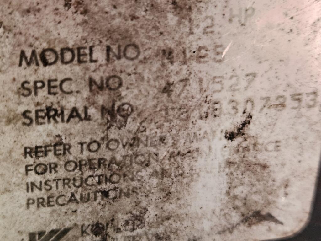

KW88 33 #1 Posted April 17, 2024 I recently picked up a 312-8 as a restoration project and have some questions regarding starting. So I was told when purchasing it needed a battery, which I know is said when there's underlying issues however, with a jump it starts right up, drove it onto trailer and brought it home. I have cleaned all visible ground connections and started replacing parts etc as part of my restoration plan such as solenoid, starter, fuel pump & filter, plug, belts, air filter... I have yet to uncover the starting issue still and was hoping for some advice. Year is unknown as you can see in the attached pic the numbers are highly illegible. It does have the test switch and indicator lights on the dash and I located the ignition coil on the flywheel yesterday which by eye appears to be in good shape but ordered a new one anyway. Please let me know if you can think of something I'm missing. Thanks! Share this post Link to post Share on other sites

gwest_ca-(File Mod) 11,241 #3 Posted April 17, 2024 That engine used 1987-1997 Can you read the engine serial number? That would give a rough date. Download these 5 pages The idiot lights should have no effect on the problem. The engine should run without them. Share this post Link to post Share on other sites
KW88 33 #4 Posted April 17, 2024 35 minutes ago, gwest_ca said: That engine used 1987-1997 Can you read the engine serial number? That would give a rough date. Download these 5 pages The idiot lights should have no effect on the problem. The engine should run without them. I don't believe the lights would be the problem. Just thought it might help identify a year. Share this post Link to post Share on other sites
KW88 33 #5 Posted April 17, 2024 Looks like first 2 numbers are 18 which would make it a 1988. Share this post Link to post Share on other sites
gwest_ca-(File Mod) 11,241 #6 Posted April 17, 2024 An engine made in 1988 could land on a 1988 or 1989 model tractor. In case there is a difference in the wiring this is 1989 Share this post Link to post Share on other sites
