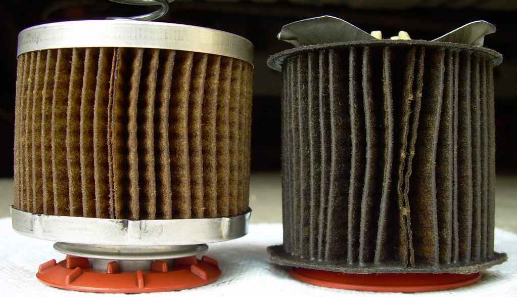

ri702bill
All Fram products USED to be designed & manufactured here in Rhode Island. Fram sold out to Allied Signal in 1985 and moved production to Mexico City......
I would not even use a Fram oil filter on the ex-wife's car!!!
Had an instance where I was doing an oil change one Sunday afternoon on my Saturn 5 speed. The new Fram filter would only screw on about 3/4 of a turn. The end plate was only half tapped thru!!! Garbage.
I haven't used a Fram since about 1993 when the parts store I worked at switched to Baldwin.
There were all kinds of advertising promos FOR Baldwin and of course showing the inherent reasons not to use other brands.
Thin shell and cardboard ends were the end of Fram for me.
Since then I've used predominantly Motorcraft and AC Delco.
For our equipment I use Wix 1410 bought as NOS so they're still USA made.
You may get lucky with Fram Ultra synthetic or Titanium.
Xtra Guard = junk
Fram on the right Napa on the left

Not so sure the metal ends on that filter make it better?? The element is paper. The element is glued to the metal ends and well as the paper ends. And it looks like the paper end one will flow with less restriction.
When purchasing wanted to change our filters we sent them to an independent lab.  There is a lot more to it than looks.
And when it comes to filters you can get good quality from all of the mfg. Just going to cost ya.

the cheap orange basic fram yea. they are bad..but they make better grade lines and some of the are top tier..even the orange ones arent bad when used properly.  They arent made for 10,000 miles.  3k max.  i dont see an issue running it for 25-50hr in a lawn mower.

Any company that sells the junk pictured in an above post does not deserve my business.  YMMV

They all sell them...yes even wix, they call them protec :lol:

Protec does not have cardboard junk.
