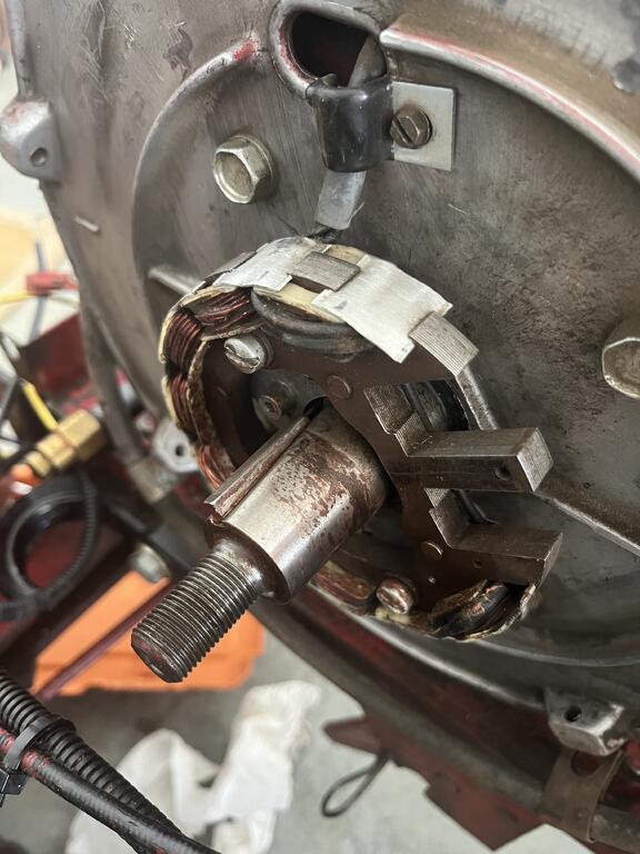

•points push rod does push out when turning engine over by hand, but unable to get points timed using multimeter method and timing mark on flywheel

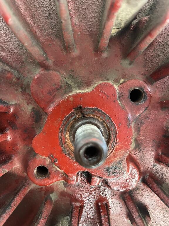

I’d like to check the flywheel key next because it is running rough and backfired through the carb when shut down so that would mean timing is advanced right plus I still can’t time it with multimeter off timing marks.
Any recommendations on a flywheel puller?
Not having luck with dead blow hammer and prybar.
Here’s a photo of flywheel and crank. That’s copper anti-seize, not rust, as I did have flywheel off last year when working in a shop and had access to a puller from a coworker mechanic. I think we may have replaced the key at that time, but can’t recall…
Edited by BrianKoch
pfrederi
The key looks ok
953 nut
Backfiring on shutdown shouldn't be an ignition issue as the ignition is OFF. Could be a carbon buildup that is holding heat.

BrianKoch
Update
Bought a $10 harmonic balance puller from Napa and popped the flywheel off. Key looks good to me.

Can you position the piston  at TDC thru the spark plug hole or by removing the head.   Then verify the points are opening at the proper time?

Did you ever try the test lamp coil - (points side) and see if it flashes if it doesn't there is problem with the points (contacts or insufficient movement).  When you say you couldn't time it what happened?  What is current gap setting

Discovered I incorrectly set valve lash out in the field (where I broke down) while troubleshooting. I set TDC by aligning the T on flywheel with timing mark, but must have been on the wrong stroke. This resulted in poor engine performance and a backfire through carb when it ran enough to move into the garage.
Yes, I was able to confirm the new points are good and functioning via test light flashing on and off. However, I only was able set them with a feeler gauge to 0.02 at TDC and still can’t time via multi meter method.
Now that valve lash is correctly set and new points are installed it’s running pretty well. I do notice a small continuous arc at the points. Could this be caused by the timing not being 100% correct or something else?

Turn the engine over by hand, (with the plug lead disconnected). When the points are at maximum gap, then set to 0.020”. Then with test light , or multimeter connected, digital meters need to be on ‘diode/continuity’ mode for this test, resistance mode won’t work! Turn engine back past t.d.c then forward until light goes out, or meter shows open circuit! 0.020” at t.d.c, may or may not be absolutely correct, I don’t know? Points should begin to open as your timing marks align.
  • Like 2
953 nut
I prefer a test light rather than a meter for static timing, faster response time in my opinion.
  • Like 1
ranger
Plus it’s easier to see a light going out in your peripheral vision, whilst staring directly at the timing marks, than it is to see a multimeter’s display change!
