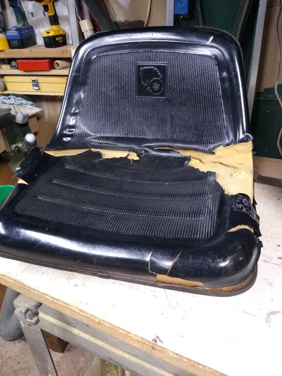

CCW 1,314 #1 Posted April 9, 2024 The seat on my 312-8 has seen better days so I decided to reupholster it myself. Expecting this project to take me some time to complete a temporary seat has been put in place. On CL I found an architect's desk chair for $10. Removing the seat it has been mounted to the seat bracket of the 312-8 to keep the tractor usable until I can complete my project. As I do the job I will take photos and outline what I do and how. 7 5 Share this post Link to post Share on other sites

lynnmor 7,479 #5 Posted April 9, 2024 I contacted two companies that do all kinds of upholstery including motorcycle and snowmobile seats, they wouldn't tackle a molded high back tractor seat. 3 1 Share this post Link to post Share on other sites

Brockport Bill 1,778 #15 Posted April 10, 2024 We have all experienced the wear and tear of our seats -- the one approach that can have some success is to stop the tear or crack from getting worse as soon as its discovered -- i have used the black gorrilla tape with some success to not let a tear or crack continue to "grow" -- not perfect, but mostly effective - if left unattended it just quickly gets worse and worse 3 2 Share this post Link to post Share on other sites

Handy Don 13,084 #17 Posted April 10, 2024 (edited) 1 hour ago, Brockport Bill said: the black gorrilla tape The adhesive on this, once exposed to air by peeling it off the roll, cures instead of drying. Make sure the vinyl is very clean and fully dried before applying the tape. I use an alcohol wipe and leave it for about 15 minutes before taping. To keep the tape ends from getting pulled loose when I slide on or off the tractor, I’ve carefully remove the band that secures the cover to the pan, run the tape to the bottom edge of the pan, and then crimped it back in with the seat edging band. Edited April 10, 2024 by Handy Don 3 Share this post Link to post Share on other sites

Brockport Bill 1,778 #19 Posted April 10, 2024 5 minutes ago, Handy Don said: The adhesive on this, once exposed to air by peeling it off the roll, cures instead of drying. Make sure the vinyl is very clean and fully dried before applying the tape. I use an alcohol wipe and leave it for about 15 minutes before taping. To keep the tape ends from getting pulled loose when I slide on or off the tractor, I’ve carefully remove the band that secures the cover to the pan, run the tape to the bottom edge of the pan, and then crimped it back in with the seat edging band. great tips !!!!! 1 Share this post Link to post Share on other sites
