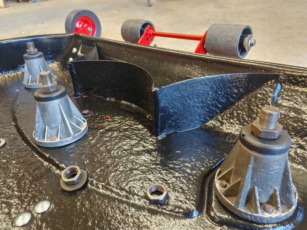

HalfpipeKermit 3 #1 Posted April 7, 2024 Hello, just starting my Wheel Horse journey and had a couple questions to get me up and running ASAP. Just picked up my first Horse, a '87 414-8 came with a 42" SD deck. It has been somewhat restored/repaired. I have not ordered the blades for it yet, as I had a question about the spindles. I noticed the one was different in the threads than the others, and worried about the difference allowing slop in the figment and causing vibration. Any insight on that is appreciated, if its no worries or something needs to be swapped out. Also attached is a photo of me and my son! He loves our evening rides. Thanks for looking. 2 1 Share this post Link to post Share on other sites

cleat 9,401 #3 Posted April 8, 2024 I think that one spindle missing the threads may have been ran with a loose nut and the blade spun on it wearing the threads away. While it will work as is I would likely replace the shaft in the spindle as the blade will likely never sit centered and may vibrate. You could just put well balanced blades on it and see if it runs smooth and go from there. Share this post Link to post Share on other sites
76c12091520h 4,291 #4 Posted April 8, 2024 3 hours ago, HalfpipeKermit said: Hello, just starting my Wheel Horse journey and had a couple questions to get me up and running ASAP. Just picked up my first Horse, a '87 414-8 came with a 42" SD deck. It has been somewhat restored/repaired. I have not ordered the blades for it yet, as I had a question about the spindles. I noticed the one was different in the threads than the others, and worried about the difference allowing slop in the figment and causing vibration. Any insight on that is appreciated, if its no worries or something needs to be swapped out. Also attached is a photo of me and my son! He loves our evening rides. Thanks for looking. The spindle shaft on the far right is toast. At one time the blade that was on it it was loose and was slipping causing it to wear the shaft away. Share this post Link to post Share on other sites

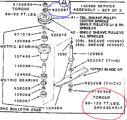

JoeM 10,317 #5 Posted April 8, 2024 5 hours ago, cleat said: I think that one spindle missing the threads may have been ran with a loose nut and the blade spun on it wearing the threads away Before you toss that spindle, I have replaced the thin washer #920257 on the top of the blade with a thick one allowing the blade to center on the shaft. The most obvious thing is to make sure the blade is tight. Torque spec circled in red. New nuts are available and are advised. One other thing I do is replace the grade 8, 5/8 lock washer circled in blue #920087, helps keep tension between pulley and spindle. 1 Share this post Link to post Share on other sites
HalfpipeKermit 3 #6 Posted April 8, 2024 5 hours ago, JoeM said: Before you toss that spindle, I have replaced the thin washer #920257 on the top of the blade with a thick one allowing the blade to center on the shaft. The most obvious thing is to make sure the blade is tight. Torque spec circled in red. New nuts are available and are advised. One other thing I do is replace the grade 8, 5/8 lock washer circled in blue #920087, helps keep tension between pulley and spindle. Good idea, I will try that first and see if it cant get me up and running. Thanks for the diagram Share this post Link to post Share on other sites
