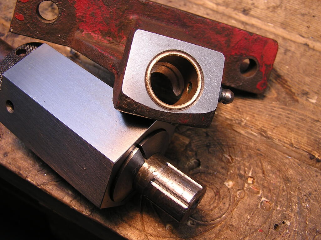

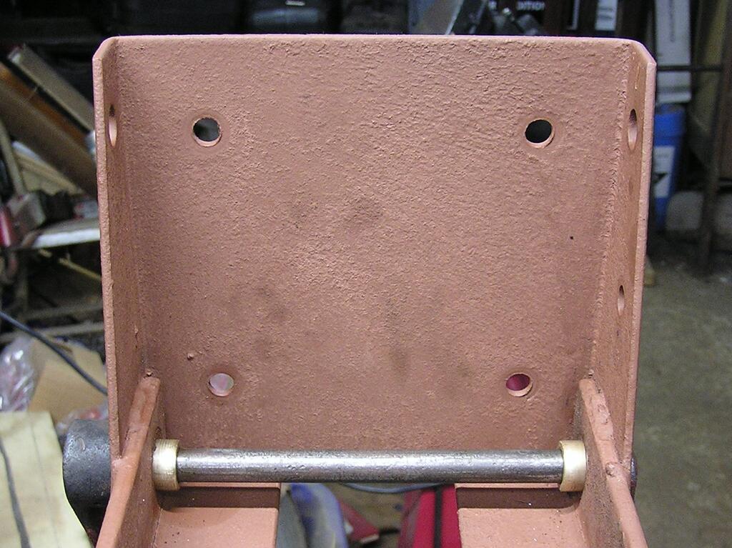

ri702bill 8,996 #1 Posted April 7, 2024 (edited) Just throwing this out there, As some of you know, I do my own repair / upgrade machining on my Horses. Mostly adding bronze bushings in steering blocks, front axle pivot & spindle bores, lower thrust washers for the same, clutch rod frame bushings. The typical places that get wornout by metal-to-metal contact over time. So, if you wish to inquire about the costs involved for a specific repair, send me a PM. Edited April 7, 2024 by ri702bill 5 1 Share this post Link to post Share on other sites

ebinmaine 70,802 #4 Posted April 7, 2024 The steering pillow block repair would be of interest to me at some point. 1 Share this post Link to post Share on other sites
ri702bill 8,996 #5 Posted April 7, 2024 (edited) 37 minutes ago, ebinmaine said: The steering pillow block repair would be of interest to me at some point. Thanks - makes the old ones without any bushing better than new as supplied.... best part is that they are store bought off the shelf items. If they ever need replacing, knock them out, press in the new one..... Edited April 7, 2024 by ri702bill 1 Share this post Link to post Share on other sites

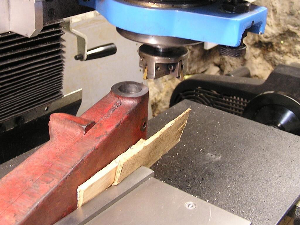

kpinnc 13,789 #6 Posted April 7, 2024 1 hour ago, ri702bill said: Thanks - makes the old ones without any bushing better than new as supplied.... Question on that Bill: Looks like you mill some of the cast iron housing away in your pic above. I would think that allows the steering shaft to seat slightly lower. Does that create a tighter gear mesh as well? I'm thinking that would be even more improvement... 1 Share this post Link to post Share on other sites
Lee1977 7,044 #7 Posted April 7, 2024 (edited) I have done both the clutch shaft and the PTO shaft on my C-120/180. Yes axles and steering blocks, you meed a milling machine. Edited April 7, 2024 by Lee1977 3 Share this post Link to post Share on other sites
ri702bill 8,996 #8 Posted April 7, 2024 (edited) 2 hours ago, kpinnc said: Question on that Bill: Looks like you mill some of the cast iron housing away in your pic above. I would think that allows the steering shaft to seat slightly lower. Does that create a tighter gear mesh as well? I'm thinking that would be even more improvement... I flycut the top surface just to clean the wear and to make it truly perpendicular to the bushing. Look at any used OE block, there is maybe a third of a circle of wear around the hole. Not clearly visible there is a SECOND grease fitting down below to allow you to grease the lower steering shaft.... Edited April 7, 2024 by ri702bill 1 2 Share this post Link to post Share on other sites
