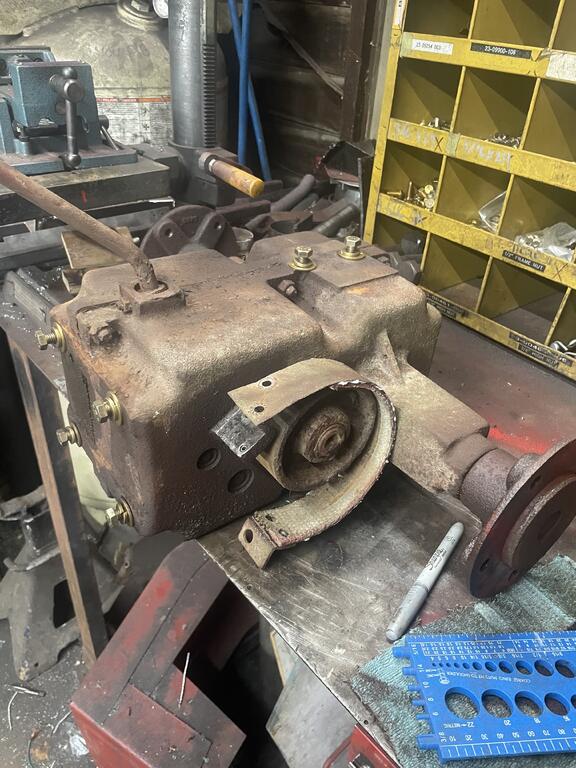

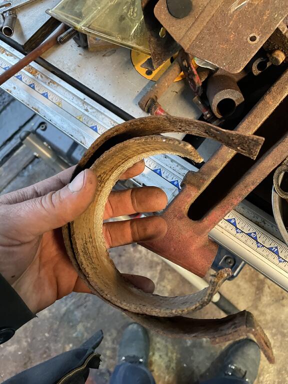

Diesel Actual 4 #1 Posted March 29 How does one reattach this pad ? I can only form new pads to buy. Not a complete assembly Share this post Link to post Share on other sites

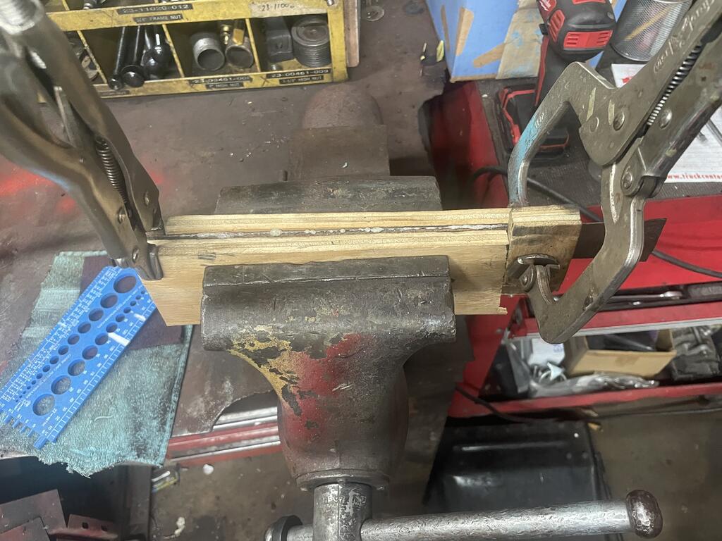

rmaynard 15,308 #2 Posted March 29 Clean both the lining and band. Let them dry. Apply Goop or 100% silicone adhesive and clamp until dry. Or buy a new lining, or buy a complete new brake band. I sell linings, K&B Horse Parts (vendor) sells reconditioned bands. 1 1 Share this post Link to post Share on other sites
rjg854 11,247 #3 Posted March 29 I used gorilla glue on mine. Clean up the steel band and the pad. You can either clamp it in multiple places or what I did. I put it back on and set the brake. Left it 24 hours and its still there 2 years later. 1 1 Share this post Link to post Share on other sites
Al C. 1,426 #4 Posted March 29 I replaced the brake pad a few years ago Used Goop adhesive and zip ties. Worked well. 4 2 Share this post Link to post Share on other sites
daveoman1966 3,738 #5 Posted March 30 Instead of using all the nylon ties to clamp the brake PAD to the BAND: (1) Remove the brake DRUM. (2) Apply epoxy (JB Weld) to brake BAND and PAD. (3) Quickly CLAMP them to the brake DRUM using a couple large 'C' clamps. (4)wipe away excess epoxy. (5) Let dry as needed. (6) remount brake DRUM and fresh BAND to the trans case. 1 Share this post Link to post Share on other sites

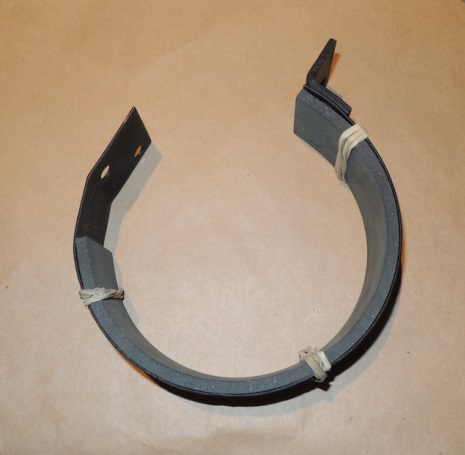

rmaynard 15,308 #6 Posted March 30 Everybody has rubber bands. Keep it simple. 1 Share this post Link to post Share on other sites
