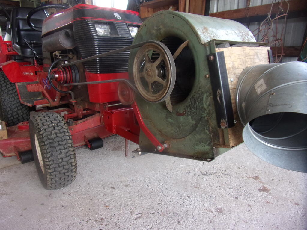

87 416-8 horse 423 #30 Posted March 28, 2024 I had the exact same blower on mine. I had a little smaller pulley that I put on it and that was a bad idea. The drum ended up in pieces. Also make sure you have a big enough outlet because I only had a 6 inch 90 and that didn't help. For the tensioner I used the weight of the blower and I had no wobble. Share this post Link to post Share on other sites

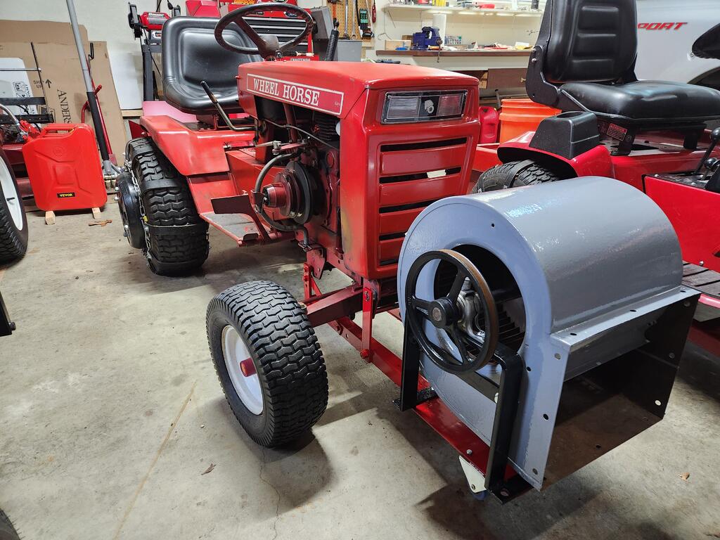

Racinbob 11,726 #32 Posted April 3, 2024 I'm really happy with the way it's coming together. I changed my mind about using angle to extend the frame and used the flat plate that was on the frame. This thing is heavy. To make things easier I added casters, two fixed under the blower and one go-roundy in the rear. The idler is going to be duck soup. A rope measurement tells me that 68" is a good start. I have a trip to town scheduled for Friday to pick up a few things. Since you guys talked me into an 8" discharge making a custom piece will be less beneficial so I might just pick up over the counter tinwork for it. I'll pick up an 8" to 6" reducer just to experiment. 4 3 Share this post Link to post Share on other sites

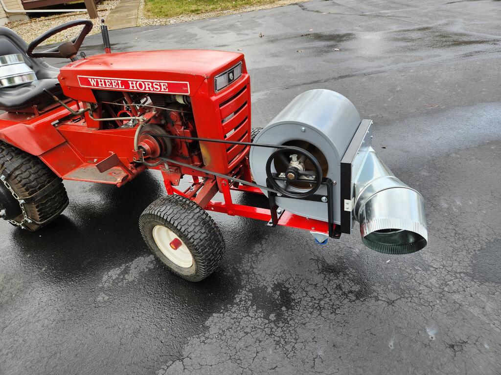

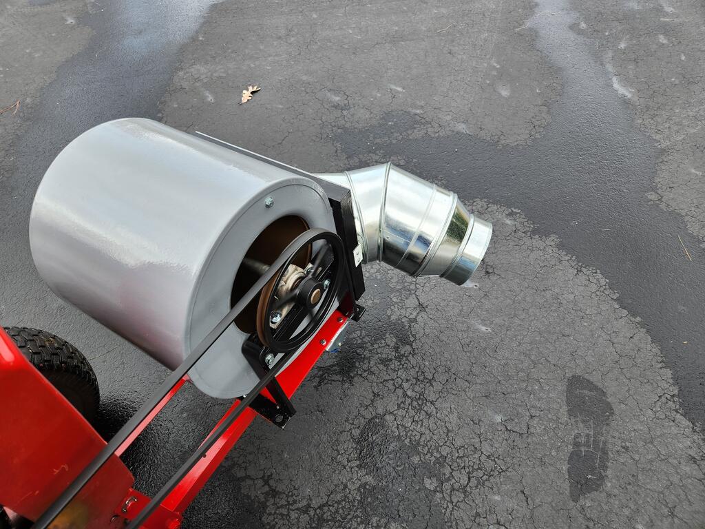

Racinbob 11,726 #33 Posted April 12, 2024 Got her done! A 72" belt was perfect without a tensioner. There's about 1/2" adjustment available where the pillow blocks mount to the frame. I really couldn't give it a good test because the leaves are drenched. I'm glad I started with 8" but I'm sure I'll want to take it to 6" (second pic) to increase velocity and I'll experiment with 4". Based on pulley sizes at wot it should be spinning at about 1800 rpm. It moves a lot of air but it also seems to be loafing. As heavily built as this is I think I could safely get more. I'll experiment with the velocity first. 2 9 Share this post Link to post Share on other sites

Racinbob 11,726 #40 Posted April 14, 2024 Here's the verdict. I had to go to the edge of the woods to get to enough leaves which made them somewhat harder to move. I ran a pass with the three options, 8", 6" and 4". The clear winner was the 6". Actually by quite a bit. My theory. Leaf blowers are rated by MPH and CFM. I have two and both of them have nozzles that will give them more 'power' by reducing down and increasing the velocity. But they are designed from the ground up to be leaf blowers. This tractor blower isn't designed to be a leaf blower. My thinking is that a squirrel cage blower isn't designed for high velocity. It's designed to move air through a home system with minimal restriction. I'm thinking it needed to be a compromise. Starting with the style sheetmetal fitting with the 8" outlet I used I believe I picked up about all the volume that the blower offered. Reducing it to 6" definitely increased the velocity and it didn't seem to hurt the volume all that much. Going down to 4" really choked things up. I'm going to go ahead and swap the 8" pulley for a 6". That will let me experiment with a higher blower rpm as well as allowing me to reduce the engine rpm some. 2 Share this post Link to post Share on other sites
