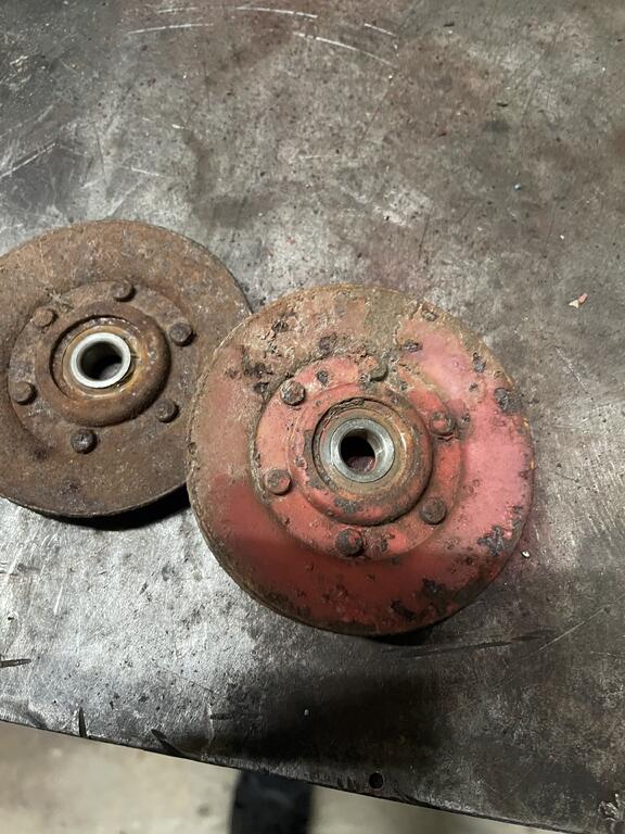

I need to switch the bearings in this idler puller. Is anybody know what size bearing it is? I have looked all over the site and can’t find anything about switching bearings in a idler puller.its from a 500 special

That is not a bearing that you would normally replace, you would buy a whole new pulley assembly. The pulley can be drilled apart where the 6 rivets are and then the bearing could be removed if you wanted to go that route.....find a new bearing based on measurements or the the numbers on the side of the bearings, and then come come up with hardware to reassemble the pulley.

Like 76c said the best way is to remove and measure the bearing and get the numbers. Either drill or slice. There is nothing to precise about those stamped pulleys other than they are way over priced.
I like making slices in the housing and pressing out the bearing cause it takes much less time and requires no fasteners. Some drill out the rivets or spot weld and replace with bolts.
Just a guess, that is a 1 3/8 od bearing with a 5/8 bore.???
Slicing technique.

I guess I just buy a new one.  I had a feeling I would have to remove rivets.  Such an odd design . Thank you

The brarings can be relaced, it's not an easy job on the vee idlers they are also welded in the groove. The flat idlers are a lot easer most are now spot welded together, just drill out the spot welds.
I drill a smal reference betweeh the spot welds first as the holes are going to be a little off.

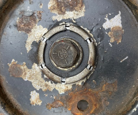

This is what I see for the 1623
V-idler pulley - 3.062" OD - 1623 replaced by 92-7102 (Generic 1614ZZ bearing Used in belt idler for 5-2321 deck) 3.0625" OD x .375" ID
