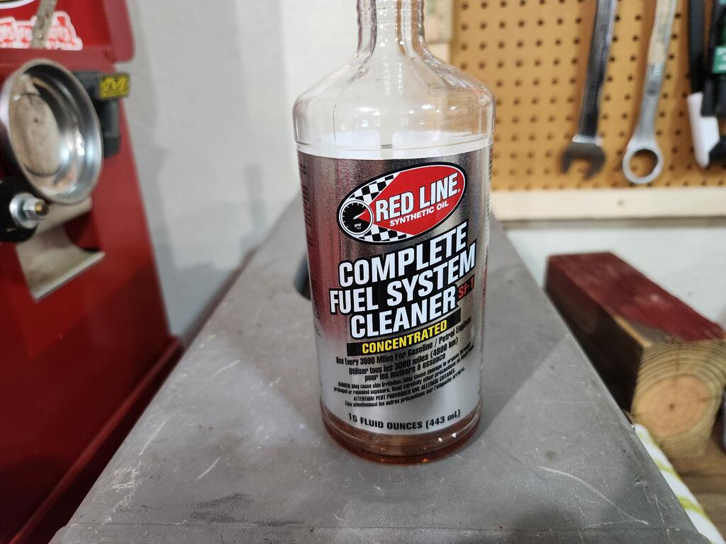

Racinbob 11,768 #29 Posted March 27, 2024 I more of a no additive dude but I have used Sea Foam a few times in small engines. Sometimes it seemed to help, other times there was no change. There is one product that worked well for me. The check engine light came on in my wifes car. The code indicated something in the fuel system needed cleaning or was faulty. Systematically I went through everything one at a time and reset the light each time. Every time the light would come back on in a few miles. I pretty much had it narrowed down to the injectors which I wasn't going to mess with. The only bright side was that it could likely be the last straw and she'll replace it. It's been nothing but trouble since she drove it off the showroom floor. I even made hint of warning her. But, as a last resort, I read up on a bunch of fuel system cleaners and decided to try this. It's kinda pricy but I liked some of the things I read. I waited until she was down on fuel and dumped it in. She drove it to Valpo to shop and then refueled. When she got home I reset the light. That was last summer and the light hasn't come back on. She said the car even seemed to run better. Is this stuff the reason Share this post Link to post Share on other sites
kpinnc 13,846 #30 Posted March 27, 2024 48 minutes ago, Racinbob said: It's kinda pricy but I liked some of the things I read. From what I've read, Redline makes some good stuff. Particularly oils and additives for it. Share this post Link to post Share on other sites
