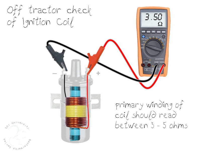

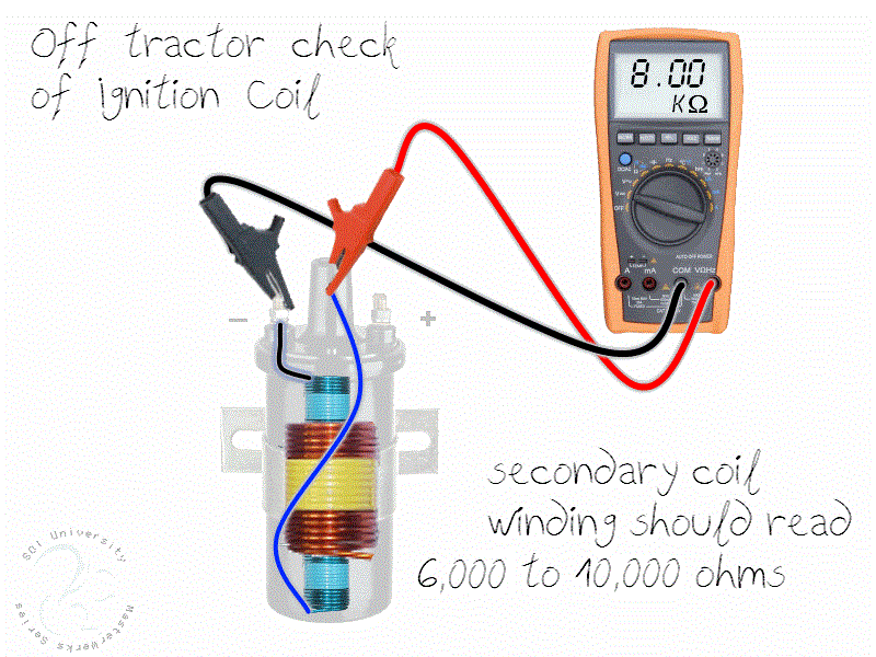

953 nut 56,742 #8 Posted March 25, 2024 Here are a couple of coil tests that were posted years back by @Save Old Iron that work well. 2 1 Share this post Link to post Share on other sites

Ponyboy 64 #11 Posted March 28, 2024 Thanks for all the replies! I went out and removed the coil from my K181 and set my multimeter to ohms. Checking both the primary and secondary windings, the number never changed from 1, regardless of what ohms setting I was on (I have settings from 200 to 20M Ohms). Is that a sure sign to get a new coil? Would/could a coil just go out during a regular mowing run (and if not, is there something else I should be looking at)? I'm assuming there's some sort of liquid (oil?) that's supposed to be in the coil, correct? I never noticed before, but it sloshes when you shake it. No leaks or anything, just heard it slosh when I was carrying it to the barn to test. And to answer squonk's question, engine sounds just fine/normal when churning (the normal WHOOMPA). And lastly, any good sources for a new coil? I got this one from I Save Tractors about 2 years ago, maybe has 16 hours on it. I can do some searching but curious what others on here use. Share this post Link to post Share on other sites
