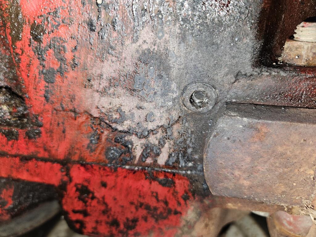

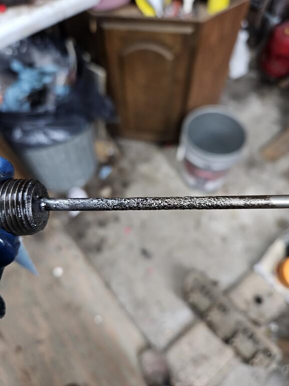

So I have a stripped drain plug on a raider 12. I guarantee the fluid was never checked because I had to heat the dipstick to get it out, it was so pitted and rusty! So the drainplug I heated and got an impact on and no go. So I got a big breaker bar on it and that's when it stripped. The trans is full of what looks like peanut butter and it leaks out the axles and brake shaft. Thoughts on my next move?

You could tap a torx bit into that drain plug, or weld a nut to it and try backing it out.  Sometimes with pipe fittings, you can’t loosen it but you can still tighten it.  If you can get it to rotate right first, then it’ll spin left.
Gary S Minnesota
I had also stripped the drain plug using an impact wrench.  Tried using a spiral bolt extractor. No luck.  Then I used a left hand drill bit and inadvertently drilled all the way through—oil started dripping!  From there I simplify drilled the rest of the plug body out and tapped new threads. Carefully flushed tranny several times and used a round magnet to trap any steel filings I may have created.  Installed a bolt with a head and gasket.  I can put a box end wrench on in the future.  Downside is the Bolt head protrudes below the transmission housing.  It is not flush like the original, but I don’t have any implements that it interferes with.
If I had a welder handy, welding a nut to the plug would have saved me a lot of grief.  A small flux welder is now on my list of next purchases.
