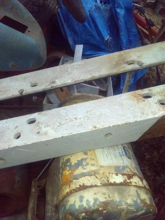

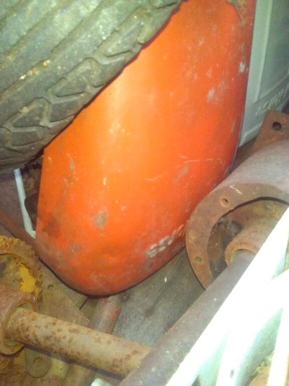

uglyblue66 114 #1 Posted March 17, 2024 (edited) I have a couple older horses, my first tractor purchase ever, what I think is a 58 rj and a 60 suburban. both apart. Both transmissions apart but all there with a extra. the 1 i think is a 58 only has a very short "notch " for the lift lever,not even a half moon. the 60,a full half moon notch system. I have had this stuff bundled together on a pallet for a fellow that was looking to buy it all but that has been a while.long enough that i am starting to think i may not should get rid of my first ever wheel horse or tractor a second time. What I am looking to find out is ,is there a list of bearings for the transmissions so I could just sit down and order them? it would save a lot of measuring and guessing.Also I am looking at possiablly doing 3 transmissions at the same time, so i would be getting all the bearings at the same time and doing each step on each 1 , that way all of them will be done and the rest of the tractors are a breeze to do after the trans is out of the way. also,how hard would it be to find a lift lever for the 58? I may have it and just didn't locate it when I was looking up all this stuff. I am also looking at getting a 3rd 1 that is complete but very rusted and the trans is stuck. it is factory electric start, Can't remember ,I think it is a 60. Also, the first photo is the front of the hood of what I think is the 58, and the frame,which holes are the factory holes? When I got this machine in 1990 it had a 7hp briggs and on it and would flip over on top of you at the drop of a hat. Edited March 18, 2024 by uglyblue66 Share this post Link to post Share on other sites
