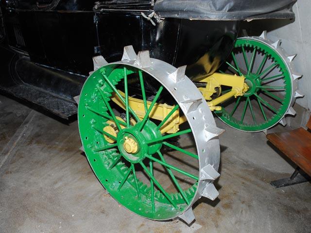

953 nut 56,742 #1 Posted March 16, 2024 The Thrifty Farmer Tractor Conversion Kit The Thrifty Farmer kits sold by Sears, Roebuck & Co. in the 1930s promised to make your old Ford Model T or Model A into a tractor for less than $100. Later, kits became available for the 1929-31 Chevrolets. The kits were listed in Sears spring and fall catalogs from 1932 to 1941. By 1935, Sears had added kits for newer Ford V-8 powered cars along with Plymouth, Dodge, and Chevrolet autos with 6-cylinder engines. The kits were produced by Peru (Illinois) Wheel Co., A 1932 Sears Thrifty Farmer booklet notes that, “With the Ford body removed, and without drilling a single hole, you can in a few hours convert the old Ford into a tractor that has the pulling power of two to four horses, depending on the condition of the motor.” The working speed of the engine after the tractor conversion was 1,200rpm. The motor in a new 1928 Model A was rated at 40 brake horsepower at 2,200rpm. The final drive system on the early kits was somewhat complex, employing a jackshaft and a series of four gears on each rear wheel. The gears are mounted “high off the ground away from loose soil and trash” and are “covered on top and sides by a strong steel hood to keep out mud and protect the operator.” Within two years, Sears released a less complicated version of the kit. Transferring power to the rear wheels now employed nine-tooth pinion gears, attached to each rear axle, which engaged large diameter ring (bull) gears mounted on each wheel. The rear end (differential) of the car had to be flipped, end for end, as part of the assembly process. If it weren’t flipped, there would be three reverse speeds and one very slow forward. Peru Wheel Co. also supplied kits to Montgomery Ward & Co., called a Utility Tractor Unit, a few years before they began supplying a very similar kit to Sears. The main differences in the two kits were the diameters of the bull gears and rear wheels. The Sears gear measured 37 inches in diameter with 108 teeth, while the Wards gear was 40 inches and 120 teeth, mounted on 45-inch and 50-1/2-inch wheels respectively. Since Montgomery Ward part numbers were cast into the bull gears and the axle clamps used by both large retailers, people were often misled as to which kit was used to build a particular tractor. Early conversion kits were sold before 1920. Ultimately, more than 100 kit manufacturers operated coast to coast. Some of the brands available in the U.S. and Canada included Staude, Knickerbocker, Shaw, and OTACO. The front wheels, supplied in the kit, had non-skid attachments. The two attachments were formed of arc-shaped sections of 1-3/4-inch angle iron, each covering half the wheel. When bolted on, they formed a narrow steel rib in the center of the wheel. That made steering easier, especially in loose soil. 11 2 4 Share this post Link to post Share on other sites
