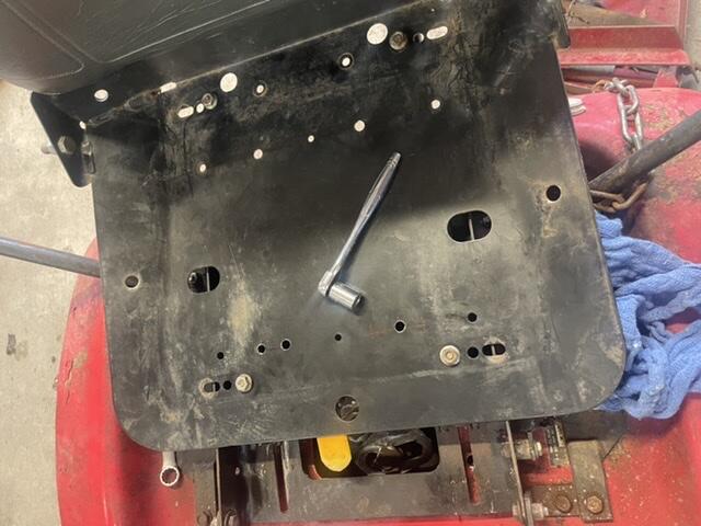

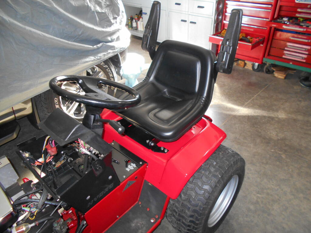

AHS 1,482 #1 Posted March 15, 2024 Hi there, so the seat pan rubs heavily on the slide part; making it unable to slide….. what am I missing?? All i can think of is 4 grommets on those bolts, to raise it up off the slide part. Share this post Link to post Share on other sites

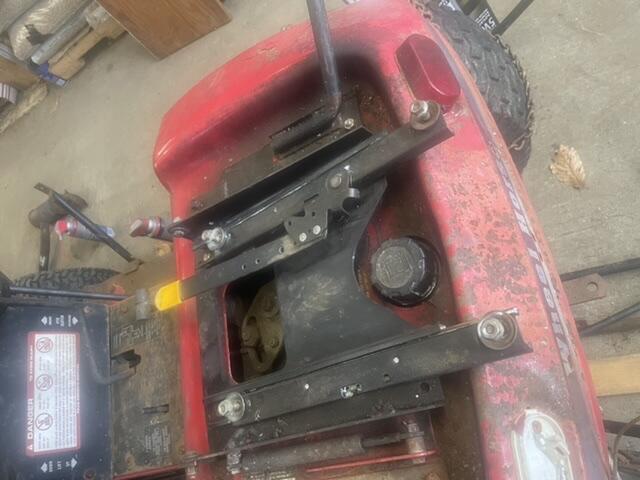

JCM 9,916 #2 Posted March 15, 2024 Looks like an 88 or 89 WH. Obviously the seat is not a WH seat. The slide mechanism looks to be upside down ? and not OEM. The slide lever I think is usually on the left side.The yellow rubber cover is for another brand I assume. 1 Share this post Link to post Share on other sites
JoeM 7,885 #3 Posted March 15, 2024 Looks like two different ways the seats mounted. With seat springs or with the adjusters that had spacers. IDk the height of those spacers maybe someone here will know. Share this post Link to post Share on other sites

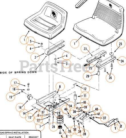

AHS 1,482 #4 Posted March 15, 2024 I’m missing part number 25, interesting. Hhmmm Share this post Link to post Share on other sites
AHS 1,482 #5 Posted March 15, 2024 1 hour ago, JCM said: Looks like an 88 or 89 WH. Obviously the seat is not a WH seat. The slide mechanism looks to be upside down ? and not OEM. The slide lever I think is usually on the left side.The yellow rubber cover is for another brand I assume. I don’t know. It looks to be factory. Yes, its an 89. 520H. @cleat you would know? Share this post Link to post Share on other sites
lynnmor 7,479 #6 Posted March 15, 2024 #25 is a thick plastic spacer, I made some to replace the original, they are approximately 5/16" thick. Share this post Link to post Share on other sites
cleat 6,858 #7 Posted March 16, 2024 Do you have the big seat springs #2 ? Share this post Link to post Share on other sites

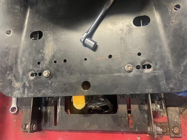

AHS 1,482 #8 Posted March 16, 2024 @cleatNo, they WERE on there. Could that be why its sliding so hard. The seat slider, a stud. The seat, a nut. Which hold two pieces of steel together…. I mean of course it wont budge! Not without a stack of washers or a grommet to keep the two pieces of steel apart. You see what i mean? Share this post Link to post Share on other sites

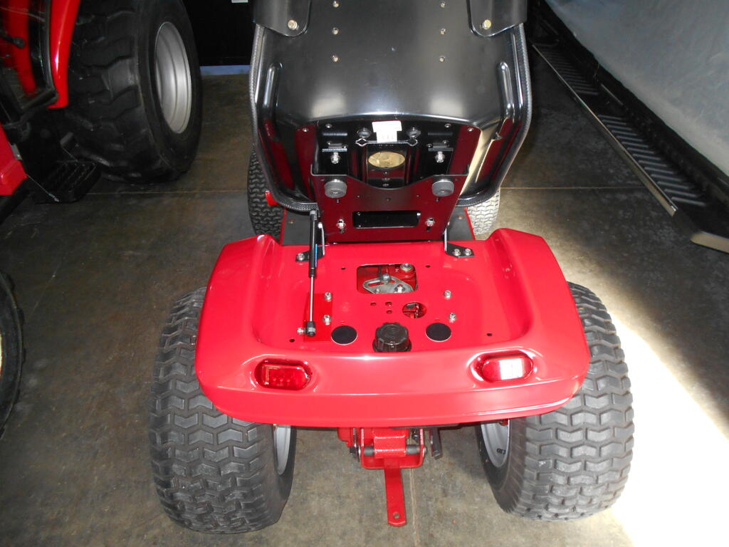

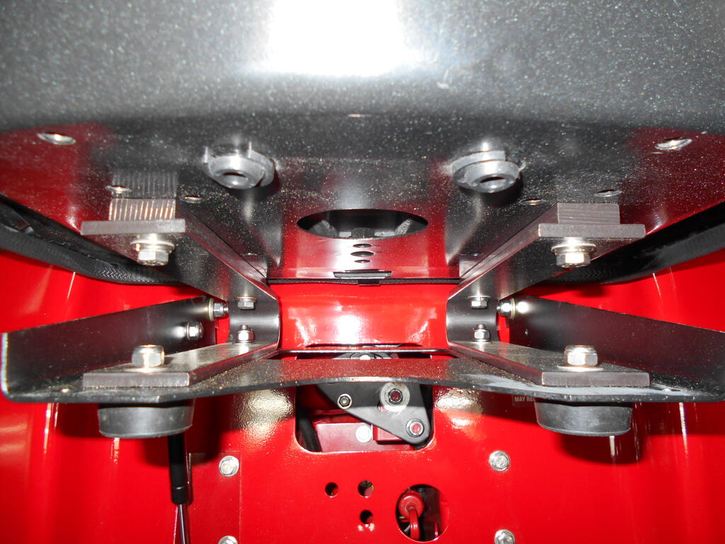

cleat 6,858 #9 Posted March 16, 2024 I take the seat slides off and install these spacer / adapter plates. With the seat springs all the way back in their slots I seem to have plenty of leg room. Share this post Link to post Share on other sites
peter lena 8,970 #10 Posted March 16, 2024 @ AHS your initial picture of seat frame over the edge of fender says it all for me , also agree with @cleat on the spacers , personally went with https://www.google.com/search?q=vibration+mount+pads&rlz=1C1CHBF_enUS866US866&oq=vibration+mount+pads&gs_lcrp=EgZjaHJvbWUyBggAEEUYOTIICAE on my stuff , when you set up any seat , look at it from every angle , also front of seat height is vital , drop it for more leg / waist space . sold a horse that was a train wreck , had a terrible seat / set up . personally do not use those , long seat base angle mounts , once seat is front bracketed , I use singular compression springs , in seat threaded holes . like I said , look at it from the side , to sum up what you have to do .https://www.google.com/search?q=vibration+mount+pads&rlz=1C1CHBF_enUS866US866&oq=vibration+mount+pads&gs_lcrp=EgZjaHJvbWUyBggAEEUYOTIICAEQABgWGB4yCAgCEAAYFhgeMggIAxAAGBYYHjIICAQQABgWGB4yCAgFEAAYFhgeMggIBhAAGBYYHjIICAcQABgWGB4yCAgIEAAYFhgeMg0ICRAAGIYDGIAEGIoF0gEJMTUyMjZqMGo0qAIAsAIA&sourceid=chrome&ie=UTF-8 , my seat set ups , pete Share this post Link to post Share on other sites
AHS 1,482 #11 Posted March 16, 2024 OK!!! I have the seat of a zero turn and the bracket’s, which has no springs and hits the seat pan. The original had big springs. (I can see the imprints in the seat pan). Wow! Sorry, my bad! Share this post Link to post Share on other sites
