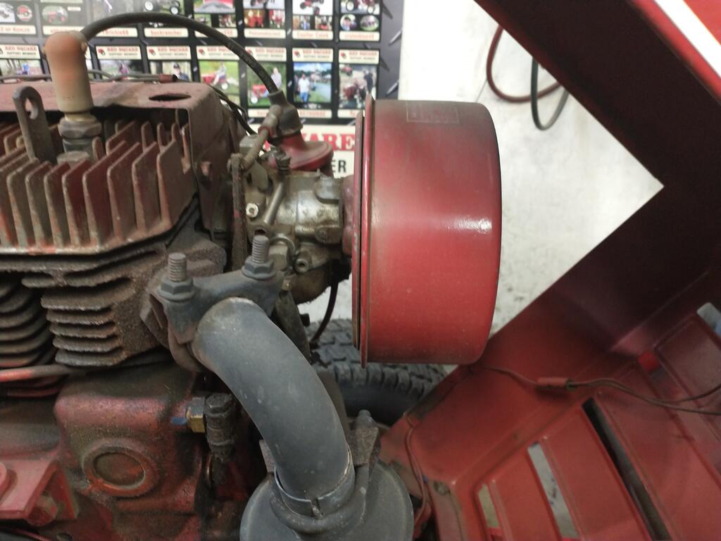

@BHpa I don't have a Magnum here so I don't know what kind of housing they use . The 3" filter normally comes in a housing like this

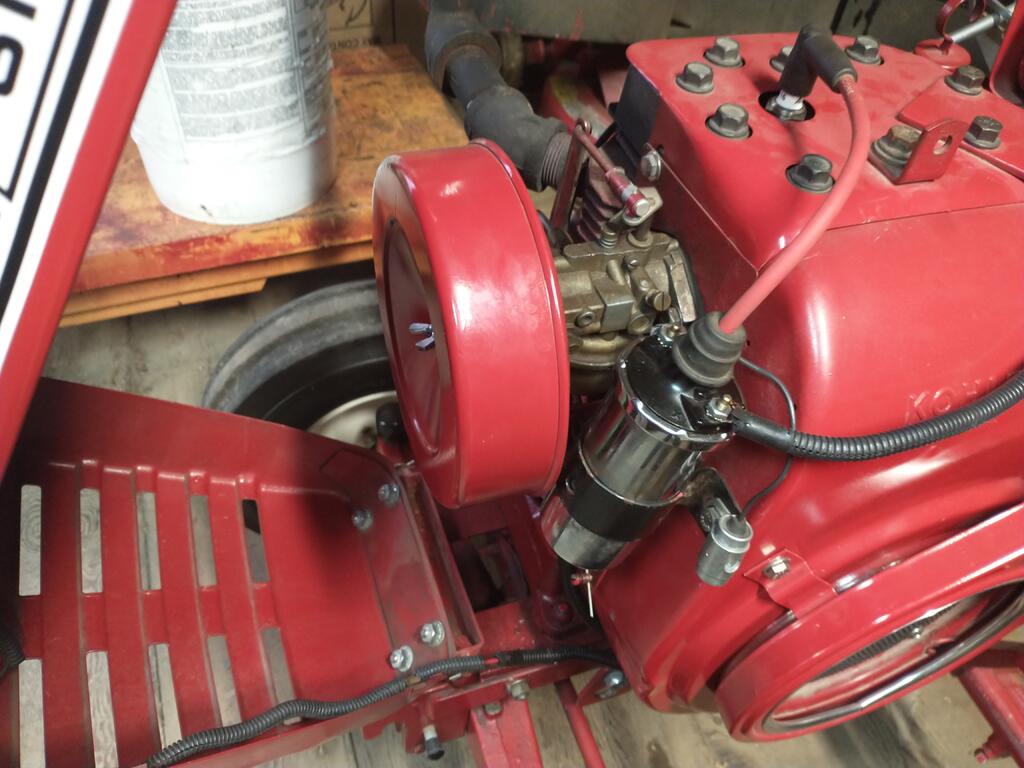

And the 1.75" filter comes in one like this

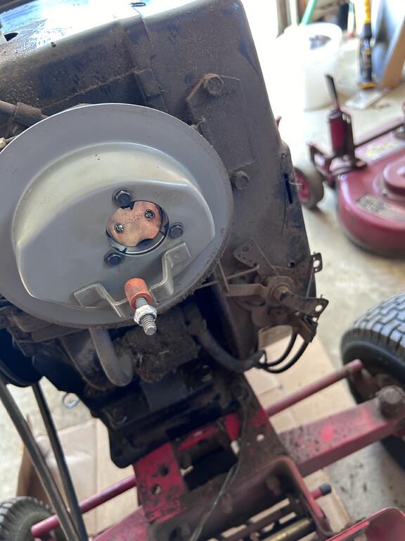

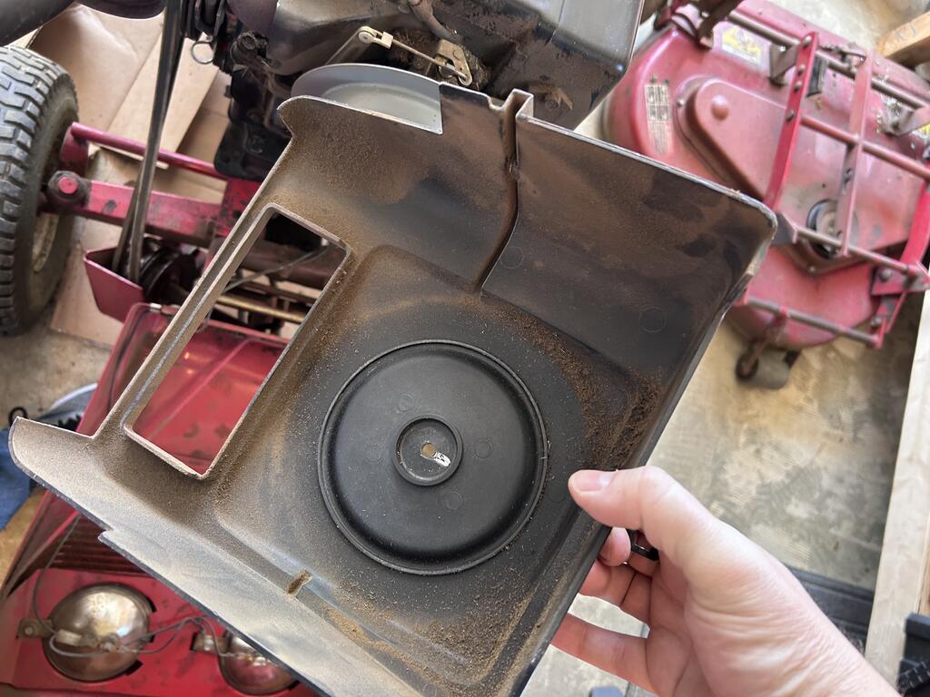

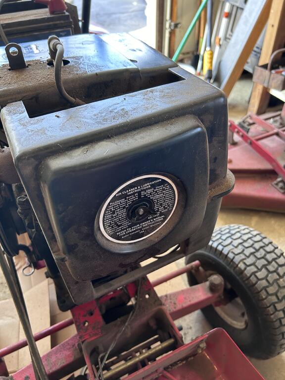

Here is the housing on mine:
IMG_3348.jpeg.b2ad1b274c299f135ec1d94abbe6ec14.jpegIMG_3347.jpeg.49c4b871d09fd0519e63bed7b3e81825.jpegIMG_3346.jpeg.1198d470e8a1122cc6d37e062fff987f.jpeg

Yes. The plastic cover doesn't pull down far enough to seal the filter.
