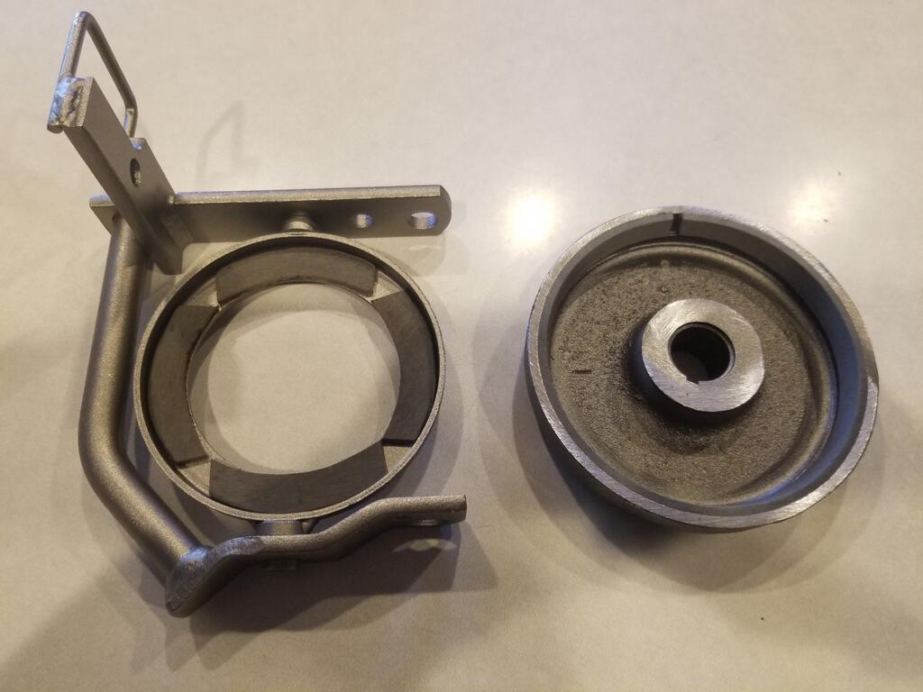

Wild Bill 633 866 #12 Posted March 14, 2024 (edited) 16 hours ago, ranger said: I came across a number of sellers offering the pto clutch plate, also made in China! I had Brake Materials & Parts Inc. in Ft. Wayne, IN reline a Simplicity PTO cone clutch ($35) and brake ($30) plus shipping. Total cost ended up being about $50 each. Call before hand. Scott is a very nice man to deal with. Another is Industrial Brake & Clutch in Seminole, FL. Edited March 14, 2024 by Wild Bill 633 1 Share this post Link to post Share on other sites
squonk 42,505 #13 Posted March 14, 2024 12 minutes ago, Wild Bill 633 said: I had Brake Materials & Parts Inc. in Ft. Wayne, IN reline a Simplicity PTO cone clutch ($35) and brake ($30) plus shipping. Total cost ended up being about $50 each. Call before hand. Scott is a very nice man to deal with. Rochester Clutch and Brake is another good one. https://www.rochesterclutch.com/ 1 Share this post Link to post Share on other sites
