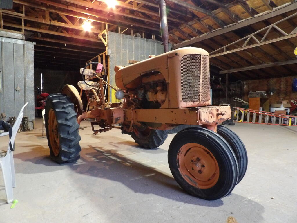

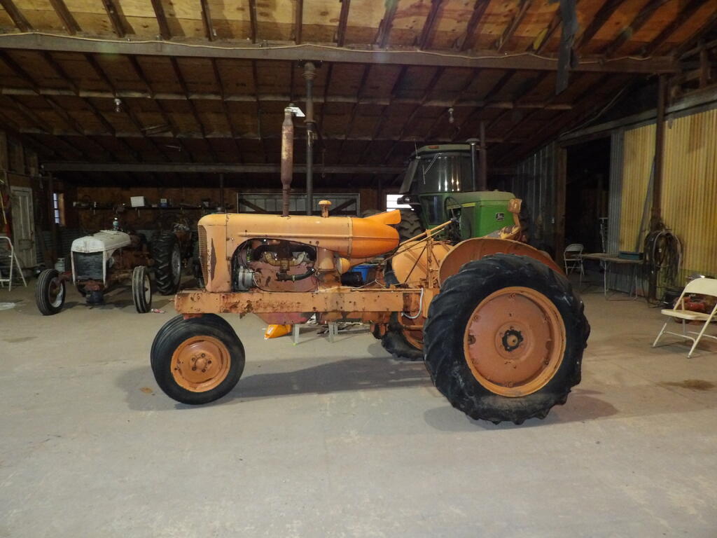

ClassicTractorProfessor 5,363 #1 Posted March 10, 2024 Picked up this 1946 WC last weekend from a friend of mine, finally got it to the farm and off the trailer into the shop this evening. He had it running a week ago, but today when I went to start it it seems we have lost spark, probably tinker with that some tomorrow and see if I can get it running, then will have to bite the bullet and buy at least one tire for the rear, and maybe see a little mowing duty this summer while I do some needed repairs on the Farmall C 6 9 Share this post Link to post Share on other sites

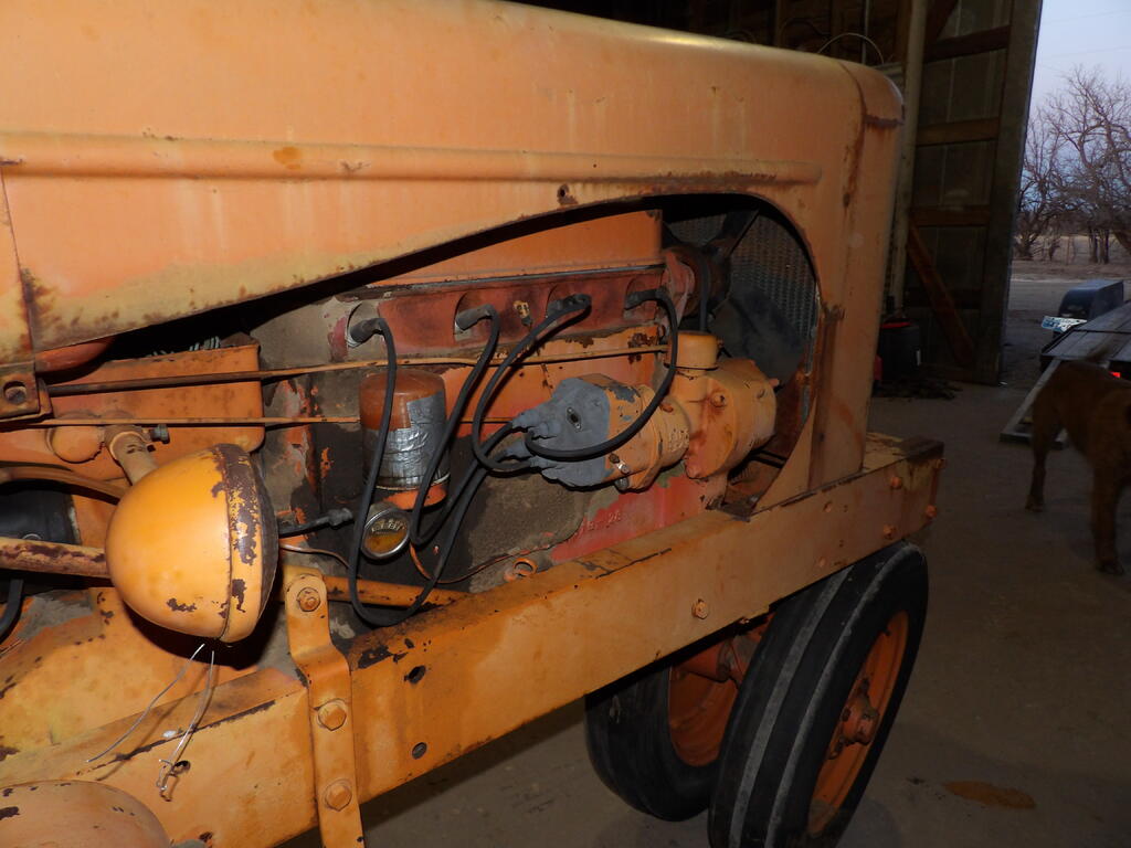

squonk 41,781 #4 Posted March 10, 2024 (edited) Mag ignition. Points prolly got some Caa-Caa on them. My dad had a 39 B that would start if you just looked at it. We tested the mag and it threw a spark almost a foot long. One day it failed to start. Governor gear decoded to "retire" Edited March 10, 2024 by squonk 2 Share this post Link to post Share on other sites

ClassicTractorProfessor 5,363 #7 Posted March 11, 2024 19 hours ago, pfrederi said: Good luck on the tires.... Having new sneakers on the M. Had to have the tire Dr. make a house call...pump the beet juice out of the old ones and back into the new. Found that one rim was in bad shape so a new one of those is coming, Tubes tires and rim +/- $1800 plus house call and labor..... 13.6-38s? Yes those are pricey, I priced a pair of 14.9-38s for my M a couple years ago, tires and tubes were right around 1300 and that was my cost through the tire shop I work at. I found a guy in the Tulsa OK area that has brand new 12.4-28s for the Allis for $325 each, not sure how he’s able to get them that cheap but worth the 4 hr road trip to pick up a pair. Messed with the old tractor some more yesterday, discovered a broken impulse spring, swapped mags for another I had on the shelf and we have spark again, didn’t have any gas at the farm so didn’t get to make her run, maybe tonight after work 4 Share this post Link to post Share on other sites

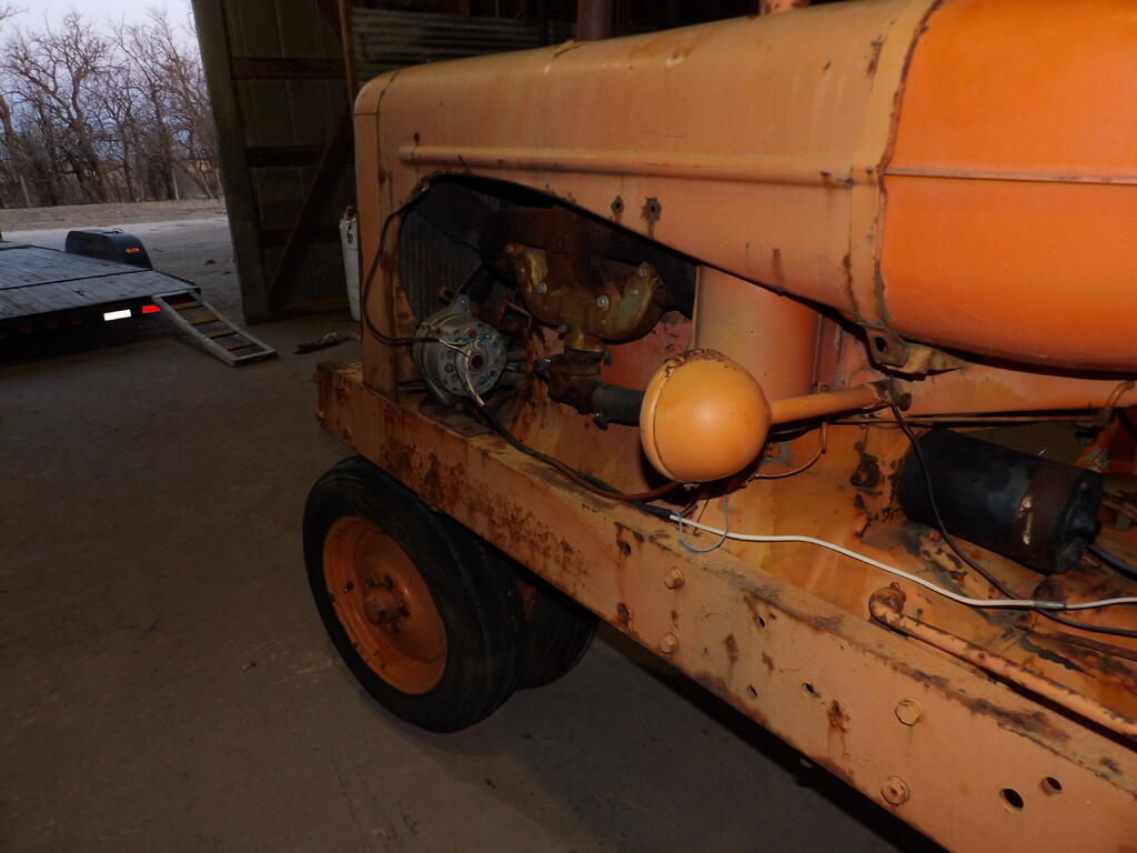

John2189 476 #9 Posted March 13, 2024 (edited) So why is the duct tape on the oil filter? Insulation for the spark plug wire? nice looking tractor Edited March 13, 2024 by John2189 1 Share this post Link to post Share on other sites

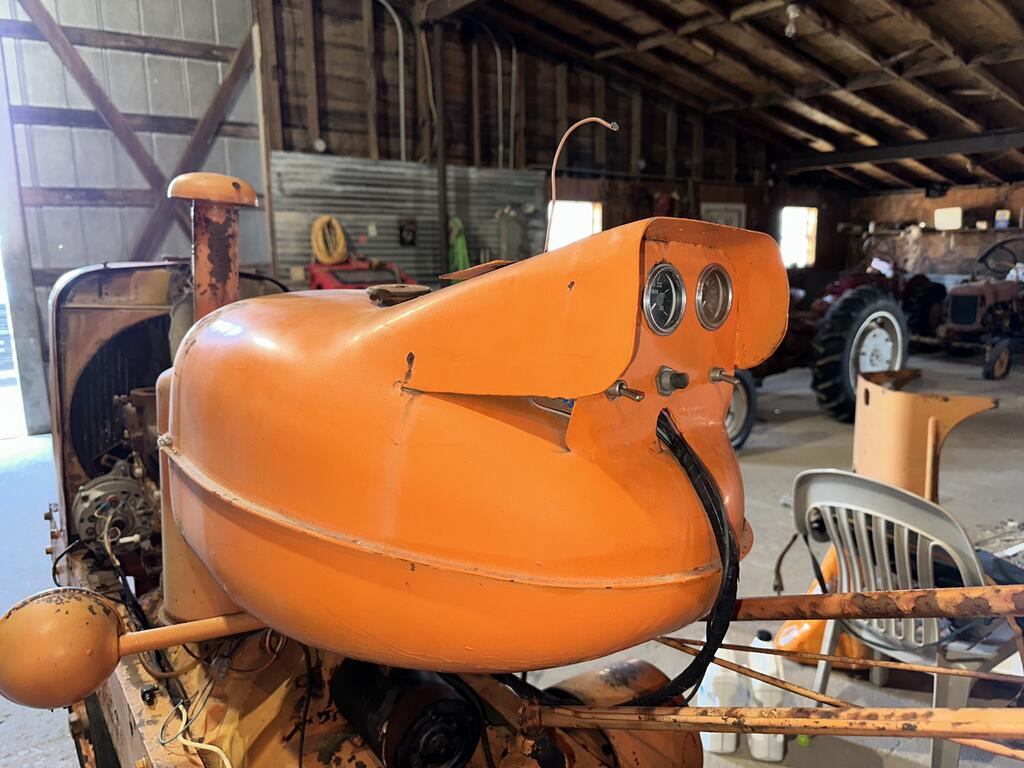

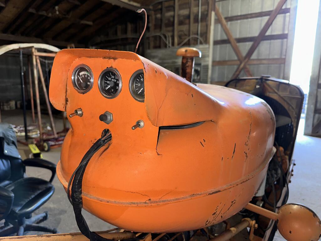

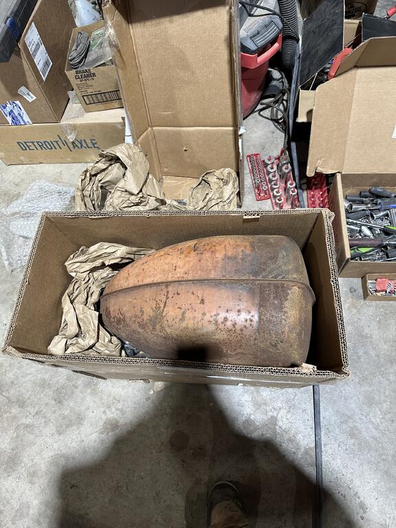

ClassicTractorProfessor 5,363 #10 Posted March 13, 2024 32 minutes ago, John2189 said: So why is the duct tape on the oil filter? Insulation for the spark plug wire? nice looking tractor Previous owner attempt at fixing an oil leak that of course didn’t work, remedied that problem yesterday with a brand new Napa Gold oil filter and 6 quarts of fresh Rotella 15W40 Did get the tractor to run last night for a short time, running it off an IV tank I rigged up, don’t think I was getting enough fuel flow as it would run for a few seconds and die, then start back up and repeat. But we did hear it run so we can keep moving forward, otherwise we would’ve had a $500 yard ornament and photo prop Hearing it fire was the good news, but with every bit of good news around my shop has to come some bad, and the bad reared its ugly head tonight while pulling off the gas tank, it was rusted so bad that with the slightest pressure on a wrench to unhook the fuel line from the sediment bowl and the bowl ripped right out of the bottom of the tank, so now we are on the hunt for a replacement tank. I’ve found several unstyled WC tanks but none for the styled models. Tanks for the WD are plentiful as well, does anyone know if a WD tank will fit a styled WC? Maybe @Pullstart or @ACman can shed some light on this for me Was really hoping to be able to salvage this tank because of the very unique gauge panel built in to it, not sure the story on that, I’ve yet to find any model of tractor with anything like it, but it looks way to clean of an install to be an old farmer add on so I don’t know 1 Share this post Link to post Share on other sites
ebinmaine 69,380 #11 Posted March 13, 2024 5 hours ago, ClassicTractorProfessor said: Was really hoping to be able to salvage this tank because of the very unique gauge panel built in Once something is broken out like that you're at a 0% chance of screwing it up any more than it already is. If you or someone you know has a fair set of metal working skills or wants to experiment, that tank can be rebuilt. Maybe combine the good bottom of another with the top of this one? Share this post Link to post Share on other sites
ClassicTractorProfessor 5,363 #12 Posted March 13, 2024 5 hours ago, ebinmaine said: Once something is broken out like that you're at a 0% chance of screwing it up any more than it already is. If you or someone you know has a fair set of metal working skills or wants to experiment, that tank can be rebuilt. Maybe combine the good bottom of another with the top of this one? That thought crossed my mind, I’m a pretty good welder but never have done much sheet metal work, I’m on the lookout for another tank now to get it running, but plan on putting this one on the shelf and maybe repair it one of these days 1 Share this post Link to post Share on other sites
ebinmaine 69,380 #13 Posted March 13, 2024 1 minute ago, ClassicTractorProfessor said: That thought crossed my mind, I’m a pretty good welder but never have done much sheet metal work, I’m on the lookout for another tank now to get it running, but plan on putting this one on the shelf and maybe repair it one of these days I can see why you would want to try to use that tank being unique like it is. I think it would be a worthwhile experiment to do a stitch weld at the seam in several stages. Pressure tested of course but even if you can't get it perfect you might be able to get a liner in there. Share this post Link to post Share on other sites
Handy Don 12,939 #14 Posted March 13, 2024 7 hours ago, ClassicTractorProfessor said: That thought crossed my mind, I’m a pretty good welder but never have done much sheet metal work, I’m on the lookout for another tank now to get it running, but plan on putting this one on the shelf and maybe repair it one of these days That tank is just plain cool, whoever first made it. I’m adding my vote that you attempt to repair it. You might want to consider brazing it instead of welding. Share this post Link to post Share on other sites
ClassicTractorProfessor 5,363 #15 Posted April 3, 2024 Finally got the replacement tank delivered to the shop today, gonna clean and seal it before installing on to the tractor, but we are one step closer to bringing this one back to life 3 1 Share this post Link to post Share on other sites

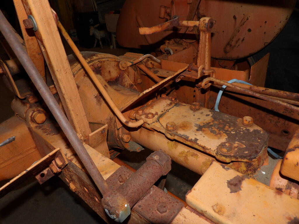

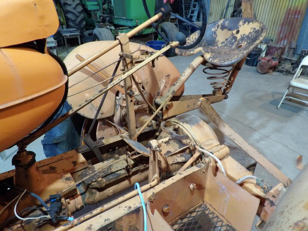

ClassicTractorProfessor 5,363 #18 Posted August 26, 2024 Sad news for the old WC, I tried to push it back out of the way a few nights ago and it wouldn’t move. First though was a stuck brake, but it turned out much worse than that. It’s been put out to pasture for now until we can find the needed parts to repair or a donor tractor. 4 Share this post Link to post Share on other sites
