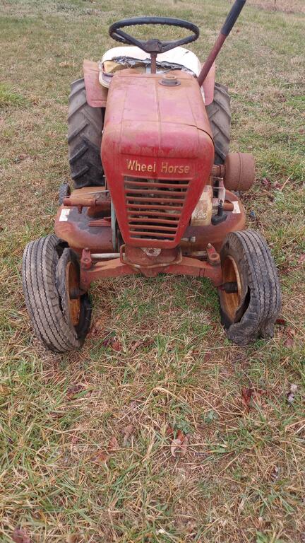

DPrice 24 #1 Posted March 2, 2024 Can't go look at it in person but this front has bugged me. Besides the rod does anything look none factory. 1 Share this post Link to post Share on other sites
D_Mac 9,136 #2 Posted March 2, 2024 You have to consider the age of these machines. Over the years previous owners will have made changes and or modifications to keep them in service. Finding one completely original dosnt come easily or cheaply for that matter. Clearly its going to need some work. Thats the fun part, making them your own. What ever has been done, can be undone. What ever needs to be done, can be done. Its up to you to figure out how much time and money you are willing to part with. I have been known to spend more then I should have on both of these areas on some of my mine. That being said, I have always been very happy with how they came out. A few I have kept, most I have passed on to the next person. That person could have redone, none, some , most, or all of the changes I made. I get my kicks out of bringing them back to life again. I love getting them running and driving again. For the right price I would load that in the back of my truck and be happy as can be to have it. Cant tell much from photo but Im guessing it is a Wheel Horse 654 ? Im not very knowledgeable on round hoods. Im only guessing. What I find off pudding is the muffler being on the same side as the pull cord. Maybe thats normal, I dont know. Someone will be along shortly who will know exactly. @Achto , @Pullstart @WHX?? , @squonk 3 3 Share this post Link to post Share on other sites
DPrice 24 #3 Posted March 2, 2024 Yeah it's a 654 needs a ton of work and belt guard. It has the wrong engine on it has an hm80 on it now. I have a new sbh169c short block for it, If the frames ok. The metal all thread is just hanging there. 1 Share this post Link to post Share on other sites
WHX?? 50,698 #4 Posted March 2, 2024 Couldn't have said it any better Mac. Prolly used the rod for pulling it around? It can come off along with any frame work as required. 3 Share this post Link to post Share on other sites
ri702bill 8,962 #5 Posted March 2, 2024 Look underneath at the "F" plate when you do finally see it. Check for cracking around the 4 Unidrive bolt holes.... If it looks like this 854 frame, cracked AND twisted, figure that into the price. If it is cracked, check the lower cast iron steering block - it too may be broken..... 1 1 Share this post Link to post Share on other sites

DPrice 24 #9 Posted March 2, 2024 I think it might have been built up grease I saw and freaked out thinking it was welded. Mower was free going to replace the rears with the original style turf kinda like the fronts. Working on getting the engine sorted and still need the correct tins and exhaust pipe and elbow for it. 1 Share this post Link to post Share on other sites

953 nut 57,854 #15 Posted March 3, 2024 22 hours ago, DPrice said: does anything look none factory Go get it. That appears to be about as good an original condition sixty year old as you could ever find. Even the front tires look original though you will probably want to replace them. 2 Share this post Link to post Share on other sites
