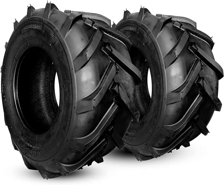

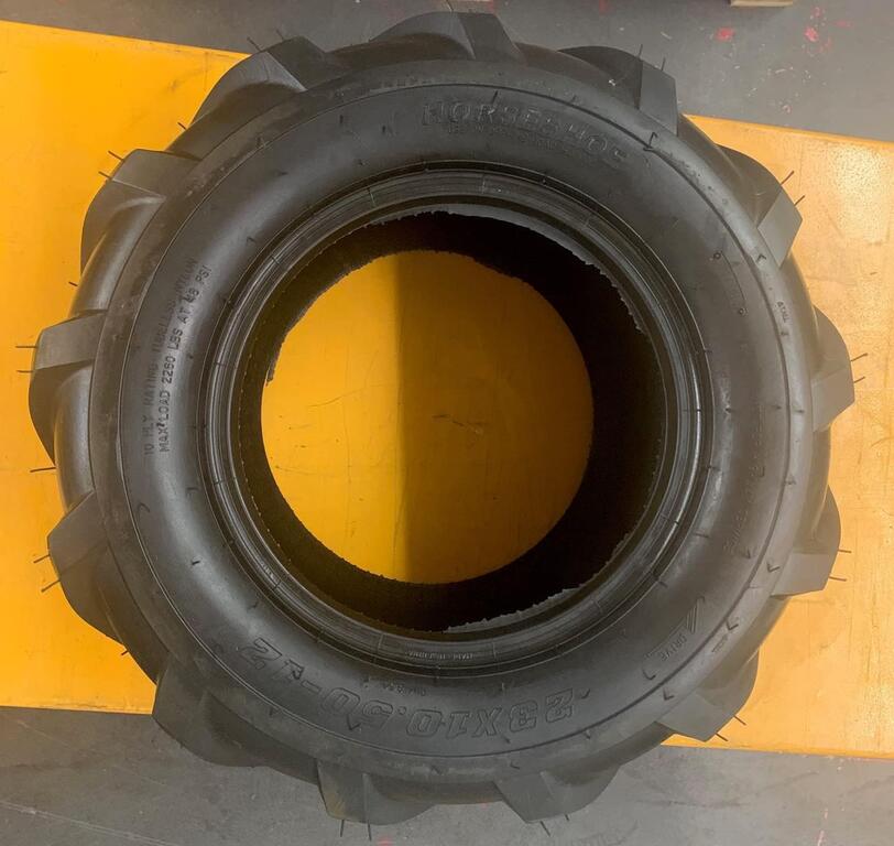

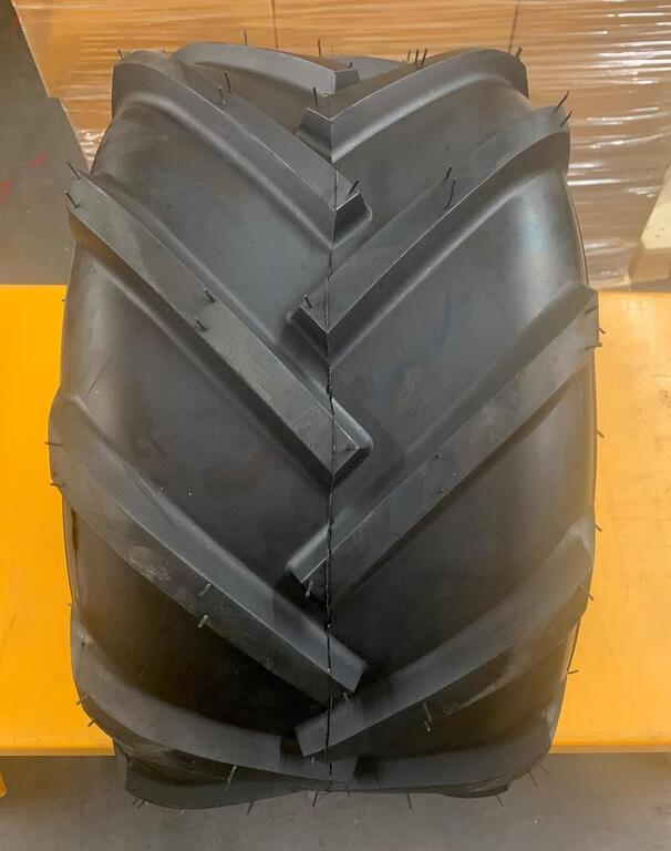

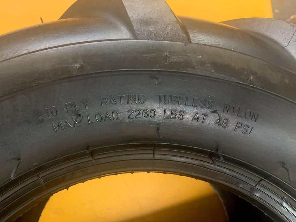

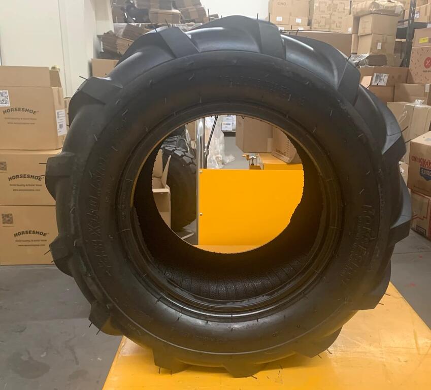

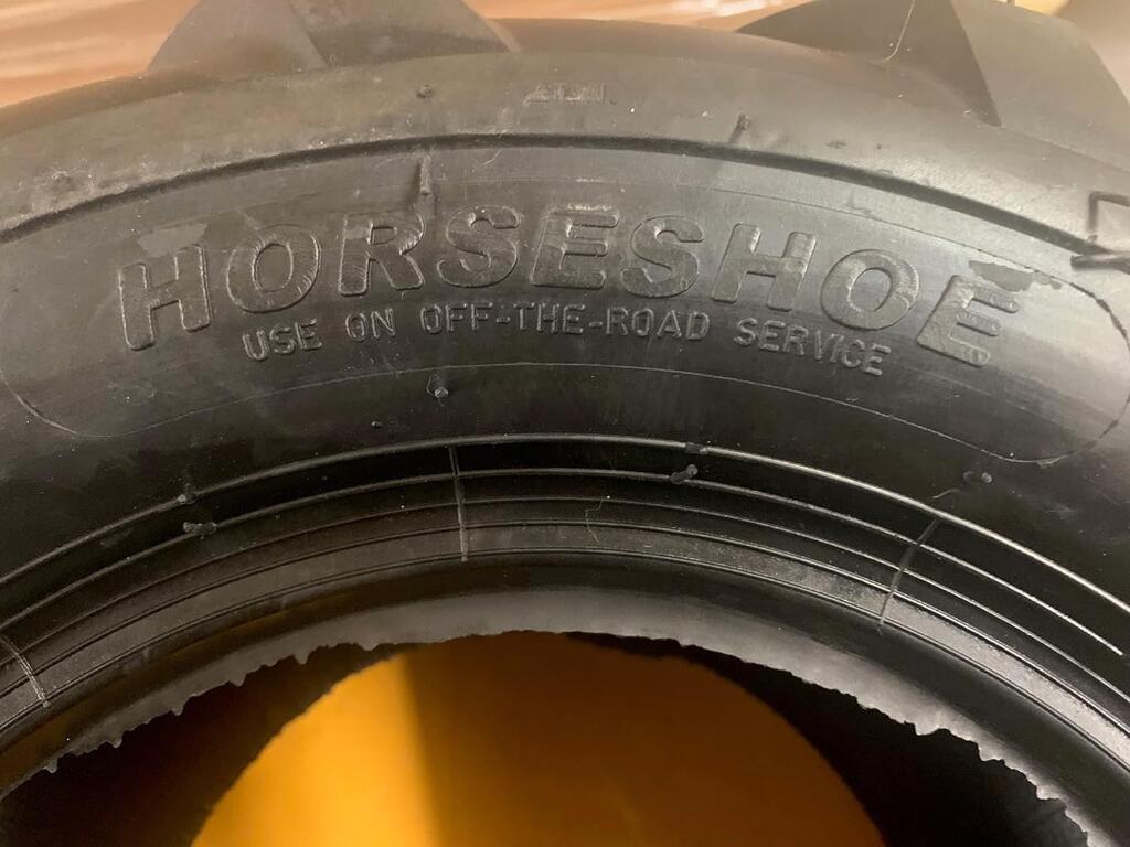

Andy N. 2,271 #1 Posted March 1, 2024 Just curious if anyone has the Horseshoe brand of Ag tires installed on any of their WH's. I have never heard of the Horseshoe brand tires until I saw this on Amazon. A set of 2 23x10.5-12 8 ply is about the same price as 1 Carlisle tire of the same size 23x10.5-12, 4 ply. It's definitely a deal, but is it too good to be true. I have a spare set of 8.5" rims that are sitting around and need some tires and want to go the ag route. I have been happy with the Carlisle's on my 418-A that I installed a few years ago, but it would be great if I can get Horseshoes for my Horse at about 1/2 the price. Pics are from the Amazon post. https://www.amazon.com/HORSESHOE-23x10-50-12-Trencher-Tubeless-23x10-5-12/dp/B09XXGS9JJ/ref=pd_ci_mcx_mh_mcx_views_0?pd_rd_w=vk04k&content-id=amzn1.sym.225b4624-972d-4629-9040-f1bf9923dd95%3Aamzn1.symc.40e6a10e-cbc4-4fa5-81e3-4435ff64d03b&pf_rd_p=225b4624-972d-4629-9040-f1bf9923dd95&pf_rd_r=F260YZXZZF10HA9RTP07&pd_rd_wg=ddkqV&pd_rd_r=febe5d0d-c772-46d3-a2d5-c7d8847037dd&pd_rd_i=B09XXGS9JJ 1 Share this post Link to post Share on other sites
ri702bill 8,961 #2 Posted March 1, 2024 (edited) Do they list either the installed diameter or circumference?? All too many tires are not "true" to size...... Nice to see the lugs cross over center to give a better ride on pavement.... I looked at the ad in the link - these are listed as Nylon tires..... had a set of Nylon snow tires back in the '70's - they wore like iron, BUT, they developed a flat spot from sitting overnight - rode like the Flintstonemobile for a few miles! Being on a tractor may not be an issue.......... AND one of the comments said they were Taller than the ones replaced.... Edited March 1, 2024 by ri702bill 2 Share this post Link to post Share on other sites

kpinnc 13,717 #5 Posted March 1, 2024 The complaint on Horshoes in the review section says they are larger than advertised... Well, that's new. 2 1 3 Share this post Link to post Share on other sites

JoeM 7,923 #7 Posted March 1, 2024 10 Ply to boot. Might be fun mounting on the rims. 1 1 Share this post Link to post Share on other sites

ebinmaine 70,696 #9 Posted March 1, 2024 3 minutes ago, JoeM said: 10 Ply to boot. Might be fun mounting on the rims. I saw that too. I wouldn't even THINK about mounting these without hydraulic machines. 2 Share this post Link to post Share on other sites
JoeM 7,923 #10 Posted March 1, 2024 15 minutes ago, ebinmaine said: I wouldn't even THINK about mounting these without hydraulic machines. I had a set of 6 ply's that I had to leave out in the sun for an afternoon. (to cheap to take them to the tire shop) 1 3 Share this post Link to post Share on other sites
Sparky-(Admin) 22,036 #11 Posted March 1, 2024 I think a softer rubber compound and less ply’s will provide better traction. Personally would never buy a 10 ply for one of my tractors. 5 Share this post Link to post Share on other sites
ebinmaine 70,696 #12 Posted March 2, 2024 1 hour ago, Sparky said: I think a softer rubber compound and less ply’s will provide better traction. Personally would never buy a 10 ply for one of my tractors. I'd agree for most situations. Ours is a little unconventional in that my heavier towing rigs could utilize the extra rigid sidewall and have zero air pressure and fluid filled while maintaining good load capacity. 1 Share this post Link to post Share on other sites
Lee1977 7,036 #13 Posted March 2, 2024 (edited) I had these 6 ply mounted on 8.5" rims at the tire shop, He put the first one he grabbed the small blaster the tire hardly moved. He had to charge up the big blaster to get the tire seated, Edited March 2, 2024 by Lee1977 3 1 Share this post Link to post Share on other sites
Pullstart 64,490 #14 Posted March 2, 2024 23 hours ago, JoeM said: 10 Ply to boot. Might be fun mounting on the rims. 48 psi max? Sounds like the perfect loader tire! 3 Share this post Link to post Share on other sites
