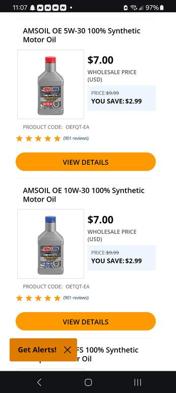

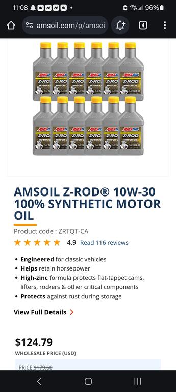

RED-Z06 2,479 #15 Posted March 1, 2024 9 bucks a quart is...up there, still a bit less than Z-Rod though if Zinc is your goal. I still buy a case of Amsoil OE every year for my car, great oil at $7/qt Share this post Link to post Share on other sites
