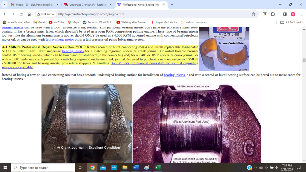

953 nut 57,858 #4 Posted February 29, 2024 3 hours ago, Fly by Nite said: Is there any need for a 321 crankshaft that would be .030 under if it was cleaned up ?? Undersized rods are scarcer than hen's teeth. Rods can be cut for bearing inserts (see below) or the crank can be built up and cut to standard size but either one will be very expensive. 2 1 Share this post Link to post Share on other sites
