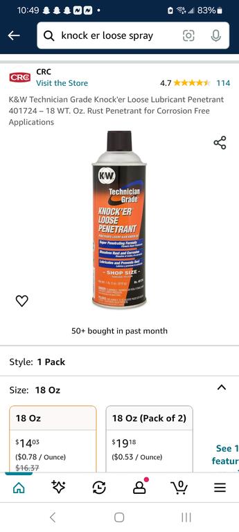

Bill D 2,088 #10 Posted March 18, 2024 I saw two versions online Knock'er Loose plus and the regular version. Which are you using? Share this post Link to post Share on other sites
RED-Z06 2,479 #11 Posted March 18, 2024 6 minutes ago, Bill D said: I saw two versions online Knock'er Loose plus and the regular version. Which are you using? Plus comes out below freezing, only difference. I use this Share this post Link to post Share on other sites
Bill D 2,088 #12 Posted March 18, 2024 6 minutes ago, RED-Z06 said: Plus comes out below freezing, only difference. I use this Thanks! Share this post Link to post Share on other sites
peter lena 9,087 #13 Posted March 18, 2024 @ RED Z06 , using the technical grade , 20 oz. cans , thats what I got on amazon , weeks back , did a double take on that size , and the 10 $ price , realize that anything thats on the net , can quickly change pricing due to demand . also found it to be a great , metal seam creeper , always looking at a change , for effect look over . pete Share this post Link to post Share on other sites
