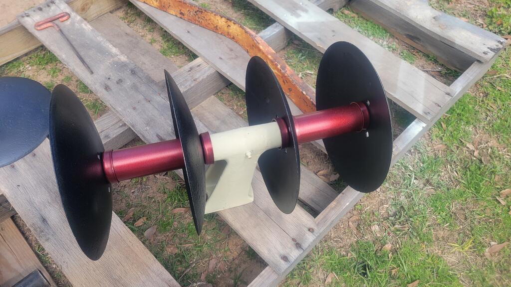

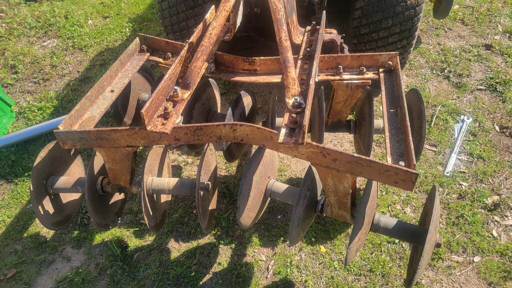

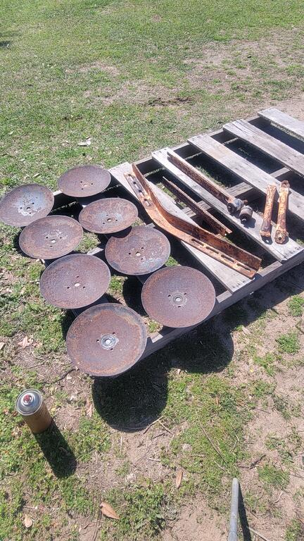

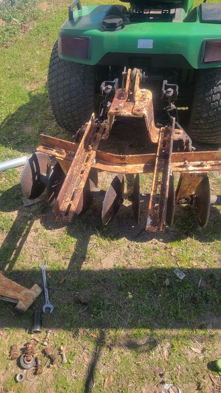

RED-Z06 2,479 #1 Posted February 25, 2024 Ive used it for about an hour, works great but looked rough, and i want to preserve it. After going through it, the hardware is in good shape, the gang bolts aren't worn but they do all have a slight bend to them...nothing too concerning, these are fairly expensive to replace so ill use them. Discs have no wear but a few spots where the edges are eroded from sitting. Its going down to a bare frame, nothing left strip and repaint, clean out the old grease and feed it new grease at the gangs. Doing the rear 2 first and the rear frame sections, then the front 2 and hitch section. 7 Share this post Link to post Share on other sites

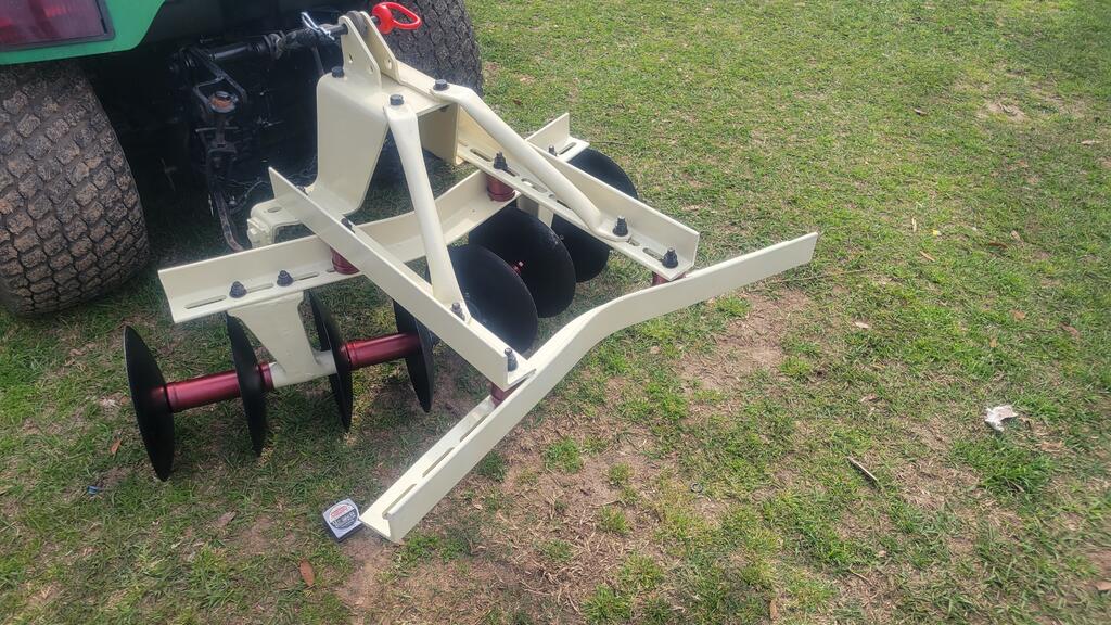

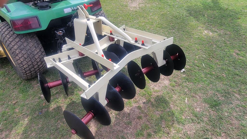

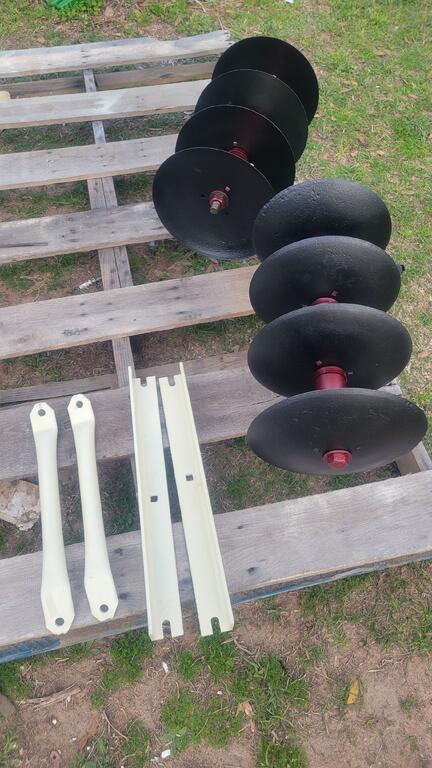

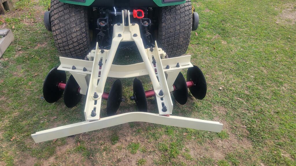

RED-Z06 2,479 #5 Posted February 26, 2024 One gang is back assembled again, should have the 2nd done shortly, as well as the 2 uprights and the 2 rear connector arms. The rear crossmember I still have to strip, clean, prime and paint..but it should be done today. That will wrap up the rear portion. 3 4 Share this post Link to post Share on other sites
RED-Z06 2,479 #6 Posted February 28, 2024 New decals should arrive soon, but its back in business. I should flip the pins to the inside and put it on the 702🤣🤣 7 Share this post Link to post Share on other sites

RED-Z06 2,479 #8 Posted February 28, 2024 8 minutes ago, kpinnc said: It would look nice on there, but your arm and back may not like you very much... My back already hates me🤣🤣. I stripped every square inch of this thing with a 4" cup wire wheel on a grinder, abrasive discs, and a draw sander, a good 8hrs standing at a vise holding some kind of power tool. 1 1 Share this post Link to post Share on other sites

RED-Z06 2,479 #10 Posted February 28, 2024 4 minutes ago, ebinmaine said: Niiiiice work! You use an E tank at all? I didn't. The hardware, discs, and cast iron gang mounts spent a day in the heated ultrasonic but the grease was so hard that it really didnt do alot. 1 Share this post Link to post Share on other sites
