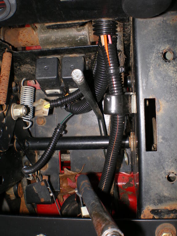

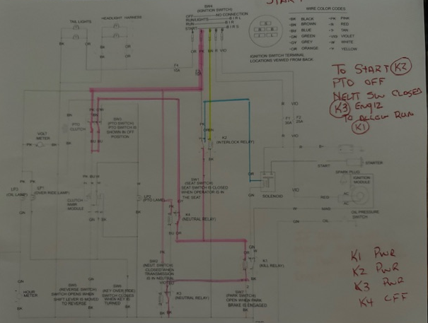

JoeM 7,885 #1 Posted February 23, 2024 I have a 2004 315-8 in the shop, cleaning up, repairing the wiring / electrical issues and service. What an amazing difference in this machine as compared to ones a few years older. The bones are the same, angle frame, HD 8 speed, steering an so on. But boy has the safety safari dipped their self into this one. Start out with a magnetic neutral switch. Functions if the gear lever is moved from neutral with the park brake on it shuts off. (I will say that I have drove a gear drive with the brake on myself) might be ok. Of course the standard it won't crank with the seat switch off. PTO if on she no crank. As a surprise, no clutch switch. And then comes a very complex no mow in reverse system. I figure the complexity of this is to incorporate warning lights etc. Surly makes it more of a process to run and work on the thing. Wires and relay everywhere! Had to make a map. 3 Share this post Link to post Share on other sites
peter lena 8,970 #2 Posted February 23, 2024 @Joe M love the wire protection / rerouting enhancement , thats what you want to do ! that top cross shot of shifter area , is a great time to aerosol lubricate , related cross shaft movement points , very often refer to those , and idler bearing failures . realize its not starting point , buts its right there . BTW my experimental , shifter boot , issues are gone , replace my boots , with lightly greasing the LOWER INSIDE OF THE BOOT , for easier movement trying to slide over the irregularities on top of gear box, prevents pulling tearing boot , also a wide TYE WRAP on top of boot on metal shaft to hold it in place , used a razor blade to cut it off , and silicone grease the shaft for a smooth fit , left about a 1/4" gap to top of boot , have this on 3 horses , working good , just an idea thats working . stay at it , pete 1 Share this post Link to post Share on other sites

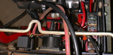

JoeM 7,885 #6 Posted February 23, 2024 A little update. Found main 30A fuse corroded off and the ignition switch bad. Fixed those items and it fired right up. I have few more things to repair but it is looking okay as of now. i did realize there is no headlight switch. They come on in the run position with the ignition switch. If it was mine I would install a dedicated on off switch. 2 Share this post Link to post Share on other sites
