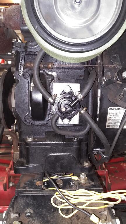

@BillD made this one on his Kohler. Far better than rebuilding one IMO, and these are reliable pulse setups. There are kits on Ebay for similar setup, but they are $85! Just seach "Kohler fuel pump mod".
But Bill's looks better...
Thanks for the compliment.  I have three of these in service now.  The plate is made of 1/4" stainless steel.  All are working well.

Bill D
On 2/22/2024 at 9:10 PM, WHX?? said:
Excuse me kp @BillD has got me confused all those hoses running around... did I mention I'm a purist and a orginal freak? :lol:
I needed a fuel pump for my Dad's tractor.  Changing to an impulse pump was the most cost effective option.
