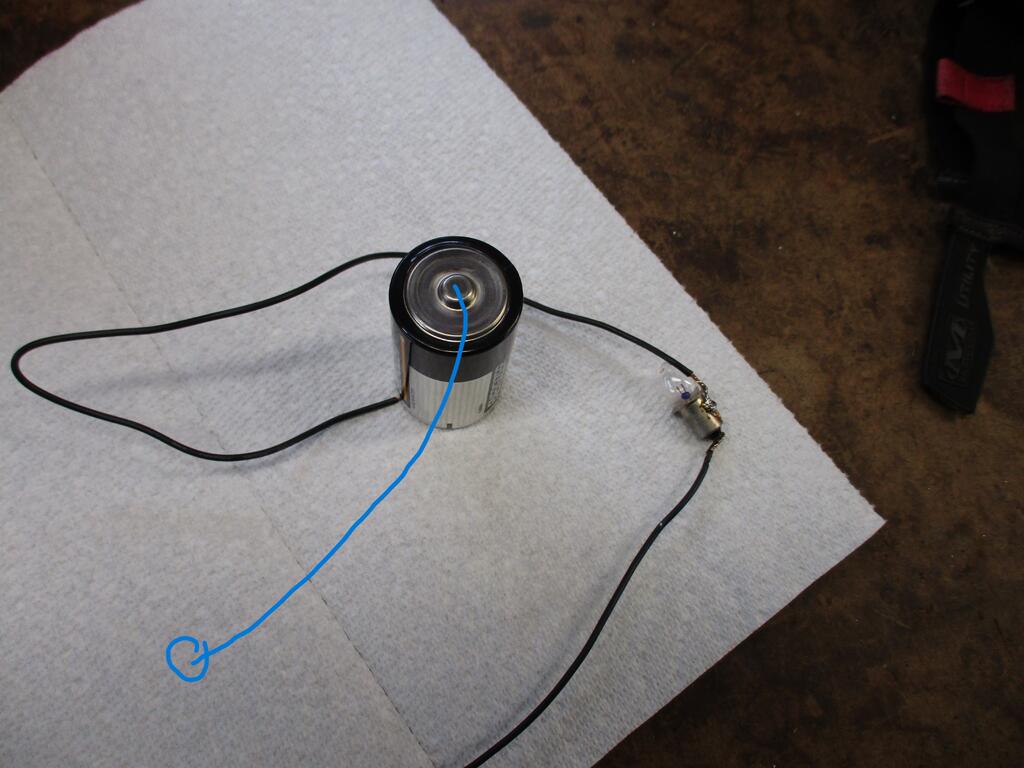

pfrederi 18,180 #11 Posted February 22, 2024 (edited) Have you tested the components. Coils are easier to find if that is the problem The tester is a couple of D cell batteries and old school flashlight bulb Edited February 22, 2024 by pfrederi 1 1 Share this post Link to post Share on other sites
Chris-laf 3 #12 Posted February 22, 2024 Haven't tested it quite yet what how would I need to run the batteries and flashlight bulb in order to check Share this post Link to post Share on other sites
953 nut 56,742 #13 Posted February 22, 2024 12 hours ago, Chris-laf said: What would be necessary to switch to points I'm doing my best to learn just recently got into tractors more specifically wheel horses anything helps thank you First you should test the system you have to confirm it is in need of replacement as @pfrederi suggested. Follow the steps outlined in the attached information he gave you. You won't know what is good or bad without TESTING IT. If you need to replace the ignition system you would need an internally resisted ignition coil, ignition points, points push rod and a condenser. The post I attached to reply #5 covers the process step by step, take a couple of minutes and read it. 1 Share this post Link to post Share on other sites
pfrederi 18,180 #14 Posted February 22, 2024 Tape a wire (blueline) to the batt + use the other end of it and the end of the black wire from the bulb as probes for the tests. 1 Share this post Link to post Share on other sites

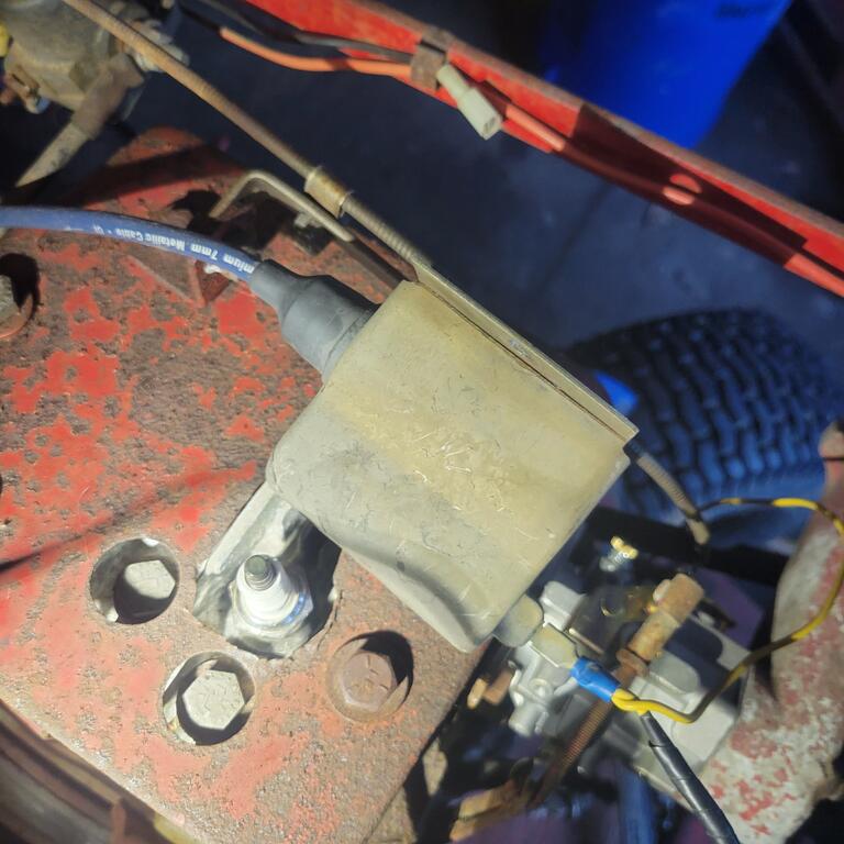

kpinnc 13,105 #15 Posted February 22, 2024 (edited) I have that same breakerless system on my Bronco 14. The only time I had issues with it were when the very tiny tab on the bottom of the coil got corroded, weakening the contact from the trigger. A brass brush cleaned it up, and some CRC (or contact grease) kept it from coming back. That was several years ago. That tiny trigger contact on the bottom of the coil seems to be the weak point on these things. Make sure it's clean and the wire terminal is crimped so it fits snug. Good luck! Edited February 22, 2024 by kpinnc Share this post Link to post Share on other sites
Chris-laf 3 #16 Posted February 22, 2024 6 hours ago, pfrederi said: Tape a wire (blueline) to the batt + use the other end of it and the end of the black wire from the bulb as probes for the tests. Turn the engine over after connecting the blue wire and black wire to the coild correct and hope for the light to turn on? Share this post Link to post Share on other sites
pfrederi 18,180 #17 Posted February 22, 2024 (edited) Please read the directions this is done with everything disconnected and off the engine. You can damage the trigger if you do it incorrectly Edited February 22, 2024 by pfrederi 1 Share this post Link to post Share on other sites
