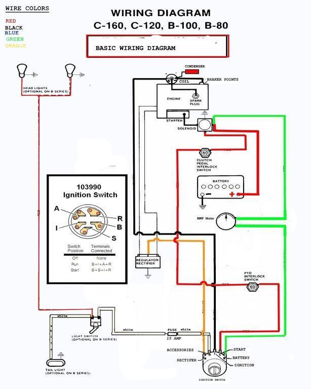

ssoles 0 #1 Posted February 20, 2024 New owner. Trying to find the location of fuses and fuse block? Are they visible. I have looked at the wiring diagram but do not see them visibly on the tractor. Any help would be appreciated. Thanks. Share this post Link to post Share on other sites
WHX?? 49,919 #2 Posted February 20, 2024 Follow the wire from the amp meter back to the battery. If you don't find it good chance a PO removed it. Not uncommon for a PO to hack up wiring trying to find an electrical problem. Hopefully a member will chime in with an unmolested 165. 1 Share this post Link to post Share on other sites

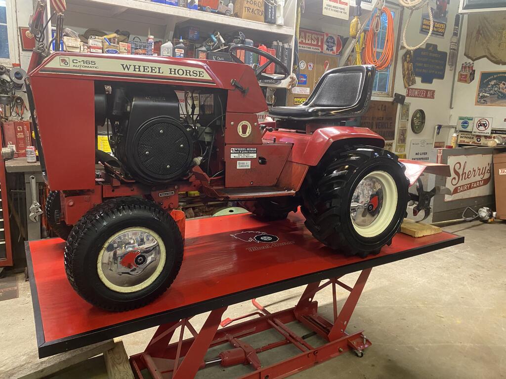

ebinmaine 69,710 #5 Posted February 20, 2024 Do you have pics of the tractor? A 1978 should be a C161. Not a 165. 161 is an older style red hood. 165 is the wider black hood. Might be important to clarify just in case the wiring is different. Share this post Link to post Share on other sites
c-series don 9,263 #6 Posted February 20, 2024 I have an unmolested C-165 automatic, I can check it out tomorrow and take some pictures of the wiring harness. 2 2 Share this post Link to post Share on other sites
squonk 41,938 #7 Posted February 20, 2024 (edited) As Jim @WHX?? said (can't believe I'm saying this and agreeing with him!) Follow the wire from the ammeter. Usually it goes to the solenoid and is on the same terminal as the positive battery cable is on. My C145 had a fuse holder on that wire. This pic is for reference only. It is not from a tractor The fat red wire is from the battery. The small red wire with the tape is going to the the key switch ect. A fuse holder on your tractor should be on this wire Or on this diagram Follow the green wire from the solenoid to the ammeter. fuse should be somewhere on there. Edited February 20, 2024 by squonk 1 1 Share this post Link to post Share on other sites
