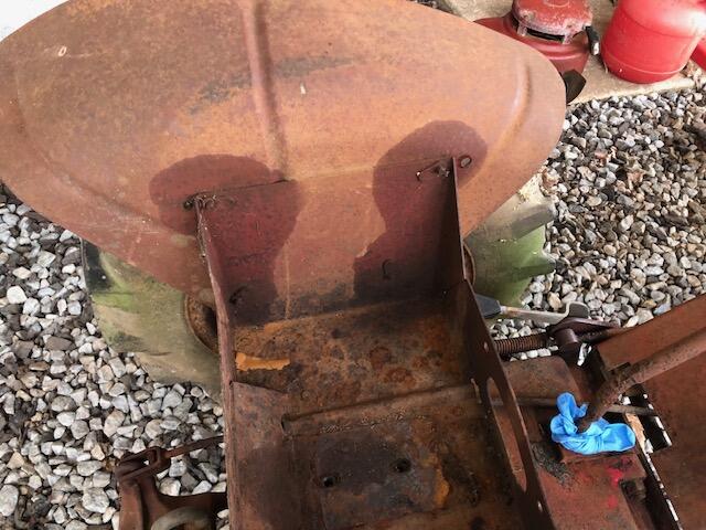

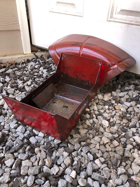

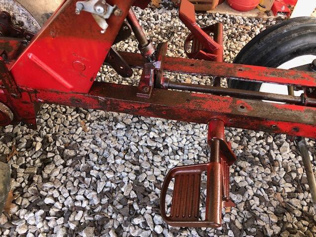

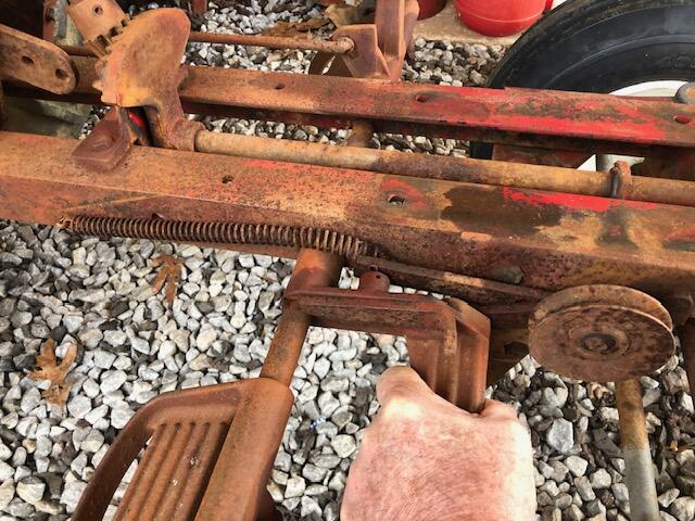

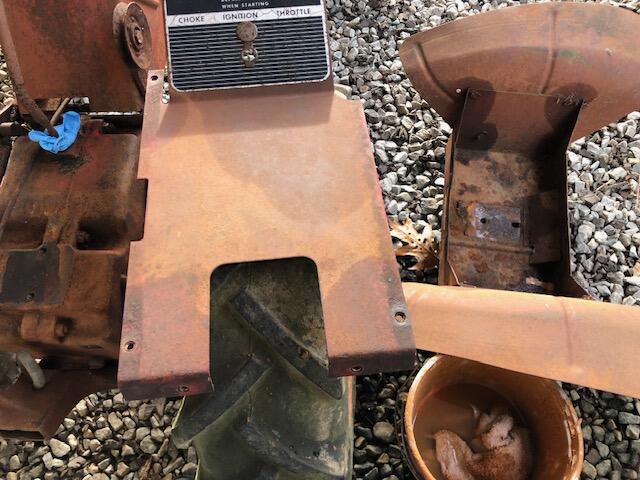

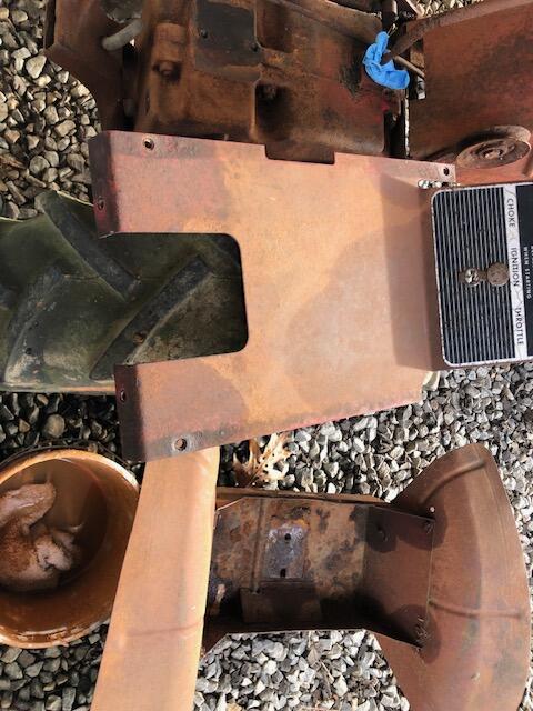

I have gotten around to tackling the 704 I rescued a while back. It was totally rusted with front tires rotted on rims. Using Evapo Rust, Kroil and a lot of patience I have gotten almost every bolt removed with no broken bolts.Soaked the frozen throttle cable in evapo rust and got it working. Also got the stuck exhaust valve free as well as carb choke butterfly. Making progress on the engine but not sure what to do with the metal on the tractor. Tried some wet sand with 1000 grit and it just keeps coming up rusty, no paint hardly left. Not really interested in a full on sand and paint restoration but not much for patina left either. Just will be a tractor for kids to play on, no worker or show tractor. Any suggestions what to do?

If you can at least knock the loose rust off, Rust-Oleum red oxide primer will stop the rust from getting worse. I've used it on rusty stuff as a primer coat down here in humidty central with no break through rust on some tractors over 20 years ago.

Given your stated intended use, that's what i'd do...
I have used muriatic acid to get down to bare steel.  Don't do this on concrete or your lawn and stay up-wind.   :jaw:   I used a garden sprayer to wet down all surfaces then flushed it off with water. It will flash rust but that is easily removed with steel wool.

Ospho rust converter, red oxide primer then paint. Or just leave it primed. The Ospho turns the rust a black color like primer finish.
If you like petina, matte clear rustoleum enamel and spray it right on the current surfaces.

Just clean it up, knock the heavy rust off and put it all back together. Nothing wrong with an old tractor looking like an old tractor.
If you're keeping it inside, it will take a 1000 years for the rust to do anything more. Spray it every once in a while with WD40 and let the kids enjoy it.

@Sailman  https://www.google.com/search?q=mineral+oil+for+car+finish&sca_esv=46579d9512b829aa&rlz=1C1CHBF_enUS866US866&sxsrf=ACQVn0-e5JrijxvEo1A-y  , think with what you have left , is without a doubt , a mineral oil feed down , it would retain , that base shade of " color " with a darker oiled / rust free detail , would shed moisture like a duck , and be very easy  to touch up . having done a number of recoveries , the first thing I do is to feed the " paint " or what's left of it . an aerosol  pump spray bottle , would let you get to every area , if you have a dry covered  shed , even better , its that metal soak /  adhesion  thats your base line . think it would look period correct , in a oiled patina . Pete

Putting oil products on the tins just attracts dirt and Poplar Tree fuzzies. If you want to "shine it up" Brush this on. Dries to a nice shine and stuff doesn't stick to it.

SHOCKED I TELL YA!.......So I had a lot of good suggestions from folks on this thread and started with an overnight Lowes metal strip on one small piece thinking I would repaint. Cleaned off the residue and primed it red but just didn't seem to be what I wanted.....I felt the "survivor" needed to retain some of that flavor but the rust was just SO BAD ( see pictures above). After some messing around I discovered using the Lowes strip for just a couple hours removed much of the rust and voila! There was actually still some red underneath all that rust. Have to scrub the acid off with water and stiff brush and some sanding with 1000 grit. She still looked pretty dull and rusty after the treatment. I wanted the "patina" to stand out so I used some Penetrol on a test piece. Wow! just what I was looking for. Respect for the original finish yet giving the old girl a special shine and stopping any further rust. Probably not everyone's cup of tea but I am pleased with the results.
